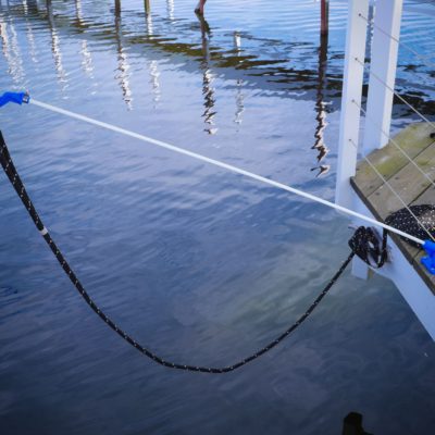

Here is a product that you all might find interesting. It’s called Line Caddy from a company by the same name.
Here is an example of one of their products. They also have a post mounted design.
I use several of them. One near the bow mounted down on the dock. We can hang a bow line on it when we back out so that it’s at the right height (not laying on the dock out of reach) when we come back in. Also have a post mounted one at the stern so I can reach it while still at the wheel / controls as we come in.
