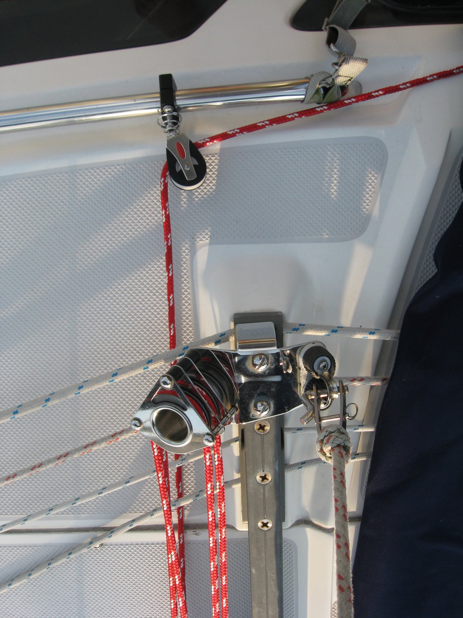

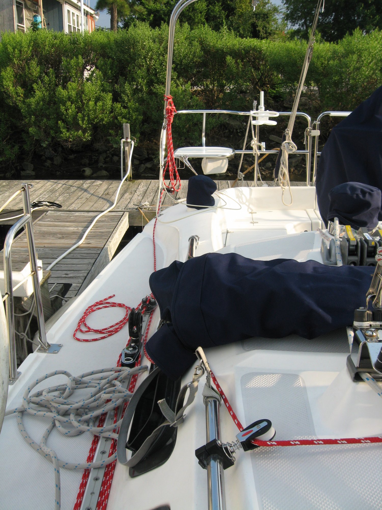

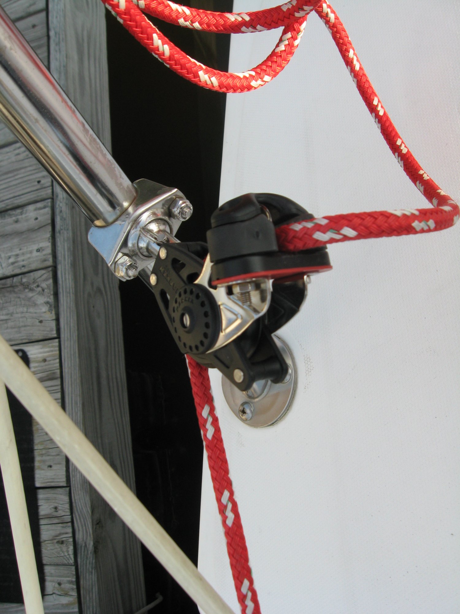

Consider moving the traveler lines back behind the wheel with a block/cleat to the stern pulpit. Even in a heavy puff you will have complete control. I ran a trot line from my forward pilings to the dock to keep the boat mostly centered when coming in alone in adverse current. IMG_2808.JPGIMG_2809.JPG
