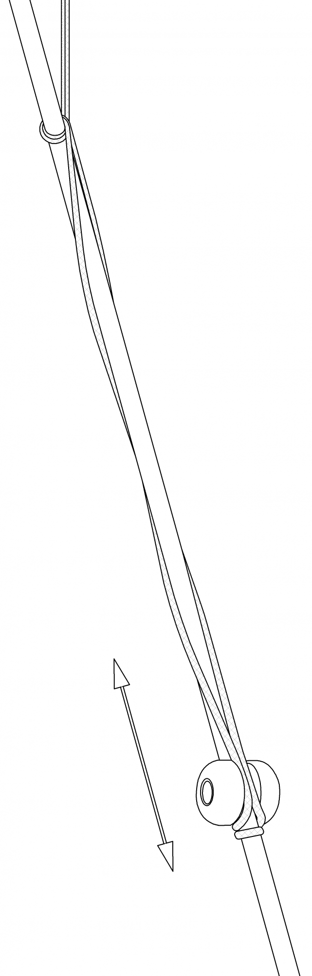

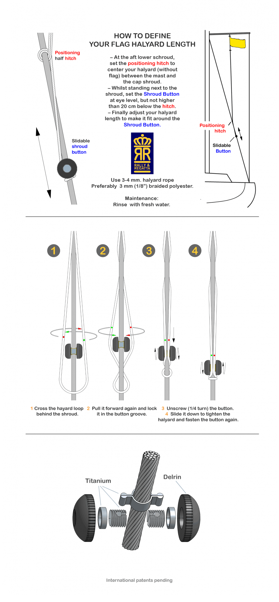

Well done Jacktar, chapeau! I am simply not handy enough to do that. Recently bought a 'shroud button' at the local chandler. Also a kind of clever fitting to fasten a flag halyard ( shroudbutton.rallyandregatta.com ) But it did cost 15 euros. So way more than yours.

Comet 30 feet Rotterdam
Yes indeed. The 'button' I purchased can be moved easily along the shroud, but at the same time can be fixed in any desired position, and it stays firm even in very strong winds. Not cheap but a great fitting. Maybe you will design your own clever version. Would be great. Look forward! Regards, Mats.
PS. I copied this manual file from the manufacturer's website. Shroud button Better than a shroud cleat.
