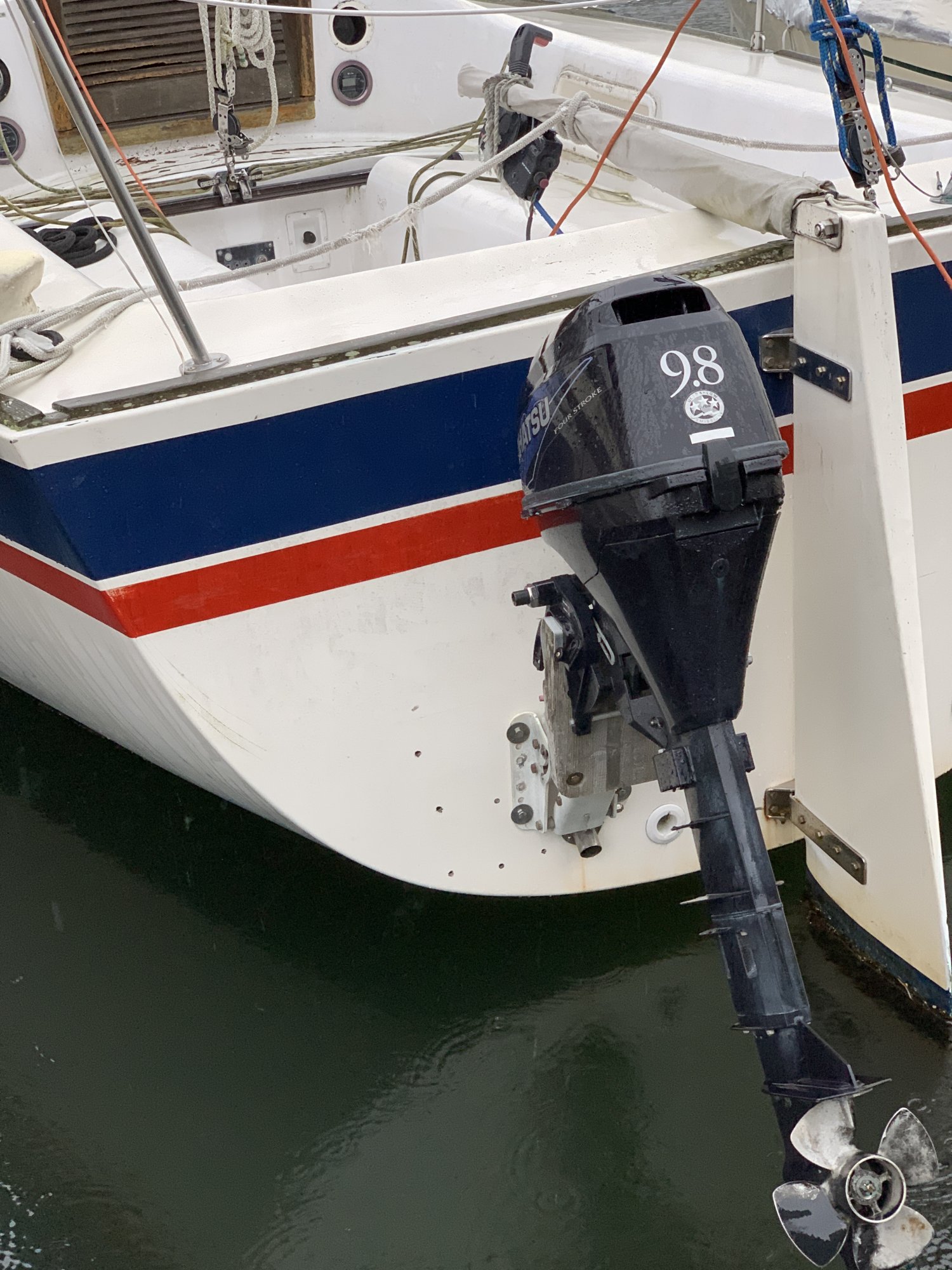

this appears to be about a 27 foot sailboat. I am not sure why he left the outboard on all winter
Aug 7, 2023
243
catalina catalina 320 norwalk
Or why they drilled at least 6 extra holes (not filled?) in the transom.

Yes I saw that. Perhaps getting it in the right position required a little trial and error. Seems they are having fun and not worrying about much!
23,923
That may be his auxiliary. You can see the depth of the motor when down. Not very deep. Going through any choppy seaway would present a problem.

The boat in that picture has a rather low freeboard which makes it feasible to operate. I'm guessing it's a 25' as the C27 has a higher freeboard if I remember correctly. My 25' has a higher freeboard than this boat. I suspect that there was a different mount on this boat. There's a wide hole pattern and a narrower one. The holes in the transom look like they were for a wider pattern but the mount you see is narrower.

The boat in that picture has a rather low freeboard which makes it feasible to operate. My 25' has a higher freeboard than this boat. I suspect that there was a different mount on this boat. There's a wide hole pattern and a narrower one. The holes in the transom look like they were for a wider pattern but the mount you see is narrower.

A guy two boats away from me has a 9.9 hp on his boat . it seems about the same size as mine.
Is that the picture of the ~27 foot boat in post 27? That’s not really “about the same size” as a Catalina 32 from a propulsion standpoint. A Catalina 27 displaces 6700 pounds, and the boat in the picture appears to be a lighter racer cruiser design than that. I’m guessing it’s not more than 6000 pounds. A Catalina 320 displaces 11,300 pounds, plus a lot more tankage and storage capacity than the 27. To a reasonable approximation that’s double the weight, and you need to move that much water out of the way every time you move a boatlength; not like a car that you just need to get rolling.

Your dock neighbors boat, in the photo, is more likely a 25' boat or less going by that transom hung rudder.
tfox2069 posted he had a 9.9hp on his Catalina 27.
Note the displacement for a Catalina 27 is listed as 6,300 lbs. Your Catalina 320 is close to double the displacement at 11,250 lbs.
