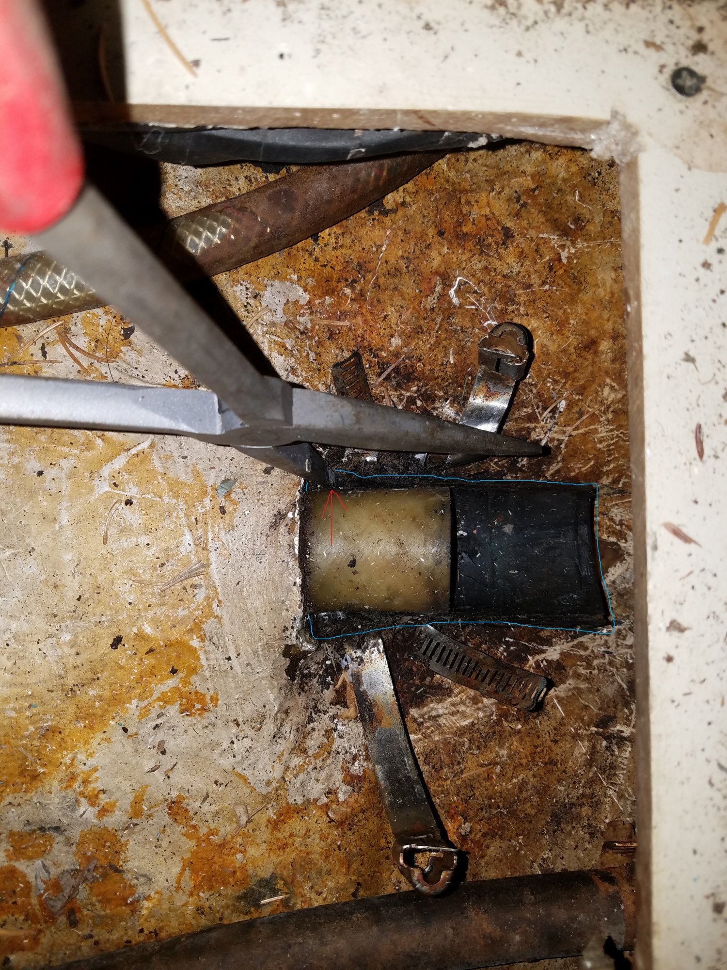

Shaft log hose stuck
Jan 7, 2011
5,858
Oday 322 East Chicago, IN
Yeah, if the clamps are still on and tight, you have to cut them off. Can you get a vibrating cutter blade in there and cut the gear off the clamp maybe?
How the heck did someone get the clamps on in the first place?
And how are you going to put new ones back on?
on edit...
After looking closer at your photo, I guess the clamps are cut, but stuck under the hose.
Can you pull those out from under the hose ? they are probably adding to the friction on the hose. Pull them out from the side if you can, from the gear end;-)
Drilling a hole or 2 in the hose, and running some stout wire or strong rope through the holes may give you something to pull with. I did the same thing trying to pull some sanitation hose out this summer. Get as far back from the end of the hose as you can to keep it from pulling through.
Toluene may soften/ dissolve rubber, but I am not sure if there are additives in the hose that make it more chemical resistant. Plus it is some nasty stuff, you probably don’t want to mess with it.
Good luck, this must be frustrating as all get out...but be patient, you will get it eventually...just don’t make it worse!

Hole saw slightly larger than hose OD might help. Looks like you have to remove some fiberglass under the hose anyway. Hose clamps will grab saw so hold tight and proceed slowly.

That hose is wire reinforced. See if you can get a grip on the wire that reinforces the hose and try to pull it out with vice grips. Then get some wood carving tools, you can buy them as a set and start carving the rubber away. The tools come in various shapes including curved so you can work away at the hose getting it out in pieces without damaging anything.

The hose on my Sabre was like that also & that's how I ended up getting the balance of it off. Slow & methodical with the chisels. Cleaned the log up with plumbers Emery cloth/sandpaper. It was almost like the hose was put on the shaft log right after being glassed into place. Boats, boats, boats. What you going to do..

I finally got it off and figured I'd give some closure to the problem. I'm not sure why I didn't try this earlier but if you look in the picture the remnants of the hose are outlined in blue. I stuck a long set of needle nose pliers way in the back (red arrow) and kept prying it forward alternating sides, while pulling on the front of it with a pair of vice grips. Only took a few minutes and it all finally came out!!
Thanks all for the help
