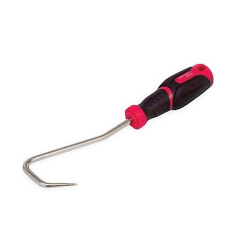

24,787
Just guessing here. Can you remove the clamp? Might give you a bit of room to wiggle.
Your description makes me think the hose has swollen. Perhaps a hose puller tool could help.
The clamps are in there just as tight, couldn't get them to budge either. I might try the vice grips and come along method next.
