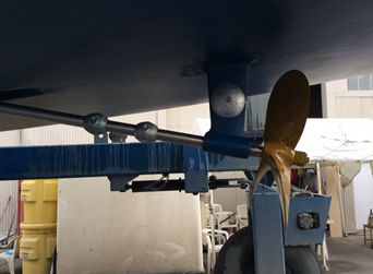

Hell all,
Anyone know what the original strut and shaft material for the legend series was? Just hauled out and definitely need some antfoul love.

Definitely painting it. I got some velox plus for it. If the shaft and strut are aluminum I will need to epoxy primer.

I would be very surprised if shaft was solid aluminum vs. solid stainless steel is stronger and aluminum does not hold up in salt water. Please let the forum know if you find out otherwise. Thanks.
