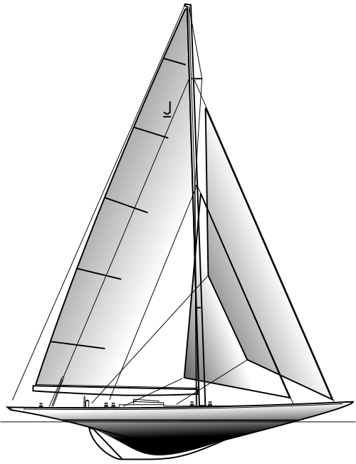

According to sailboatdata.com the Hunter 28.5 sports a B&R rig. As such it has aggressively swept back double spreaders and the diagonal shrouds. That mast would likely stand without a backstay. It is engineered and I wouldn’t make substantial changes to it.
This is what Duck AI had to say about the rig:
A B&R rig is a modern sailboat rig developed by Bergström & Ridder. Its defining features are:
  • Swept-back spreaders
  • Diagonal stays supporting the mast
  • Often twin aft lower shrouds or a “diamond” arrangement
  • Usually no backstay, allowing a large roachy mainsail
  • A mast that is commonly pre-bent and supported by the rig’s geometry
The swept spreaders and diagonals create strong fore-and-aft support, while the absence of a backstay gives more room for the mainsail and can improve performance upwind. B&R rigs are common on cruising boats such as some Hunter and Scandinavian designs.
The trade-offs are that they can be less straightforward to tune, the spreaders limit how far the boom can swing, and the rig may require careful attention to mast prebend.
For tuning I think Selden has a guide. But a Google search of Bergstrom & Ridder should reveal a lot about it.
