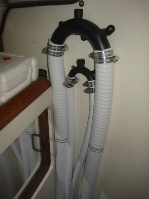

Your old Mansfield wouldn't fill up if there were a vented loop in the intake--something that's needed with all manual toilets that are at or below waterline, so will also need to be there when the new Jabsco goes in.
Installation is the same for all manual toilets:
All vented loops need to be at least 6-8" above waterline AT MAX HEEL, not just when the boat is at rest...which on most sailboats puts it 2-3 FEET above the bowl (see attached photo). The intake vented loop should be installed between the pump and the bowl (see the drawing in Figure 1 on page 3 in the Jabsco owners manual Jabsco Manual Twist & Lock owners manual) which will require replacing the short piece of hose that toilet mfrs use to connect the pump to the bowl with 2 pieces of hose long enough to connect to the loop.
This photo shows both a discharge vented loop, only needed if toilet discharges directly overboard, and an intake vented loop (the smaller one tucked in under it).
