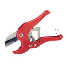

I use something like this for cutting hose - makes nice clean cuts. $14 at home depot.
Jul 7, 2004
8,542
Hunter 30T Cheney, KS
I have one of those too. I only cut plastic hose and pipe with it. You can get spare blades.
Jan 7, 2014
464
Beneteau 45F5 51551 Port Jefferson
I think it's better to use snips or a wire cutter to finish off the spiral.

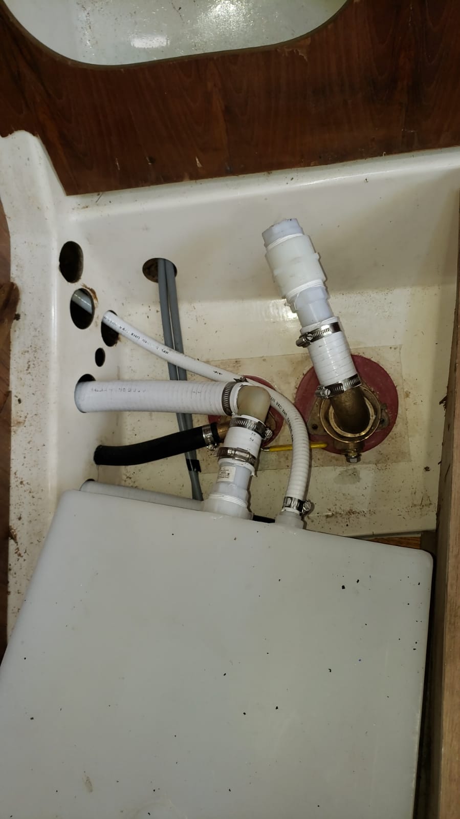

Something to consider. I sail only on the Chesapeake Bay so I removed all the hoses, etc for dumping waste. Left a much simpler install and saved money. I needed to replace the inlet valve due to a broken handle, so I did both. Mistake to do the outlet since I later decided not to use it.
