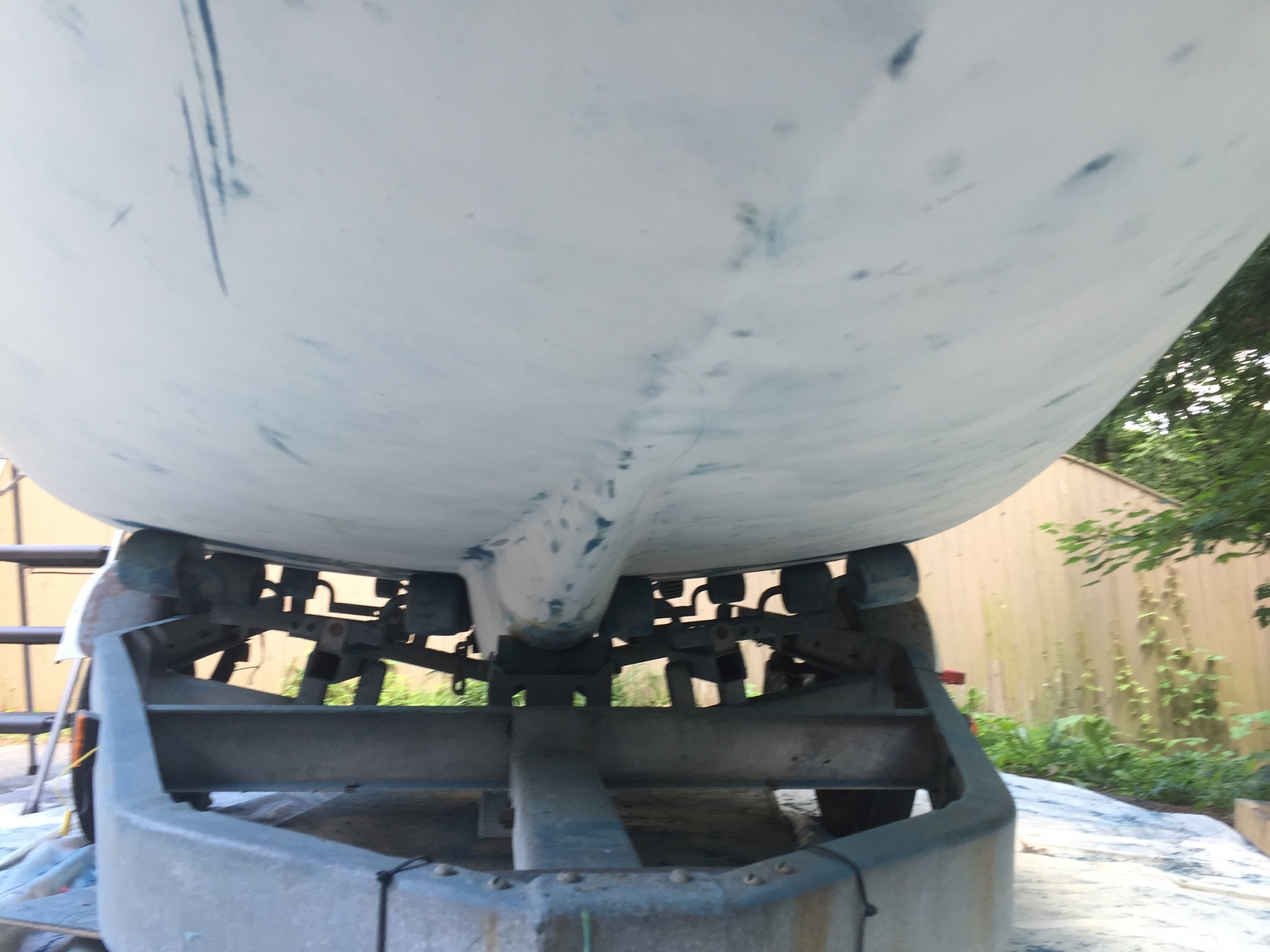

I sanded off all I could while the boat was still on the trailer. Scraping first was the way to go. Still a lot of work but it was quicker than just sanding.

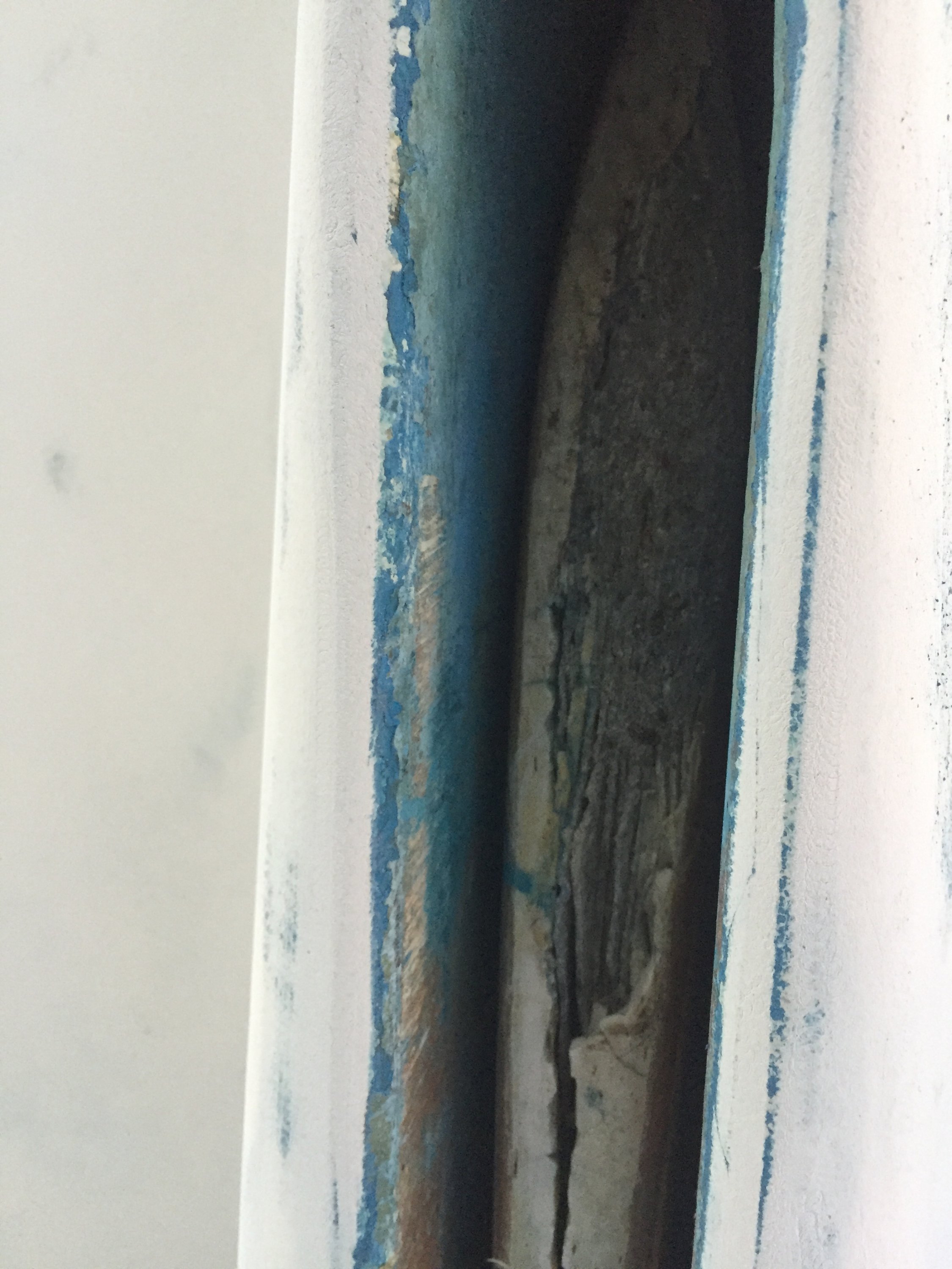

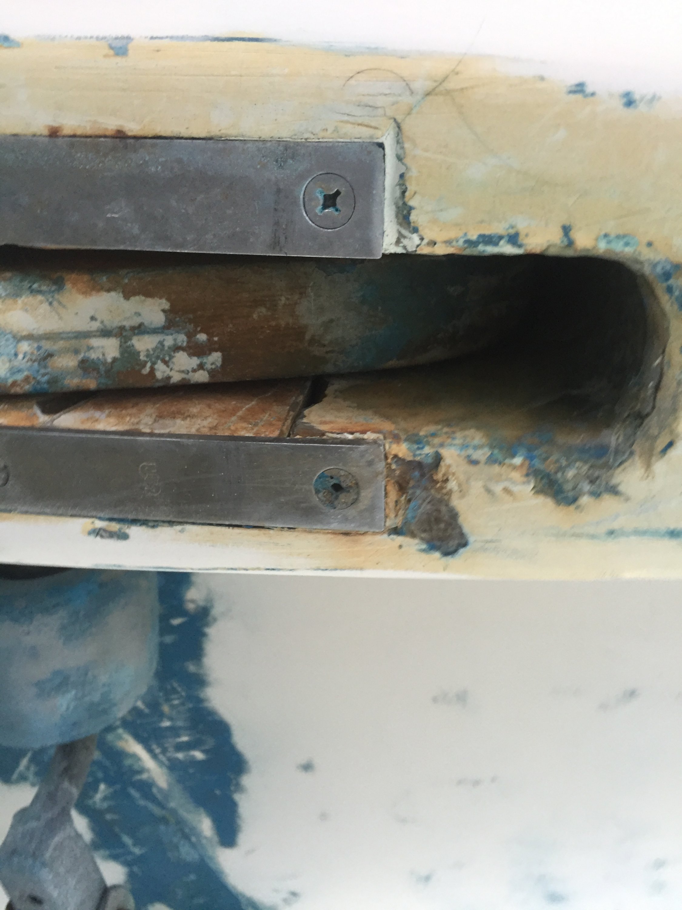

I found a couple of areas in need of fixing however. There is a decent size gouge of fiberglass out of the keel just forward of the centerboard trunk. I assume I can fill this with resin.

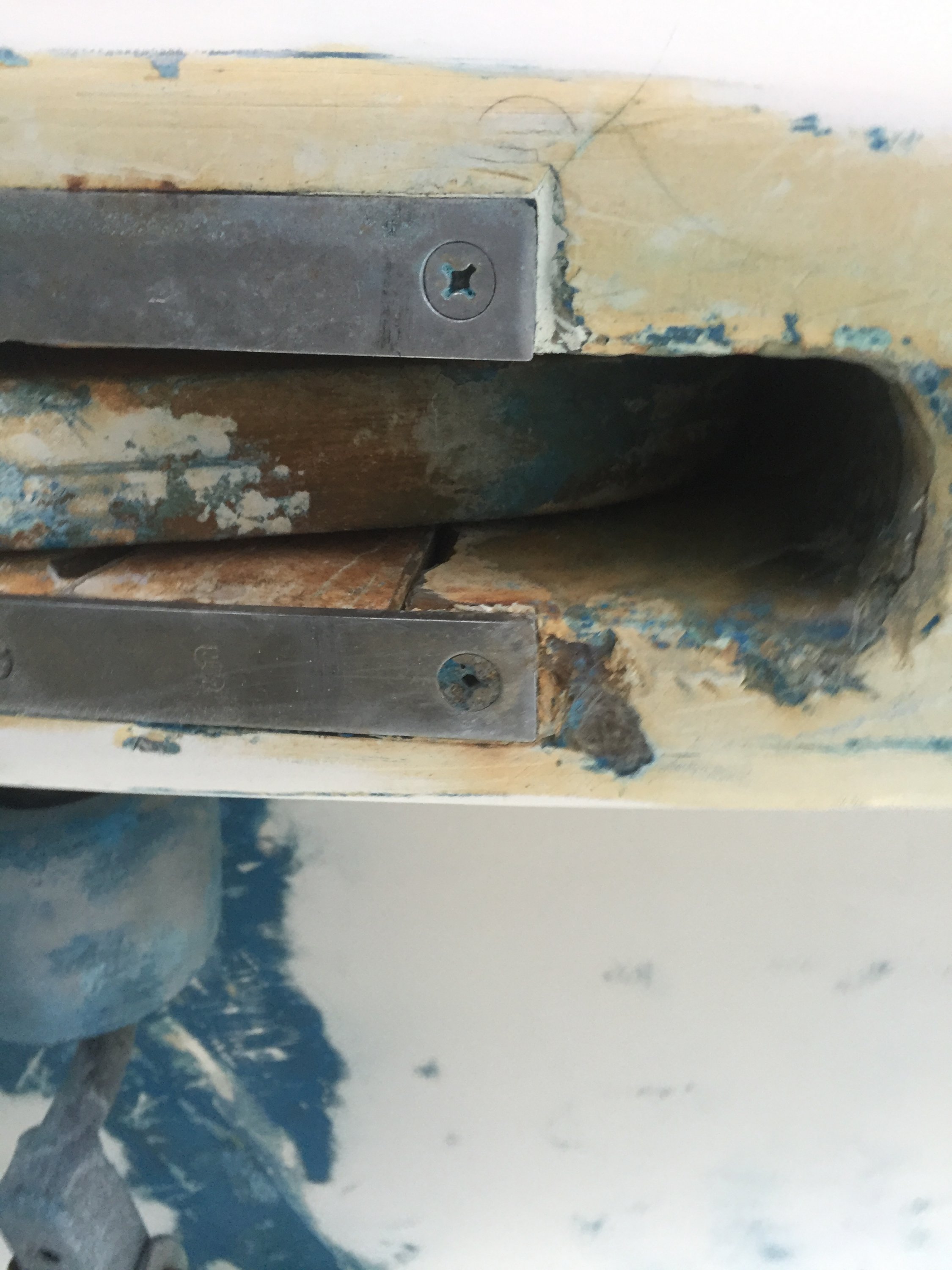

The more concerning problem is the centerboard itself. It is split. ( see pic). I assume it happened from the board dropping and hitting the trailer axel while going down the road. Not exactly what to do here. Fill it with resin? Lay glass over it? A new one is 600 so I would love to fix it.

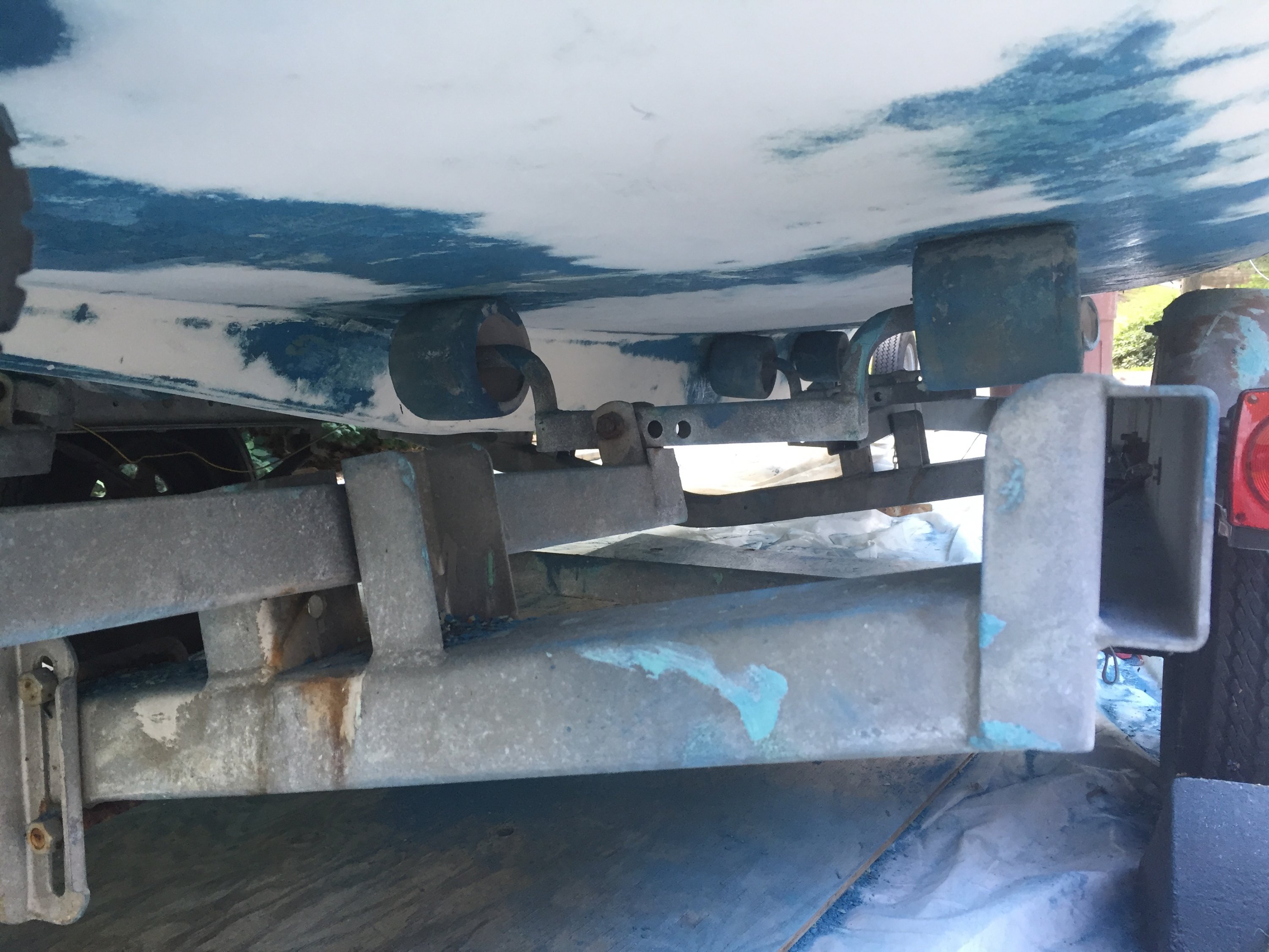

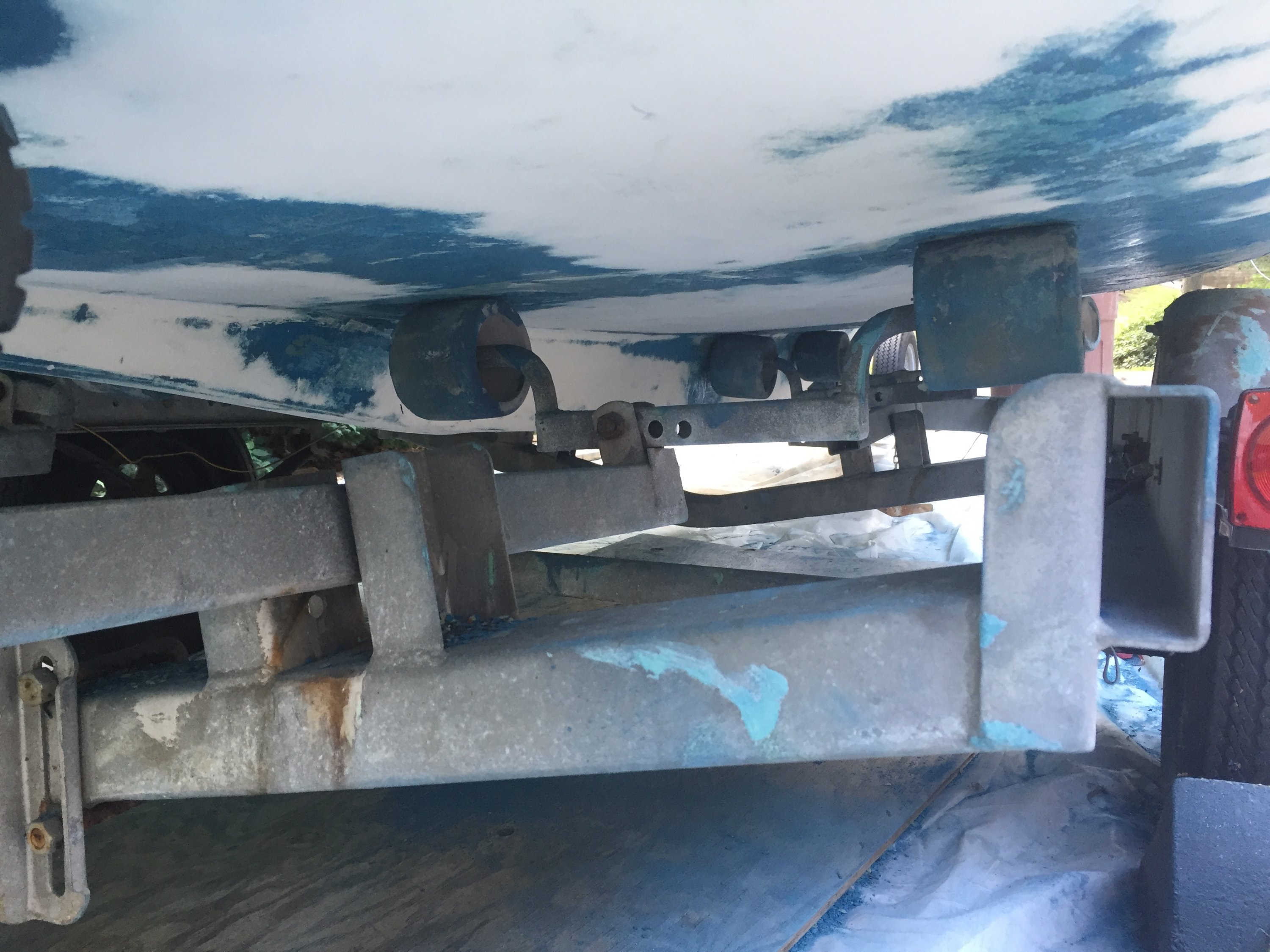

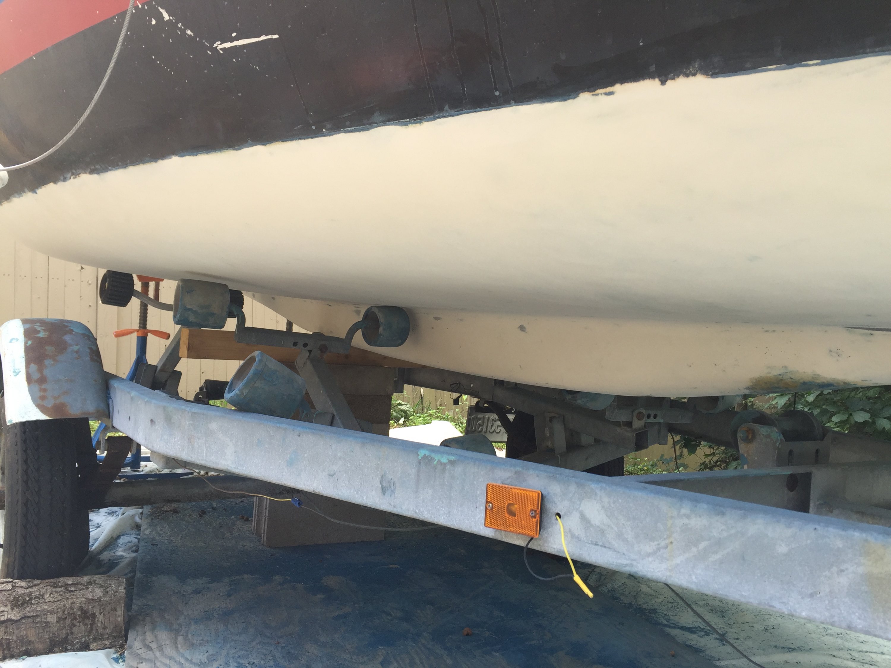

Well, raising it up off the trailer didn't work using the sea saw method. Not enough clearance.
I am buying boat stands.

Before you invest in boat stands...
Try raising the stern just aft of the centerboard using a floor jack and some blocks of wood. Additionally, you could probably drag the boat off the trailer and roll it over. This is just a 19 ft boat with no ballast, right?
You could also use a shop crane (engine lift). I lifted my C22 off the trailer using a shop crane with a tow strap run under the stern forward and wrapped around the swing keel and back to the crane. Any anchor point to keel the strap under the stern will work.
All of these solutions are less expensive than boat stands.

It's got a 300lb ballast with a center board.
No engine lift either.
Every other option I would have to buy something. I might as well get two rear stands and have a nice stable place to work. Cost my 220. I also need to get the centerboard out to fix the crack.

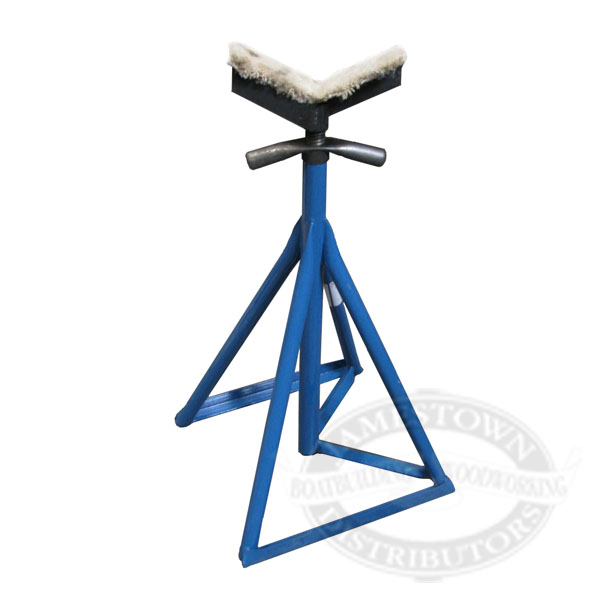

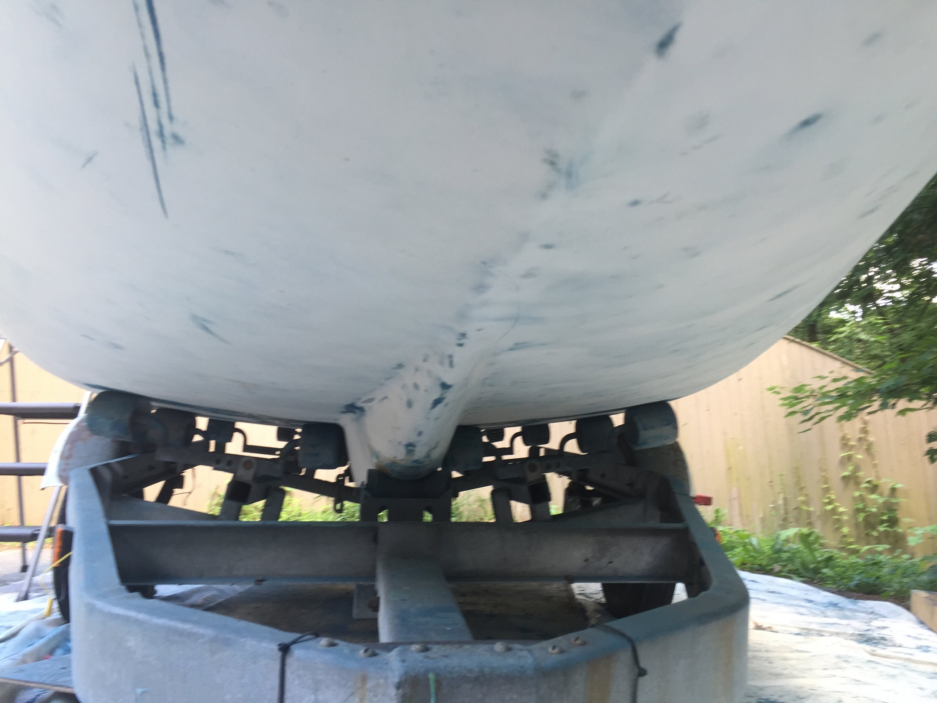

I get ya! I use my boat stands every year for one boat or another! May I suggest two V stands and a 6x6 timber about 12 ft long? It works great to lift the bow with the stands wide enough to pull the trailer out? Hmmm??? It is so nice to pull the trailer out to have the boat only on stands.

No. It is a bow stand that has the V.
Just lay some shims and carpet on the timber. Don't notch it.

Gotcha.. This?
And to be clear. Two of them and a long 6x6.
Then two boat stands in the rear and wood under the keel.

Yes. Those are the stands. Make sure they are tall enough to lift the boat over the trailer bunks and fenders. And a 6x6 timber. Mine is like 12 feet long.
Then two sailboat jacks for the stern and a keel jack. Measure the height of your boat on the trailer to buy the right height jacks.
Aug 3, 2012
2,542
The idea is to be able to set the forward stands outside the width of the trailer wheels, so you can drive the trailer out. You can also do it by walking the jacks through the trailer as you pull it out, but that is slow!
