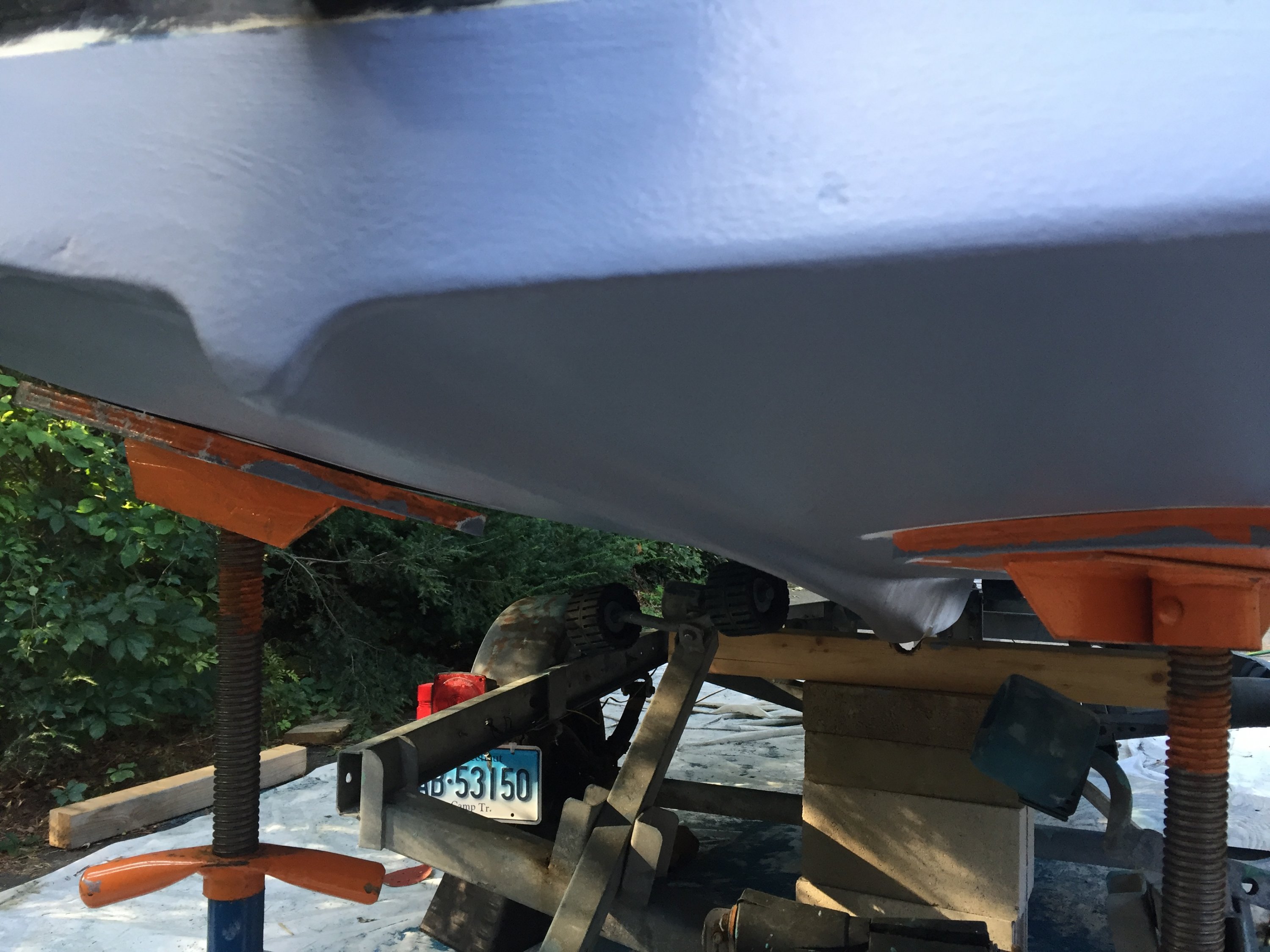

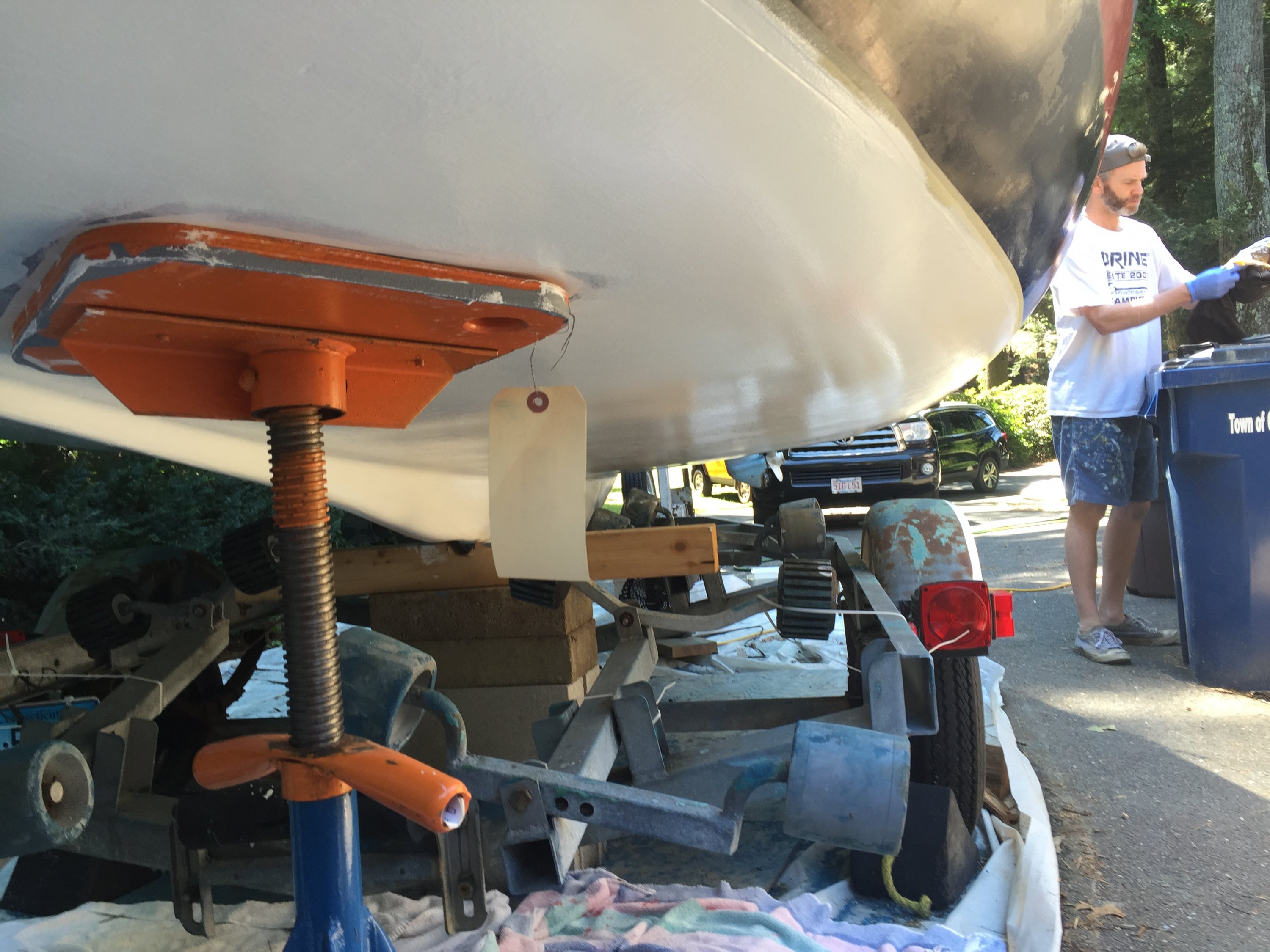

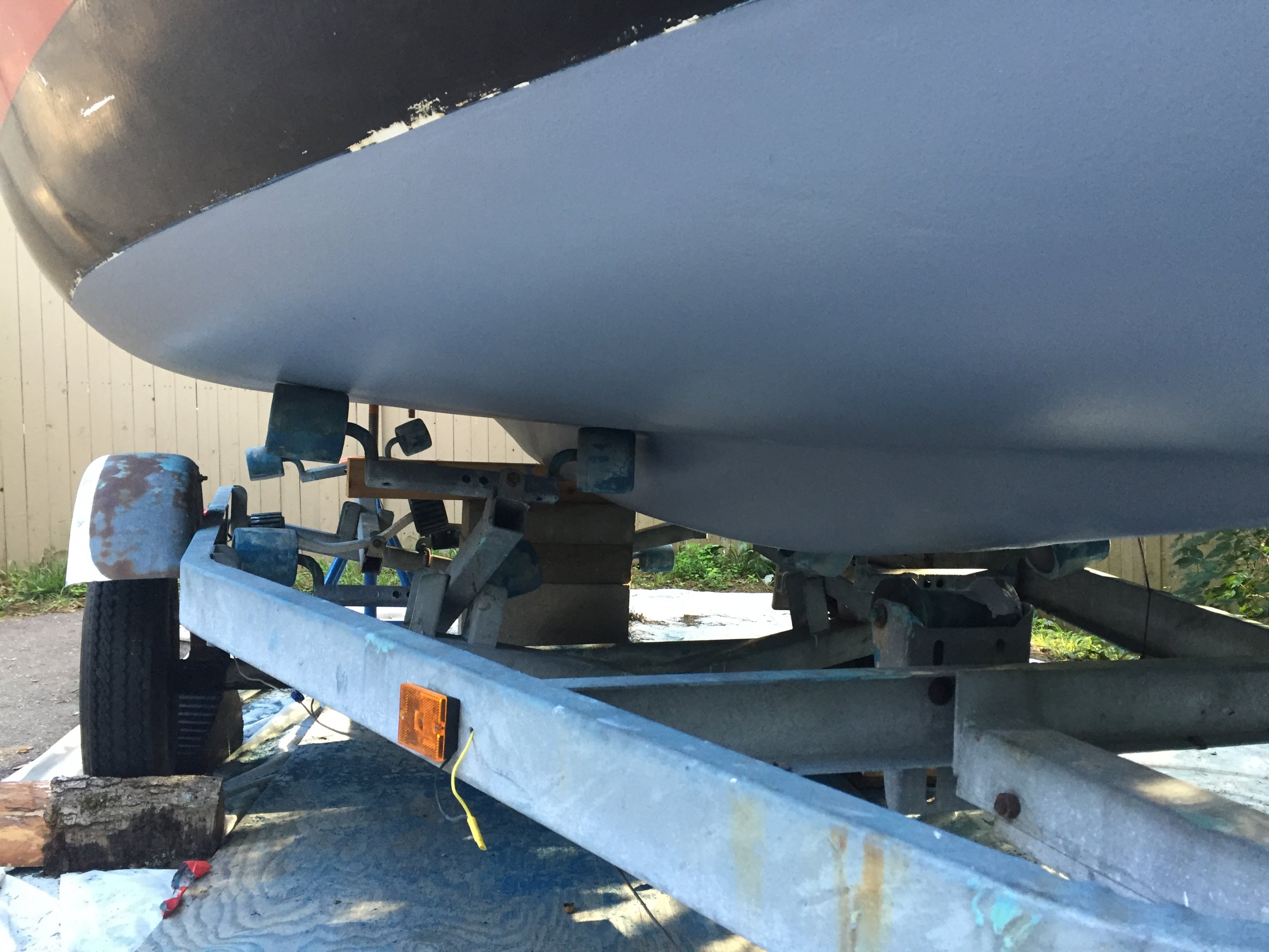

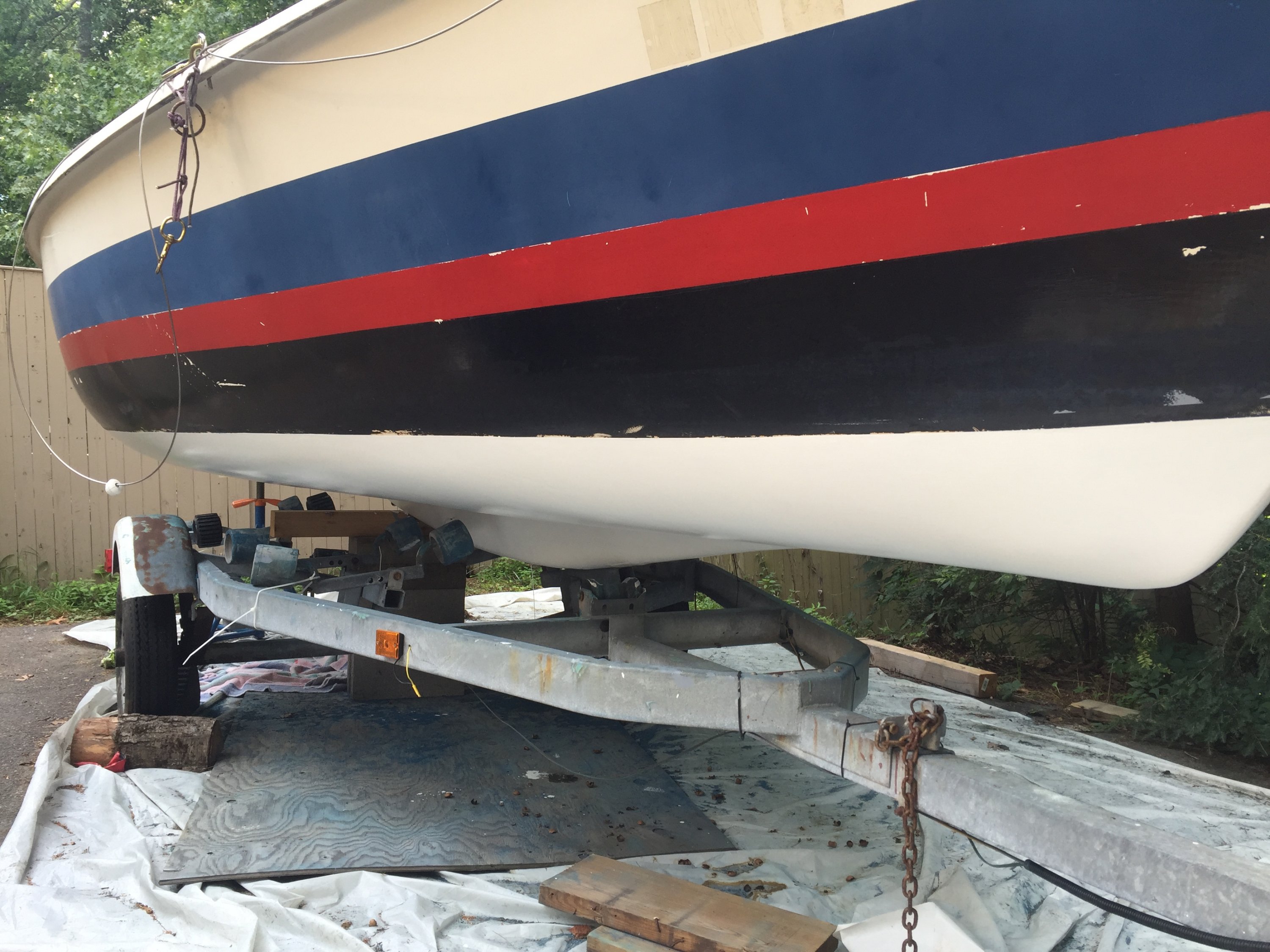

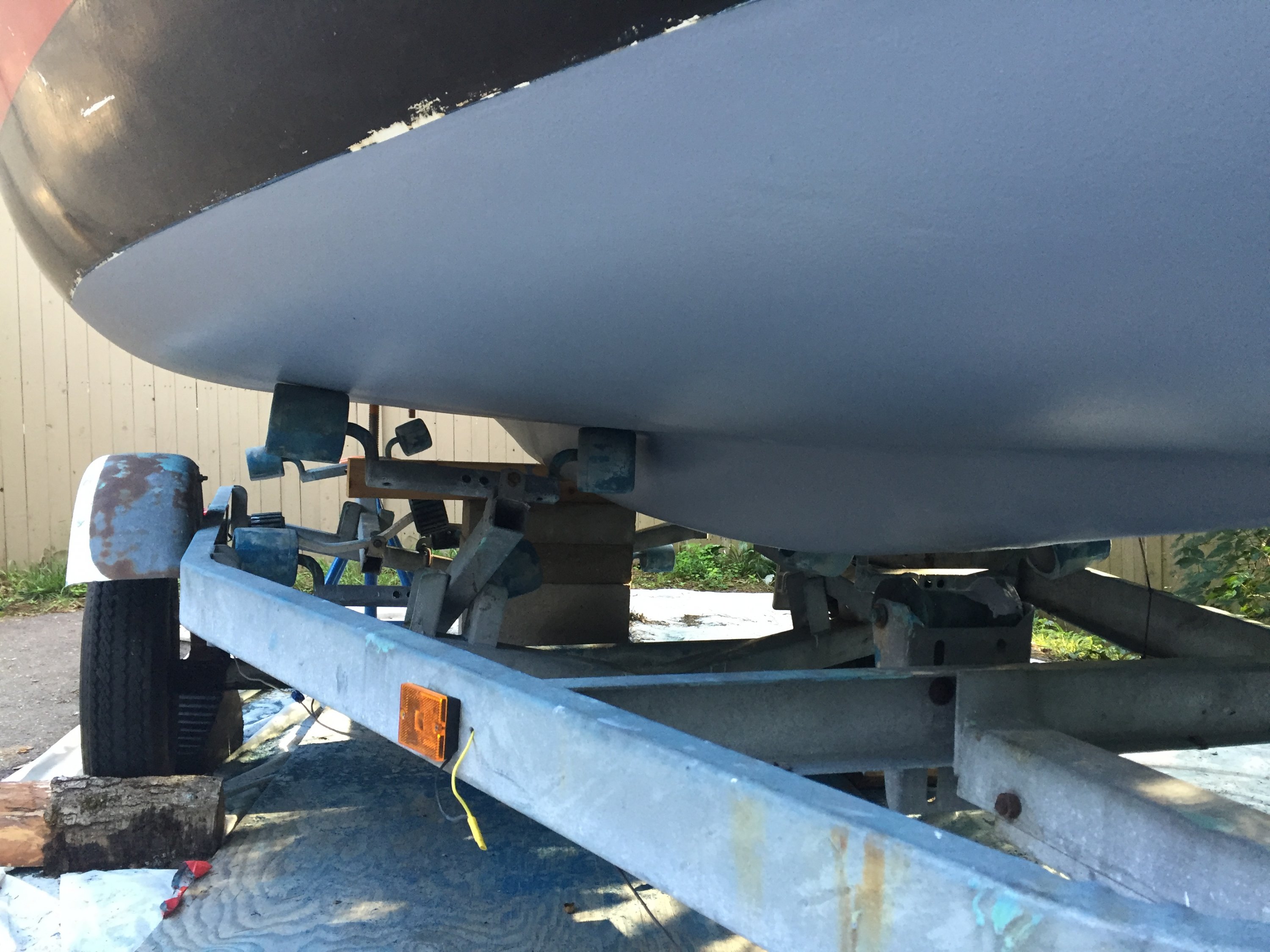

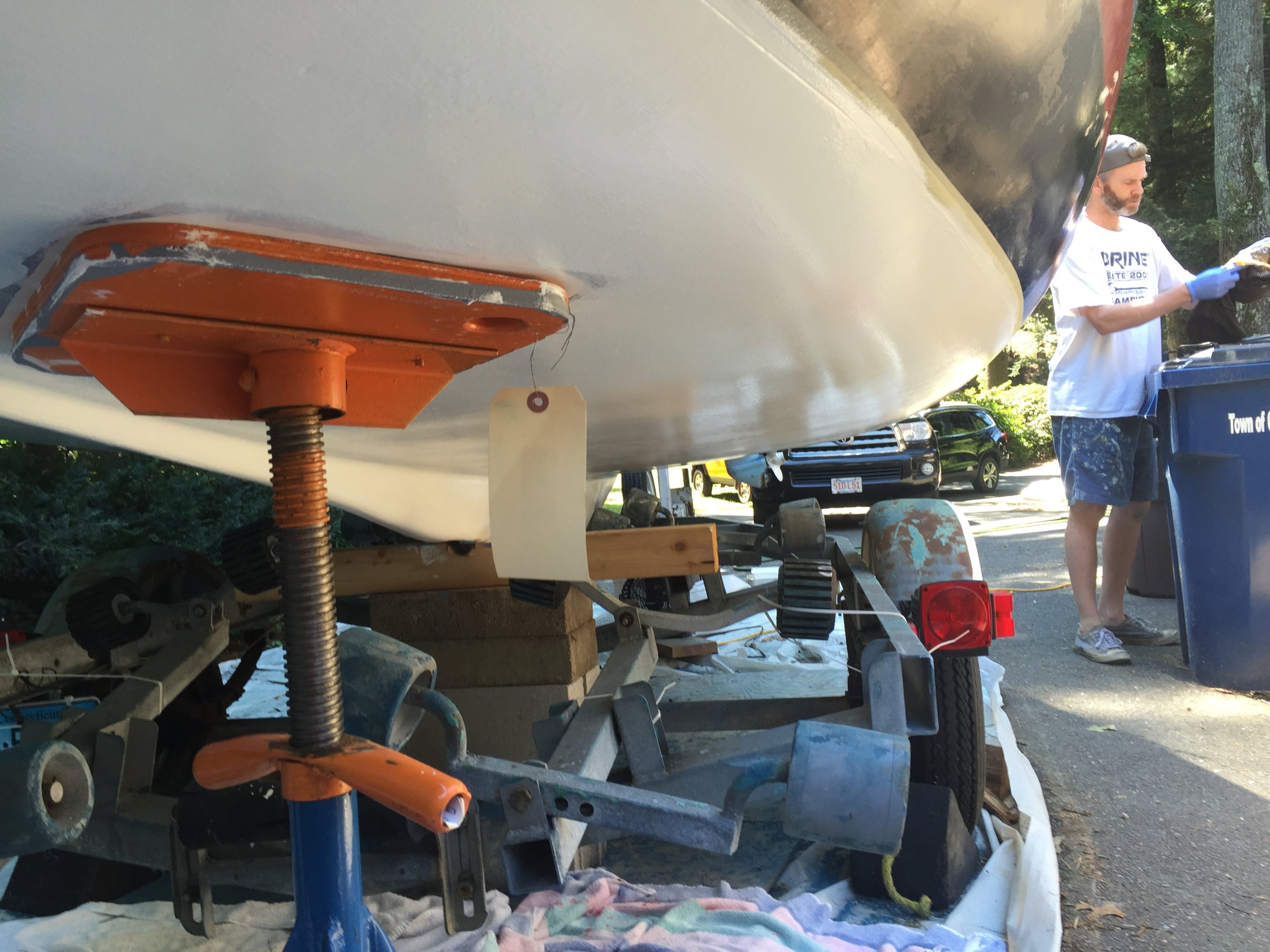

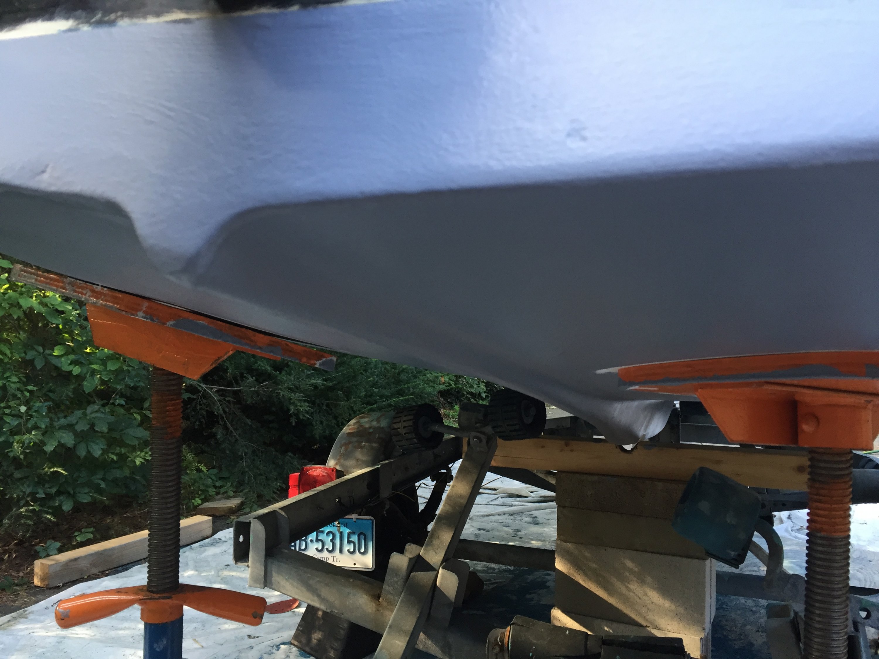

Got the paint on last week. It came out really good I think. I had enough for 4 coats with some left over for the two spots where the stands are.
I mixed the paint with a drill attachment. Worked perfect. It really was pretty easy and each coat only took 20 minutes to apply. It was 85 so the paint dried really quick. Less than 2 hours. I taped the water line with two over lapping layers of 3m fine line 218 tape which came out perfect.
Next is the final coat this weekend and we should finally get the boat in the water over in Hingham MA for Labor Day weekend.
