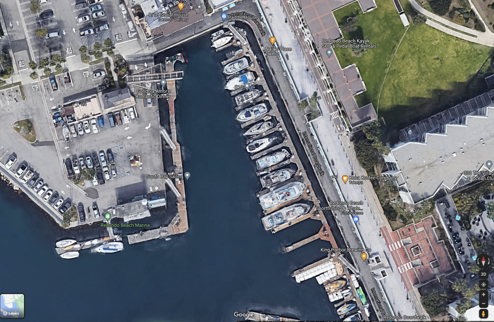

Thanks. As I understand it, the only way to get a trailered boat into the water there would be with their hoist?
Any idea on the ballpark cost for that?
Is there a place to park a car and trailer nearby?

Looks like the round trip hoist fee is $30; one way $20. Overnight car/trailer parking is $8/24-hr day. See Redondo Beach Marina Services.

Your picture is of the hoist at the King Harbor Marine Center, a boat yard. The hoist you would want is at 181 N Harbor Drive, Redondo Beach. Marina Services - Redondo Beach Marina
As I recall we did have to step the mast after launching, but that was a long time ago. You might try calling them to ask.

Fixed the image link (I think). And yes, the mast has to be down for their hoist. Not a big issue.

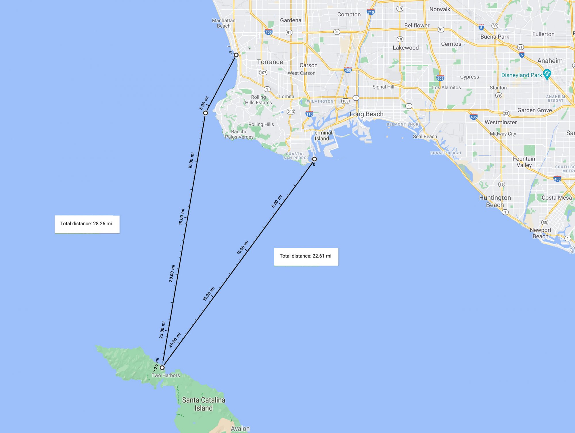

My apologies for getting land miles from Google, but this lays out my two options, with the day's wind forecast making the call. I'm thinking if the winds are from the west, I'm good with San Pedro. But if they're from the southwest, Redondo would be the better choice.
Jun 11, 2004
1,933
Oday 31 Redondo Beach
Good observation. Both can be good routes.
I don't think the distances are as large as your numbers show. My GPS numbers show King Harbor bell buoy to Ship rock passsing the PV buoy as 23.5 NM and Ship Rock to Angels Gate as 19.2 NM. Add another 1.5+ from Angels gate to the launch ramp for 20.7NM total so the difference is 2.8 NM. Call it 3. Plus, after the long trip home the beat from Angels Gate up to the launch ramp, even though inside the harbor, can be a lot of work. They don't call it hurricane gulch for nothing.
If you could get someone to move the trailer for you it would be fun to leave from King Harbor and return to Cabrillo. Especially if you have a spinnaker for the way back.

His distances are statute miles which are shorter than nautical miles (i.e., 5280 versus 6076 ft) so that’s part of the discrepancy. Also, the PV buoy should be left to port going outbound from KH, and to starboard inbound if returning that way. But if not, yes. Sailing through the LA Gate and into LA Harbor in late afternoon is nearly always a challenge but no tacking is needed if you’re on the right lay line. The SW wind accelerates passing along the Palos Verdes peninsula creating very windy conditions inside the harbor, usually in excess of 15 kt but sometimes 20. You’re basically sailing hard on a strong wind for a short distance before bearing off into the main fairway of the harbor. (Although, I’m not sure where your crane is there. If you must go to the crane at the end of the Cabrillo Way Marina then it’s further and you’ll have to remain hardened up longer, and you might have to tack twice make that entrance.)
24,696
There is not much prep difference between 19 miles and 23 miles. What is a concern, will the trailer be there undisturbed when I return.
If you are concerned than sailing out of your usual harbor makes sense. Down the coast. Spend the night aboard. Then sail out to your destination in the morning. So it is a 4-5 day trip instead of a 2day trip. As sailors we need to realize setting a fixed schedule is dangerous. It is the journey not the destination. If we have to be at the destination on a fixed schedule get a power boat. That is why steam engined boats were invented.
