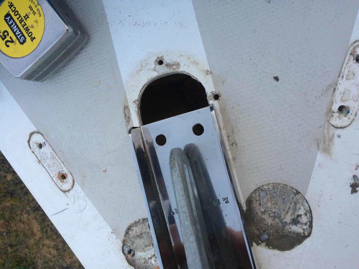

3) The existing bow roller was too small to hold even a small fluke anchor without dinging up the bow, and definitely couldn't handle a larger model.
4) We needed a lot more rode to handle 15+ foot tidal swings.

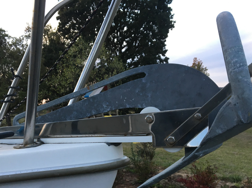

Anchor: I looked at Rocna, Mantus, and Manson models (all with roll bars), and settled on a 15-lb Manson Supreme - $185 from West Marine. I honestly don't recall everything that motivated that choice. All three have huge advocates. @Maine Sail had good things to say about all of them. In the end, I think a West Marine sale (with free shipping) was a part of my final decision.

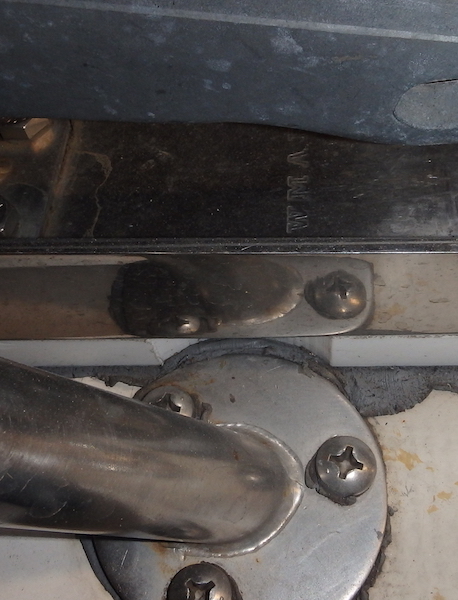

Roller: I selected a Lewmar 66840008 roller, $136 (https://shop.sailboatowners.com/prod.php?12147). It normally mounts with 3x 3/8" bolts, but I needed to mount the stem fitting inside it, so I had 4x 5/16" holes drilled (off center, to shift the headstay a bit away from the shank of the anchor). So the 4x 5/16" bolts replace 1 of the spec'd 3/8" (as always, backed up with G10 inside). At the time, I didn't have a drill press, so I had a shop do this alteration for me. Even though I have a drill press now, I still might do the same. The slowest speeds on most consumer drill presses is marginal for 5/16" in SS. And it would require expensive bits; so unless you have plans for other projects that justify tooling up for big holes in stainless, this might be a good thing to outsource ($60).
The roller fits the anchor perfectly; the only problem is that the roller is wider than the space between the bow pulpit's front supports. I raised it up just a bit on a 'bowsprit' made of King Starboard - with cutouts to fit the Starboard around the pulpit mounts. See the close-up picture, and try to ignore all the mess of butyl tape I haven't cleaned up.
The Starboard isn't structural, just a lift to get the roller up over the pulpit mounts - the stainless holds all the load. If I were starting over, I'd probably use some G10 or structural FRP instead - I've since read @Maine Sail's admonition that Starboard is notoriously difficult to seal, as nothing (including butyl tape) sticks to it. It appears that mine is sealed OK, so I'm not going to remove it until I have to, but if I ever do, I'll probably replace the Starboard.

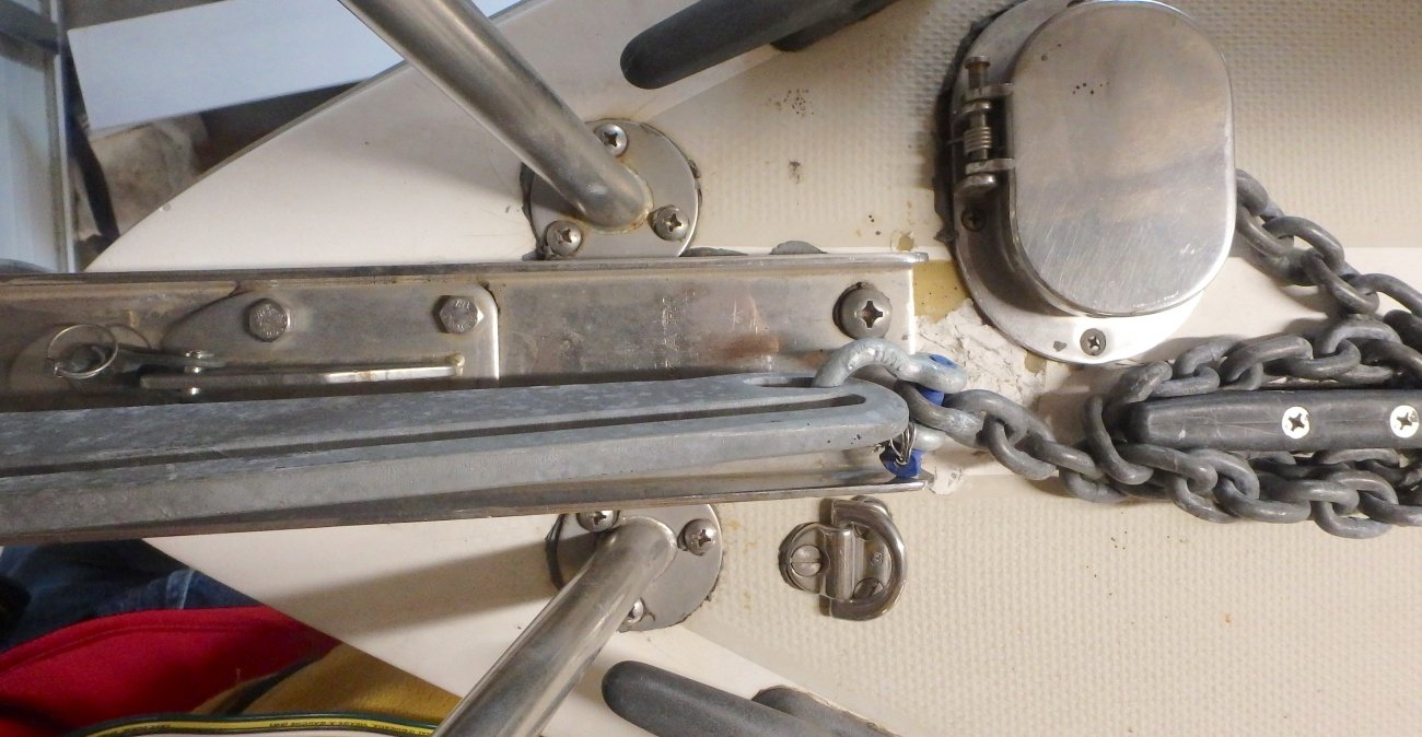

Chain: Traditional wisdom seems to be that a small crusing boat should carry a short length of chain, followed by traditional nylon rode. Different sources recommended either 2/3 or 1 boat length of chain (or around 15-22 feet for us). In my normal paranoid fashion, I considered the recommendations for 2/3 - 1 length, and comprimised - on 1.5 :).
30 feet of 1/4" G4 chain: $96. G4 is stronger than G3/BBB/Proof chain in the same size, so I went with a longer length of 1/4" instead of a shorter length of 5/16". The weight is comparable, and we have a longer leader of chain on the seafloor, and thus (hopefully) a little better resistance to abrasion.

As I noted in when discussing the bow rebuild, I went up from 6" to 8" bow cleats. They're rock solid, mounted through a half inch of G10. But there's not a clean fairlead for the anchor rode through the bow roller to the cleats alongside it. So I mounted a third cleat, directly behind the roller. The rode leads nicely through the roller to that cleat, and when the anchor is on the roller, I can wrap the chain tightly around it as a chain lock. It's a bit smaller than the bow cleats (to fit the available space), but it's easy to back up the connection to one of the main bow cleats as well.
When traveling, the cleated chain keeps the anchor in place, but I usually also support it with a couple bungee cords, to keep it from bouncing and rattling while trailering or sailing. So far so good (the bungees degrade in UV and have to be replaced every year or two, but they're pretty cheap).
I remounted the hawsepipe (if you look closely at the rear of the roller, you can see part of the original location, filled with fiberglass and with some really messy gelcoat over it. Someday I'll learn to do gelcoat right and clean that up.
I've read horror stories about using the bow space on an old-style C-22 as chain locker. It's worked OK for us thus far, but I'll probably someday glass it in, seal it with a waterproof hatch, and add a drain (making it a bit closer to the anchor locker on a new-design). That will also add a few cubic inches of space for our rode, and make it easier to get back into the locker. Maybe you'll see that project described someday, but don't hold your breath.
In the meantime, I have no complaints about the setup. The Manson sets smoothly; not that I have much experience for comparison, but I'm happy with it. The roller helps squeeze water out of the rode as it comes up, so we don't get quite so much water on deck or in the locker (for the moment, since our locker doesn't have a drain, I usually bungee the wet rode on deck to dry for awhile before stuffing it back in the chain locker).

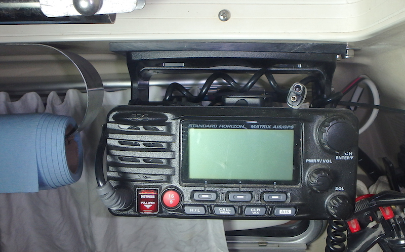

It actually wasn't hard to choose a VHF - about the time we started looking, Standard Horizon introduced their GX-2200, with integrated AIS receiver and built-in GPS - the internal GPS receiver means it can do DSC and AIS without a separate chart plotter. To my knowledge, prior to this unit, you could choose a model with internal AIS or one with internal GPS, but not both. There might be a better option now, but we've been happy with the 2200.
Some previous owner had clearly mounted a VHF on the cabin ceiling, just ahead of the starboard bulkhead. That seemed like a reasonable place, so I stuck with that location.

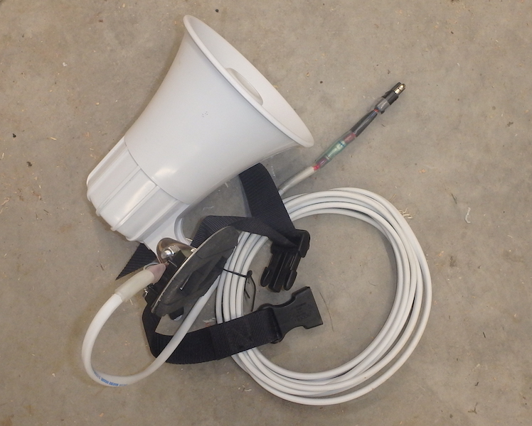

Hailer Horn: Like many other fixed-mount VHFs, the GX-2200 supports a hailing horn. We'll never use it for hailing, but might someday want the automated foghorn functionality - it can do all the required fog sounds (horn, bell, etc.) I couldn't find a smooth place to mount the horn that wouldn't snag sails and sheets or interfere with stepping / unstepping the mast, so I wired it for quick setup as needed. It lives in the V-berth locker and will mount to the mast with a cinch strap if it's ever needed (with a little neoprene on the base and a trailer plug to connect to the VHF).

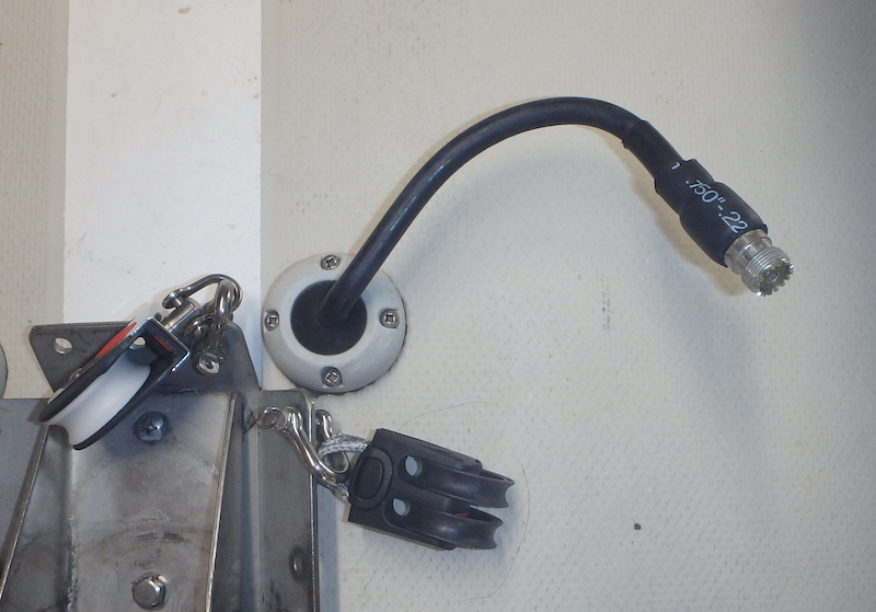

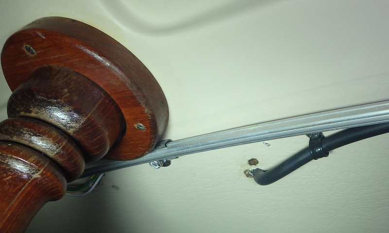

Coax: I used Times Microwave LMR Ultraflex 400, primarily for its 1" turning radius. Admittedly, my inner geek was probably seduced by its incredibly low loss specs too (0.8 dB/100'), but that's actually not hugely important for a 25' mast. In retrospect, LMR-240-UF (which I didn't find at the time) would probably be a better choice for a C-22. Higher loss, but less weight up high, and about 2/3 the cost. For a bigger boat with a longer mast, the LMR-400-UF is definitely a good option. I bought coax, connectors, and a crimp die from DX Engineering.
See @Maine Sail's instructions on coax connectors at https://marinehowto.com/easy-vhf-terminations/. I ended up using Amphenol crimp-only connectors, but his crimp-and-solder recommendations are probably better.
I used a Scanstrut deck seal to get coax through the deck. I did find a coax-specific through-deck. But if I recall correctly, it was designed for a thin deck, so I would have had to cut out a sizable hole in the cabin liner, mount the through-deck on the deck skin only, and use a PL-259 connector in the cabin. The cable clam sytem with a little pigtail on the deck seemed cleaner inside the cabin. Scanstrut makes both plastic and stainless models. In the PNW I've just used the plastic models, but down south, the stainless would probably be worth the extra cost.
Coax connectors are usually (perhaps always?) male, so there's a female-female adapter on that pigtail. When we splash for the season, I usually seal that connection with self-amalgamating tape or shrink tubing. Either is pretty easy to get off at the end of the season, but you wouldn't bother for just a daysail or a weekend.
