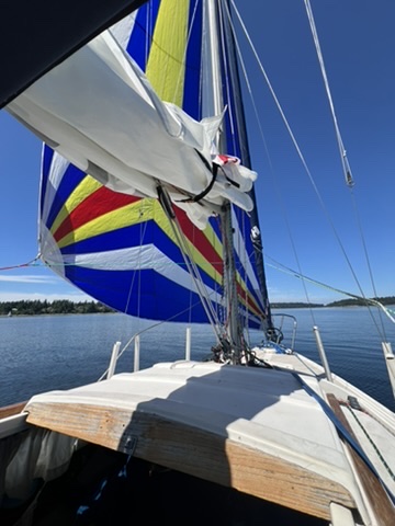

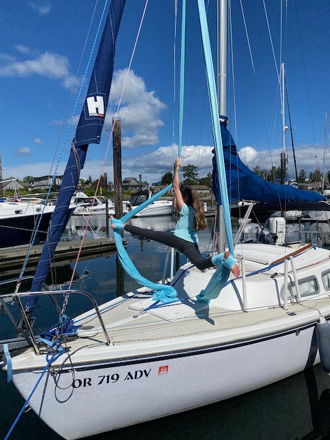

My daughter's birthday present this spring was a set of aerial silks, and I got major Dad points for rigging them on the foredeck. She doesn't love the time spent under sail, but we try to give her some positive memories of boat trips.
The solent stay and halyard worked quite nicely, with a couple soft shackles to space everything centrally. Lots of dyneema put to good use. :cool: (I did forbid any acrobatic drops to avoid shock loading on the rigging).

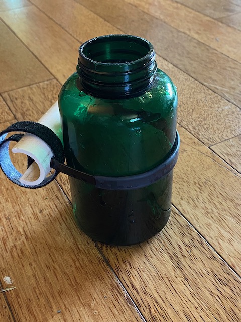

A little beauty on the stern rail
My wife grows flowers, and does arrangements for events; she misses her flower gardens while sailing. We were once gifted a few flowers by a dock neighbor, and found ourselves cruising with an empty pop can strapped to the stern rail, serving as a vase.
This one is a bit of an improvement.
1 empty vitamin bottle, washed and scrubbed with acetone to remove the sticky residue
1 long zip-tie with heat-shrink for friction
A few inches of PVC, slotted to snap over the stern rail and drilled for the zip-tie
1 short velcro wrap to back up the PVC (probably not necessary, but easy to do, and I had a big package)
Time: 20 minutes
Cost: $0
Protip: Heat-shrink the zip-tie BEFORE attaching the vitamin bottle. Pointing a heat gun at the vitamin bottle produced something vaguely modern-art-ish, but it wouldn't have made the best flower vase. That mistake delayed this little project by a few weeks, until we finished the next bottle of vitamins :)
And, for future reference, 3/4" Schedule 40 PVC, slotted a bit on the table saw, makes a nice light-duty clamp for our 7/8" stern pulpit tubes. I did the same for a hanger for our kitchen tools. Cut out ~1/4 of the pipe circumference and snap it over the rail. If it's too tight, cut a little more; if it's too loose, try again (PVC is really cheap). I add a little velcro strap to secure it, but the PVC is snug enough I doubt that's necessary.

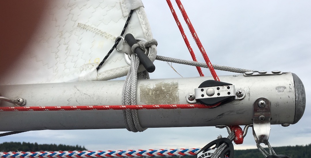

Topping Lift

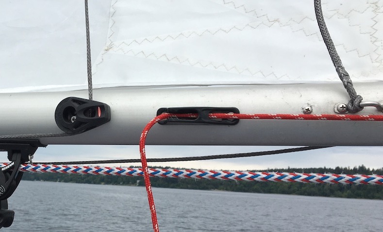

Breezy came with a fixed topping lift, of dacron double braid. The line line was old and stiff, and a pain to use. So I decided to replace it wholesale.
Single-braid Dyneema (Amsteel, Endura 12, etc.) is really easy to splice, and this was a good chance to practice. Just be sure to use a bury that's plenty long (72x the line diameter) and use a Brummel splice or lock stitch your deep bury splice it to ensure it won't slip under light load. Note: I first did this with 1/8" Amsteel, and I've since replaced it with 1.75mm Samson Lash-It. Very low windage, and ~500 lb test, which is plenty for our ~15 lb boom. And I wanted to repurpose the 1/8" for something really important - hanging lines for a backpacking hammock, IIRC.
Rigged the same as the CD version and Stingy's with a repurposed micro block, a bit of 3/16" Sta Set, a 20mm cheek block, and an old jam cleat. This system lets us raise the boom at the dock for more headroom in the cockpit.
Two notes:
1) On the first go-round, I put a small cam-cleat on the boom (where the cheek block is now). I thought it would be quicker than the CD / Stingy arrangement. But we found that the boom would often rotate just enough to pop the line out. We ended up wrapping the tail around the boom and tying it off, which was secure, but a pain to do. So I replaced it with the cheek block and jam cleat.
2) Splicing Lash-it requires really small wire fids - I use .020 piano wire.
Cost: ~$35
$18 (sale price for a full 180' spool of Lash-it)
~$12 for a micro cheek block
~$5 for 3/16" Sta-set
Time: ~2 hours

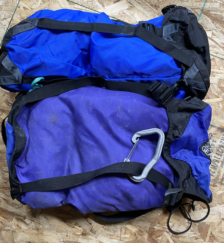

A simple cooking-fuel safety system
As you probably know, it's a bad idea to store cooking fuel canisters onboard while you sleep. A pressurized canister contains quite a lot of heavier-than-air gas, enough to displace the oxygen in your sleeping compartment, risking asphyxiation and/or explosion danger.
Many older small boats (including original design C-22s) lack a proper vented propane locker. Some owners elect to fabricate one, but I've found that a compression stuff sack hung off the stern pulpit meets my needs. Just 1) Make sure the canisters hang below the gunwale, so leaking gas would go overboard; and 2) Use a hanging bag strong enough to keep your cooking fuel away from Davy Jones. A morning without coffee would be a sad one! :yikes:
I use a couple compression stuff sacks:
Something about like this one from REI They're designed to smash sleeping bags, clothes, etc. to save room in a backpack. I had a couple in my backpacking closet, sitting idle since I bought smaller and lighter gear (and noticed that the sacks themselves add significant weight to a pack). Because they're designed to compress bulky gear, they're somewhat beefier than a normal stuff sack, with reinforced top and bottom and straps and buckles supporting the sides. Ideal for hanging something moderately heavy off the stern pulpit.
A spare backpack would probably work too, but I like that the compression sacks don't have any zippers to break.
Mine are enough to hold 4 propane bottles + a couple Jetboil fuel canisters - adequate for a 2-week cruise for our family of 4.
If the dinghy is convenient, I'll sometimes drop the bag in her, and the carabiner secures it nicely there as well (a leaky canister might fill the dinghy, but her gunwales are much lower than Breezy, so excess fumes would spill out and won't ever end up in the main cabin).
And yes, we also have a fuel vapor alarm. Because paranoia...
Cost: $0 for me, maybe $20-25 to buy new

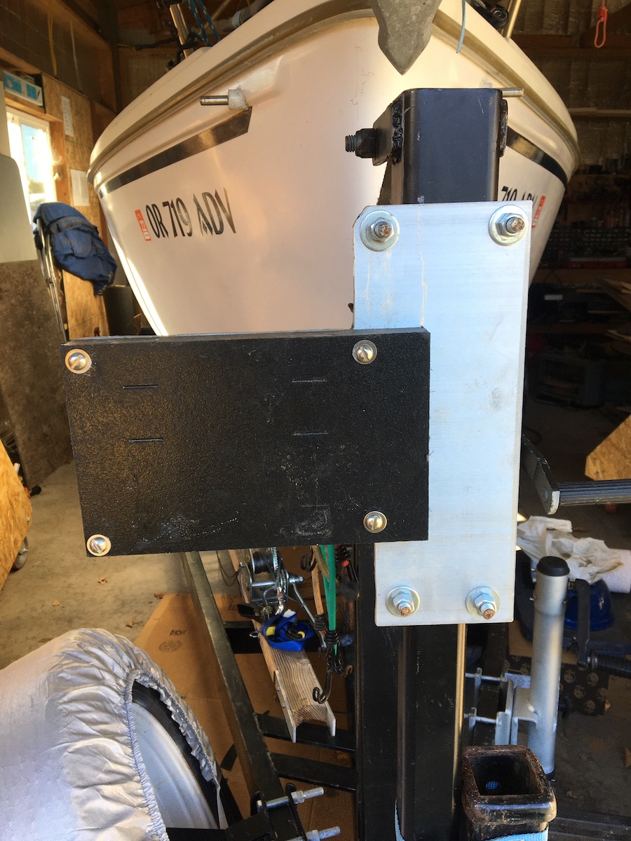

Trailer Tongue Weight
My Weigh-Safe hitch told me I needed some a lot more tongue weight. So, a few modifications:
1) The easy (albeit expensive) one: A spare-tire mount near the trailer tongue.
Looking back, I used a Dutton-Lainson 6126, for which I paid $87.92 (they're even more now). I have no recollection of why I paid so much more than the knock-off brands are going for. D-L makes good stuff, but it's a hefty premium. Since then, I moved the bracket, after only 2 seasons and ~5 salt-water baths, and found the mild steel bolts were already nearly corroded solid, so I replaced all the hardware with 316 SS - another ~$20 or so.
That moves ~40 lbs from near the axle to the tongue, netting 30+ lbs tongue weight.

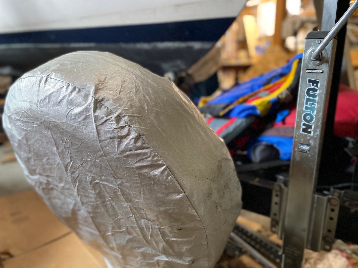

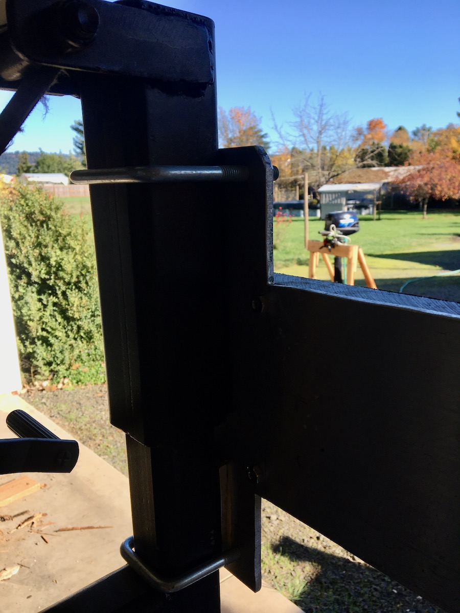

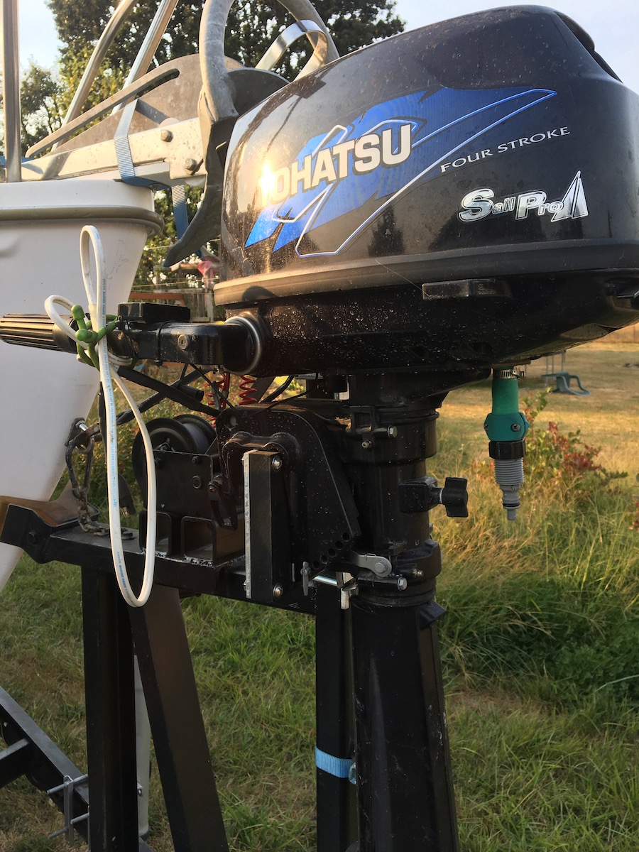

2) Outboard mount on the tongue
For several years, I trailered with our outboard on the stern, using Stingy’s method. A little hacking with some 1/4" aluminum sheet and 1" Starboard I had on hand + ~$20 in u-bolts made a tongue mount for the motor. Yes, buying a welder and learning to weld would be more fun, but this was a lot cheaper and a LOT faster.
And it moved 60 lbs from stern to tongue, netting ~120 lbs tongue weight.

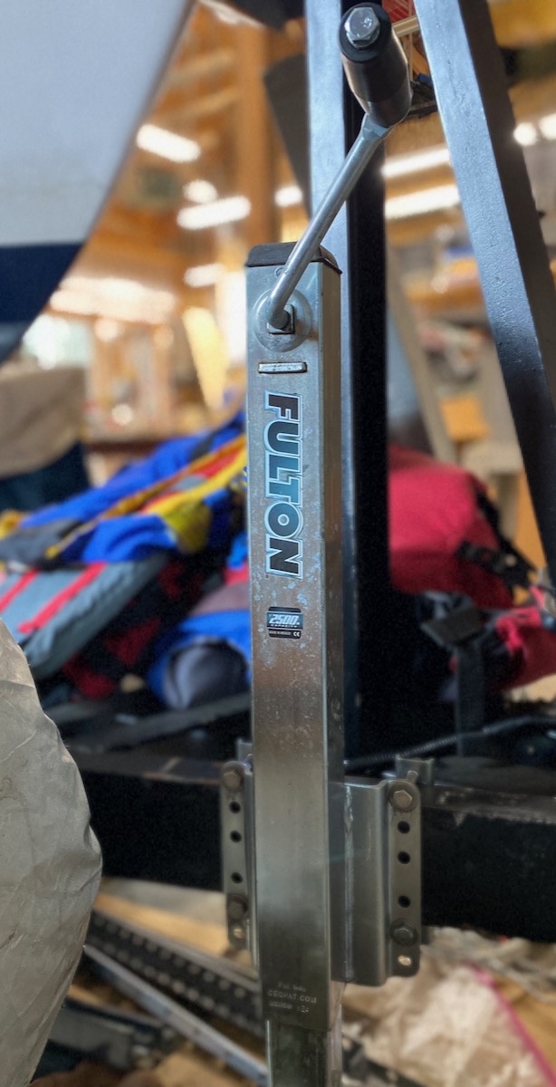

3) Another trailer jack.
I'm really happy with the Fulton 1500 lb XLT (#141133) we put on a few years ago. The roller even survived being winched up onto a tow truck. But: 1) That tow-truck adventure strained the jack pretty hard, and I'm sure used up some of its life; 2) With a wheel, the jack travel is limited, and it won't lower all the way down onto the low-drop stinger I launch with. This season, we added a Fulton HD25000101, 2500-lb jack as well. Redundancy, works for the launch stinger, and adds some more tongue weight. $98 + SS hardware
Weight 24 lbs; net ~20 lbs
4) Hitch extension on the tongue
Added a slot to hold the hitch extension and stinger we use for launching. Again, some square U-bolts and scrap.
Net ~25 lbs
Total tongue weight improvement is ~200 lbs. I still carry the gas tank and BBQ in the truck and try to shove most gear into the V-berth, but at least now we're at a much safer weight for towing.
Cost: ~$250
Time: ~3 hours

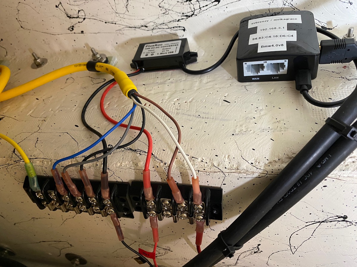

Wifi Router + Extender (Cheap Geekish Solution)
We occasionally end up at a marina with weak Wifi (some marinas don't prioritize coverage at their guest docks). We don't always need Internet access, but on a marina night, sometimes it can be good to catch up - or even to stream a family movie :)
For a couple years, I'd used a USB Wifi adapter on a long USB cable. That works pretty well, but you have to jump through some Internet Sharing hoops to share it beyond the one laptop it's attached to. And when I added a plotter, I wanted to try sharing some of its info with auxiliary devices (e.g. the B&G app on a phone or iPad). So I upgraded to a little boat router with 2 Wifi radios - one to connect to a shore-side network, and one to share that connection with all boat devices. The latter serves as the boat network, whether or not we're connected to shore-side Internet, and the shore-side connection is again on a long USB cable, so it can be raised to the spreaders for longer range. Installed in the starboard pipe berth, up in the coaming, and the long cable lives in a mesh pocket nearby.
GL.iNet GL-AR300M16 Travel Router: $28
  • Not a brand I'd heard of before; the case is a little cheap, but the hardware seems solid, and it's well supported by OpenWRT. GL.iNet's default firmware is their own OpenWRT setup, but it uses up a lot of storage for all their extras, so I installed a clean distribution to leave space for the packages I needed.
  • Powered by a Micro-USB input
PlusRoc DC-DC converter (Micro USB): $10
  • A cheap and reasonably efficient 12v -> 5v / Micro-USB power supply.
RT5370 USB Wifi Adapter: $12
  • Just 2.4Ghz 802.11n, not AC or any of the newer and faster options. But it has a chipset that's well supported by OpenWRT. Plus, when would we get 100 Mbit service in a marina anyway? And when would we need it? Streaming a movie works fine with just a few Mbits. If that one isn't available any longer, you're looking for something with the same chipset.
Monoprice 32' USB Cable: $14
  • USB normally limits cable length to 16'. But that's from a device to a hub - I believe this cable adds a tiny hub (powered from the USB bus itself) halfway along, so you can get 32'. They make longer models too (presumably with another little hub chip every 16')
The router's internal Wifi is configured as a boat network - all our devices connect there. The external USB Wifi adapter connects to a marina network. Most of the time, that adapter and cord stay coiled in their little mesh pocket. If we're out far enough from the marina antenna that the Wifi is flaky, we raise the USB adapter up a flag halyard.
I powered up the router via the DC-DC converter on my bench power supply and measured its draw at 141 mA when idle and in normal usage - it occasionally blipped as high as 170-180 mA on a reboot or when initiating a connection, but should always average less than 150 mA (~45 w/h per day, or ~3-4 Ah if running full-time). It's on the same circuit as our AIS transceiver; we normally leave it on 24/7, but if the batteries are getting low, we can turn those off for a bit.
I used the TravelMate package for Wifi bridging. We haven't tried it in many marinas, but it seems to work thus far. I have detailed install instructions, but those are pretty long and not really edited; PM me if interested.
Cost: $64
Time: ~2 hours

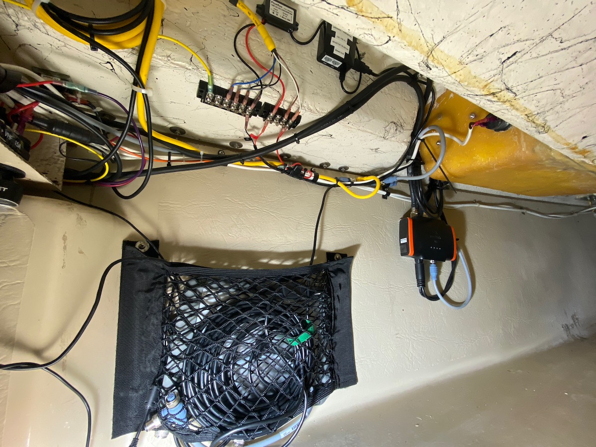

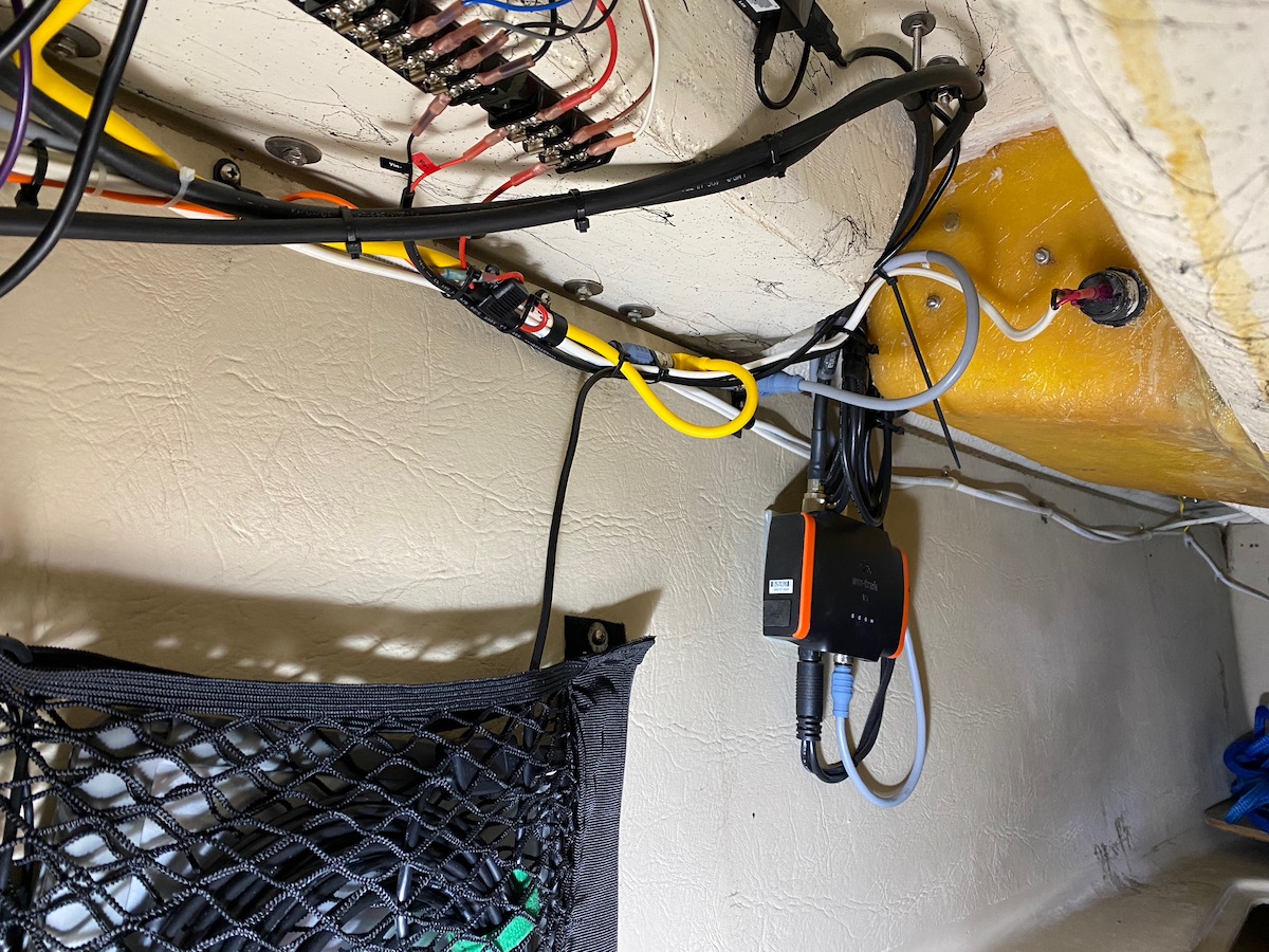

Em-Trak B953 AIS Transceiver

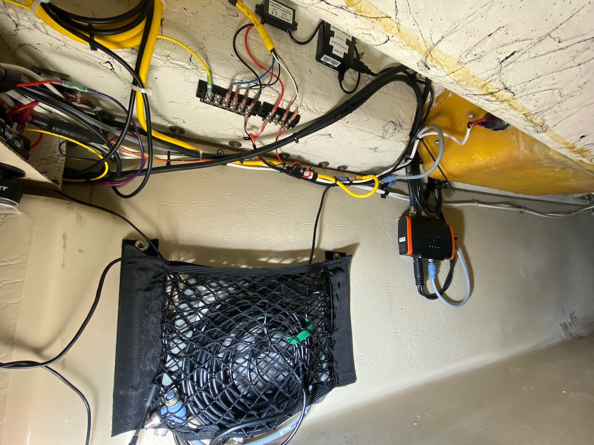

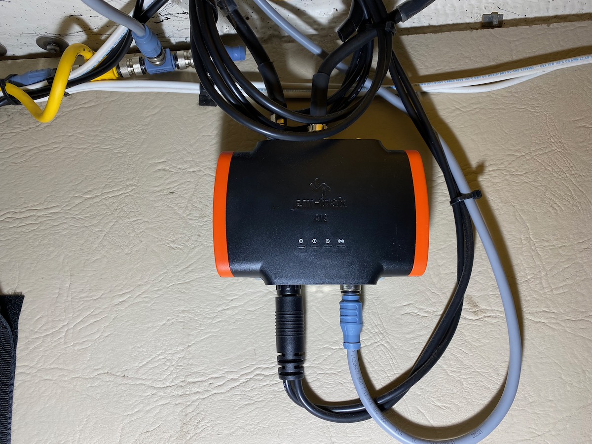

We've been caught out in fog a couple times, and decided we'd really like it if the big steel things could see us.
I settled on an Em-Trak B953, class B+ / SOTDMA with integrated splitter, purchased from Milltech Marine. Milltech was very helpful - recommended!
Em-Trak's B900 series includes models with almost any combination of features you might want:
  • Class B or B+ / SOTDMA
  • Without or with an integrated splitter
  • Without or with integrated Wifi and Bluetooth
Pick your features and price point. I picked B+ with splitter, but no Wifi (I added a separate Wifi router, detailed above)
I also considered:
  • Vesper 8000 - it's really highly recommended, but it doesn't support class B+ / SOTDMA, and requires an external splitter, and uses NMEA 0183, so I'd need a gateway to output to a NMEA 2k plotter.
  • Vesper Cortex - a really amazing idea and system; if I was starting from scratch, and didn't already have a good VHF, I'd probably choose this. But as it is, I couldn't justify the price tag.
  • A few from Si-Tex, Digital Yacht and B&G - pricing and feature sets didn't seem to line up quite right for me.
I mounted it in the starboard pipe-berth area, close enough to our existing VHF to use the same coax cable, adding a short jumper from the VHF to the AIS (since the AIS includes an integrated splitter, it is wired between the VHF and the antenna). When I did the VHF a few years ago, I'd bought enough spare LMR-400 cable and crimp connectors to make the jumper.
I wired the tranceiver on its own breaker, separate from the other navigation equipment; we expect we will normally leave the AIS on when we're aboard (e.g. when anchored), even when we turn off the plotter, VHF, etc.
Em-Trak includes a nice mounting plate - screw the plate to your mount location and then clip the unit onto the plate; it took a couple tries to get that to work - I think because nothing on a boat is quite straight, so the plate bent just a hair when mounted, and then the unit wouldn't clip to it. Added a flat sheet of 1/4" G10 behind it, and everything worked great. The unit supports an external GPS antenna, but our GPS-enabled VHF is mounted under the cored cabin top, and it had never had a problem there. So I guessed - correctly, as it turns out - that the AIS would be able to see just fine through the thin cockpit fiberglass. YMMV, but you can always add an external antenna if necessary.
No complaints thus far about the AIS - we couldn't test it until we were on the water (it's not legal to transmit on marine bands on land). And we didn't have a buddy boat to check our location. But within a few minutes of leaving the dock, we could see ourselves on MarineTraffic's app (they use a network of shore receiver stations and report the info received on the Internet). So we knew we were transmitting nicely. And the NMEA connection to our plotter works great - we can see all the big steel things from around the corner. And if they're looking at their AIS, they can see us.
Cost: $773
Time: ~8 hours
Including a lot of rewiring and cleanup of my old and sloppy electrical wiring, and a couple tries at getting the unit to mount - as noted above, ensure your mounting surface is flat, and you'll save some hours
