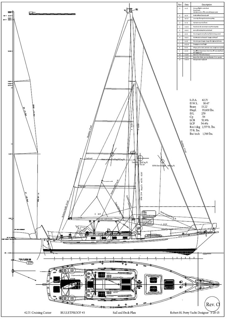

Talking about Carbon in boat design, in 2017 Bob Perry was commissioned to build 4 identical carbon fiber boats.
Here is the story from 48*North.

Perry has a good eye for a boat.
Search ”Perry carbon boats”.I believe there are other online reports.
