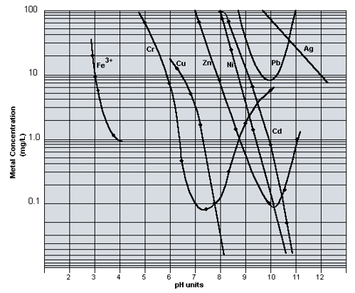

In fact, there is very little iron in the water, depending on the pH. No more than a few ppm. What you see is precipitation when ferous oxidizes to ferric. Even in well water, it is tiny compared tothe contributions of sulfate, bicarbonate, chloride, sodium, and calcium.
I've always found these plots useful.

If you want to remove the Fe from your well water, using Thinwater's charts...
Raise the pH to about 8 [ use baking soda] and let sit for a bit to see the FeOH settle out.
Filter it and then add back some lemon juice for taste and back to neutral.
No more Fe in you water.
Chemistry in action.

FWIW, suspended iron is not going to contribute to conductivity.
In fact, precipiatating these metals to such low levels is not as easy as just changing the pH. The crystals that form are far too small to settle. But now we are wondering off-topic towards water treatment.
