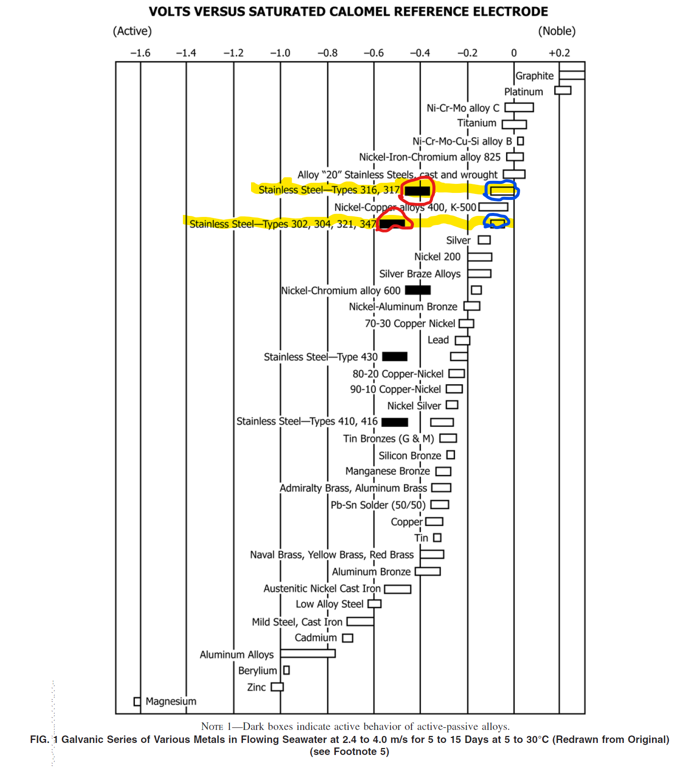

I'm sure one of the things that is remarkable is that the stainless steels have both an active and passive state as shown on the Galvanic series (graph taken from ASTM G82).
I've highlighted the austenitic alloys found in this chart. The active potential is circled in red and the passive potential is circled in blue.
The when/where/how/why these alloys pass from passive to active is still an unknown. Also of note, the EMF potential of these alloys is nearly the same as titanium when they are in the passive state. I've spent a number of years working in the practical arena of passivating stainless steels, titaniums, and other alloys.
