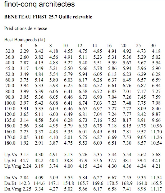

What is also interesting is a small heading change of 3degrees to gain boat speed really doesn't offer advantage, rather a disadvantage. I have not paid enough attention to VMG, rather trying to point as high as possible without pinching. It might be fun to play out some more scenarios when sailing.
Indeed, pointing as high as you can can often result in slower speeds, and/or slide slipping due to stalled foils. A boats ability upwind can be tracked on it polars, like BlueJs. Most boats with a high aspect keel will look like this angle wise (Up.Bt), the speeds (Up.Vs) are a function of length. Note how it starts wide as speeds are low and the foils are not working well. But once the boat powers up, to the moon!

So if this is the correct answer my, keel challenged, H25 is better off taking the long way home .
Yeah, but wait till you get the wind input to the AP fired up. Mr. Bill gonna be pissed.
Correct for some imaginary boat in a certain breeze. Every boat will have its own polar chart. But if you OBSERVE that, you will know what is faster if you do the VMG calculation. The trick for most small boats is knowing the True Wind Angle with that resolution. You need good instruments, as its hard to gauge.

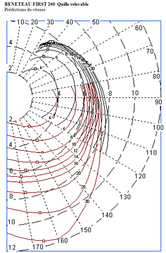

I'm not sure what difference between 2:1 and 12:5 makes on the water. Those images are NOT easier to see in my head.
Theses images DO help... If you have actual polar diagrams they let you 'see' the best angles for sailing your boat upwind and down based on windspeed. The raw numbers show this too, but not in the same way. The 'ticks' are optimum VMG. You can see you really need to foot (44 TWA) in light airs, but when the breeze is on you can come up SEVEN degrees! Downwind the same... start wide to keep the apparent up, but as it builds turn down.. then back out as the boat starts to plane.
