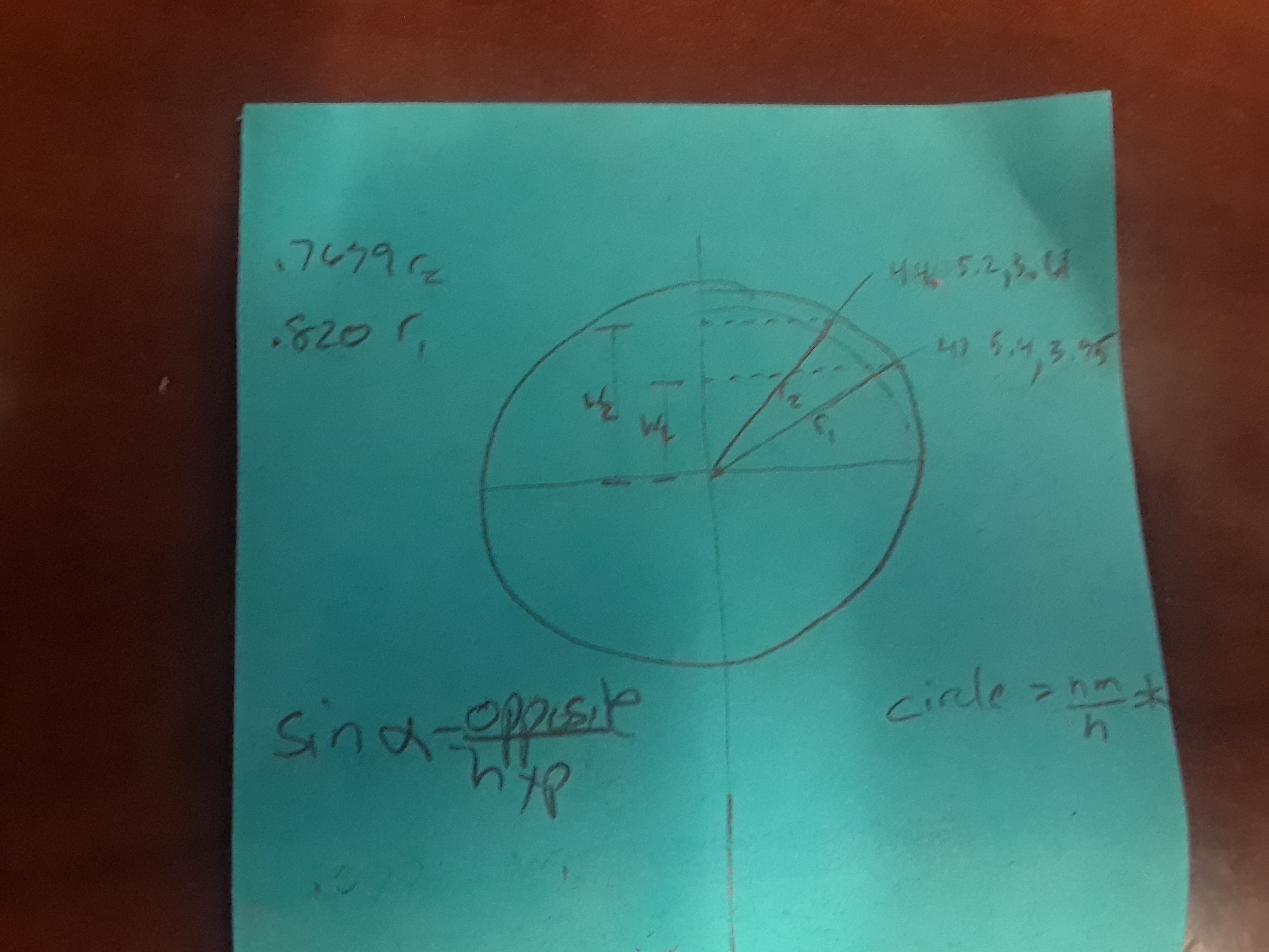

If you want, we can work some trig into this discussion.... ;^)
1) I'm sailing upwind at 44 degrees true, making 5.2 knots
2) I'm sailing upwind at 47 degrees true, making 5.4 knots
Which is faster to windward??

1) cos(44)5.2 = 3.74knots VMG
2) cos(47)5.4 = 3.68knots VMG
mariachee has a much better answer though: esp who is in the way. lol

Sail racing questions always assume the absence of other boats and wind/tide being equal. Else you could not even pose questions. But even so:
As long as you are going to windward and inside the laylines, it does not matter where the mark is.
We are talking about a 3 degree heading change. Not likely someone's going to be in or out of your way based on that!

yes, correct Jackdaw. AND I find Meriachee's answer entertaining, which I assume the smiley indicated as humor.
What is also interesting is a small heading change of 3degrees to gain boat speed really doesn't offer advantage, rather a disadvantage. I have not paid enough attention to VMG, rather trying to point as high as possible without pinching. It might be fun to play out some more scenarios when sailing.

perahps I am looking at it wrong? BobbyFunn, wind direction is x-axis, so angle off wind is between x-axis and speed vector. Thus the windward (x) component is ADJ/HYP = cosine
???? yes/no ????
OH, and I was on starboard tack, so opposite of your sketch....

perahps I am looking at it wrong? BobbyFunn, wind direction is x-axis, so angle off wind is between x-axis and speed vector. Thus the windward (x) component is ADJ/HYP = cosine OH, and I was on starboard tack, so opposite of your sketch....
???? yes/no ????
Awesome, thanks. For the sketch i have, i should have subtracted each angle from 90 degrees since i have the angles upside down
