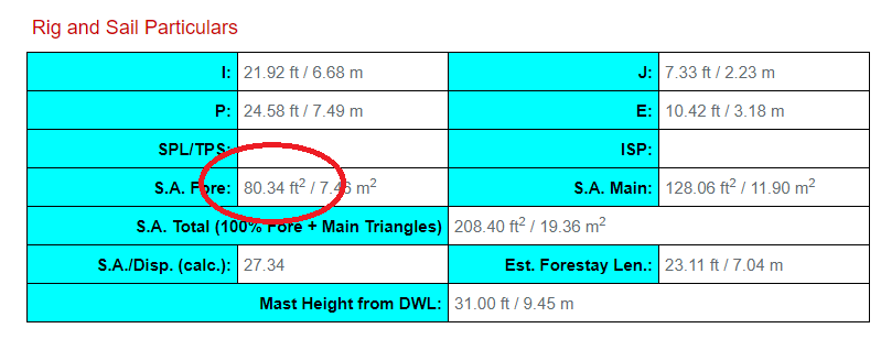

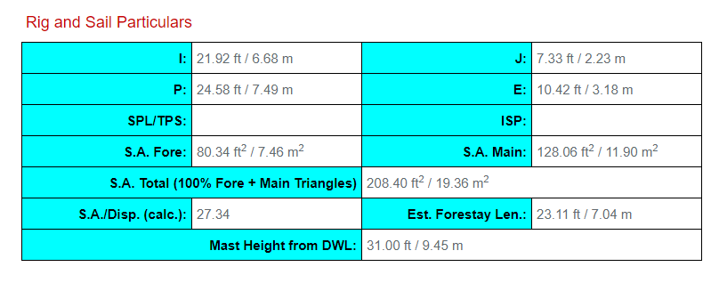

80.34 sf isn’t a sail specification. It is Nothing more than a number you get the when you multiply I and J.
I:
21.92 ft / 6.68 m
J:
7.33 ft / 2.23 m
I *J = 21.92 * 7.33 = 80.34 rounded to two decimal points.
And the mainsail isn’t really 108.06 sf either. It’s the product of multiplying P x E.

80.43 sf isn’t a sail specification. It is Nothing more than a number you get the when you multiply I and J.
I:
21.92 ft / 6.68 m
J:
7.33 ft / 2.23 m
The numbers are there, but they don’t represent sail area of real world sails.

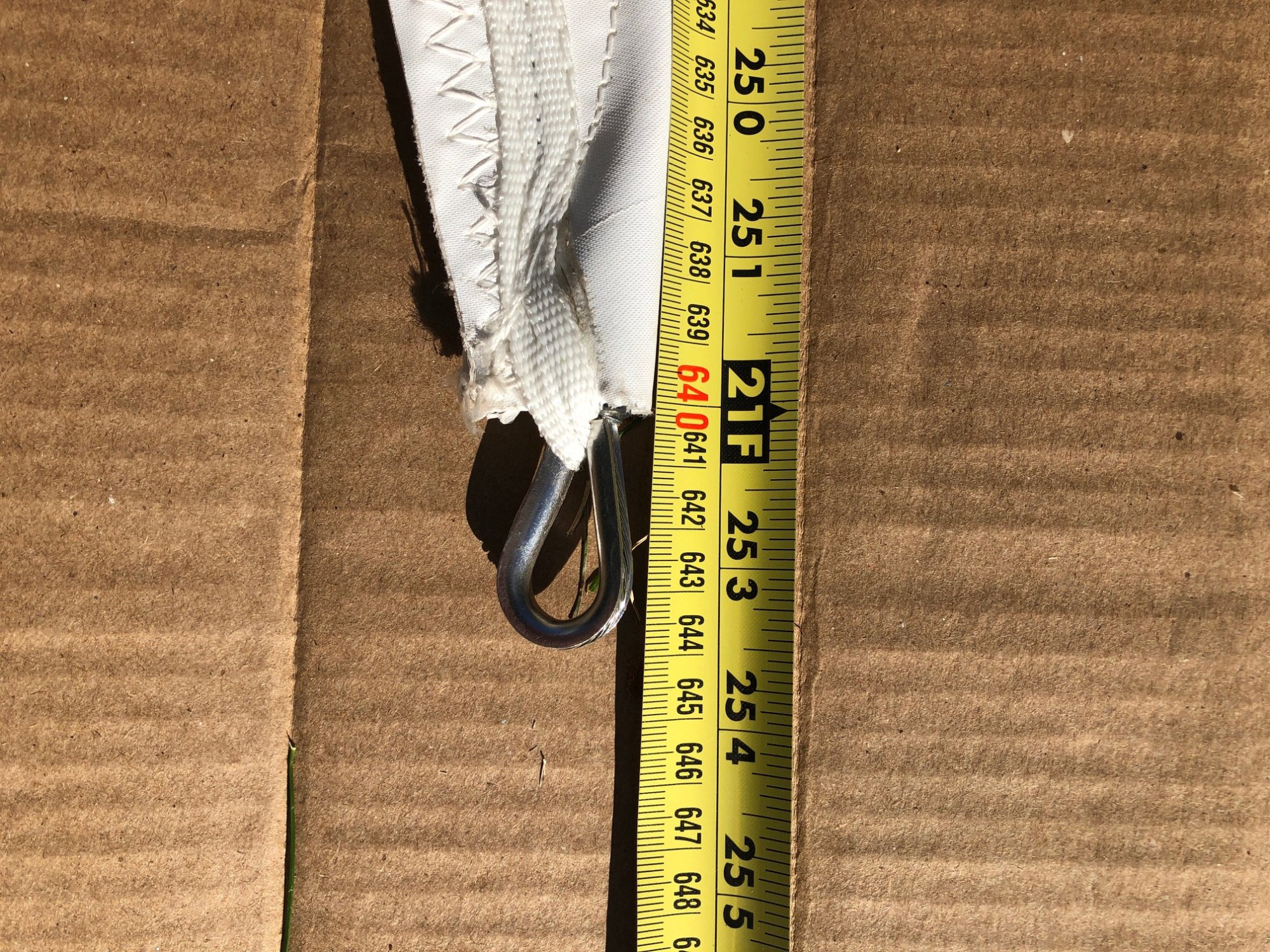

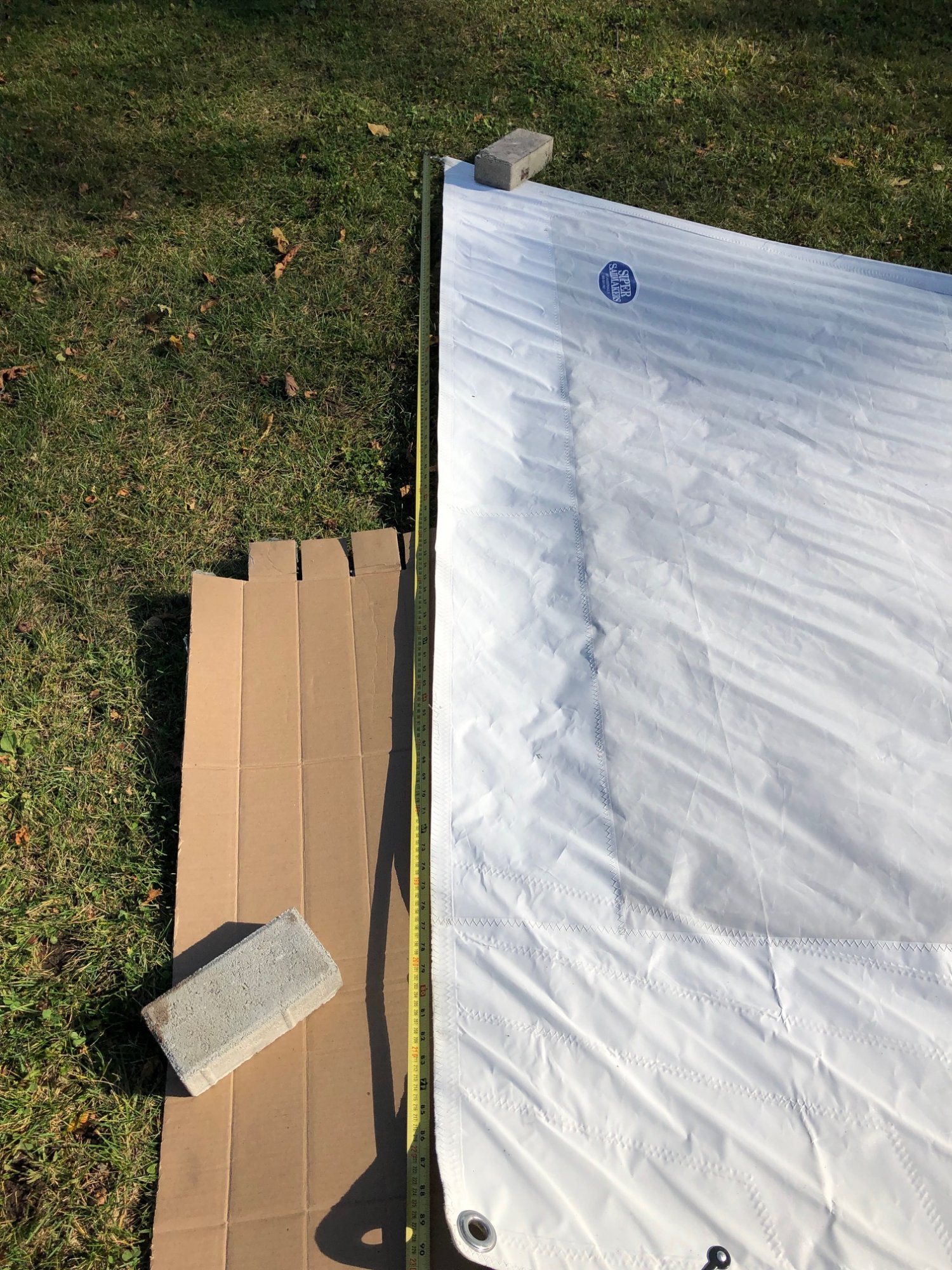

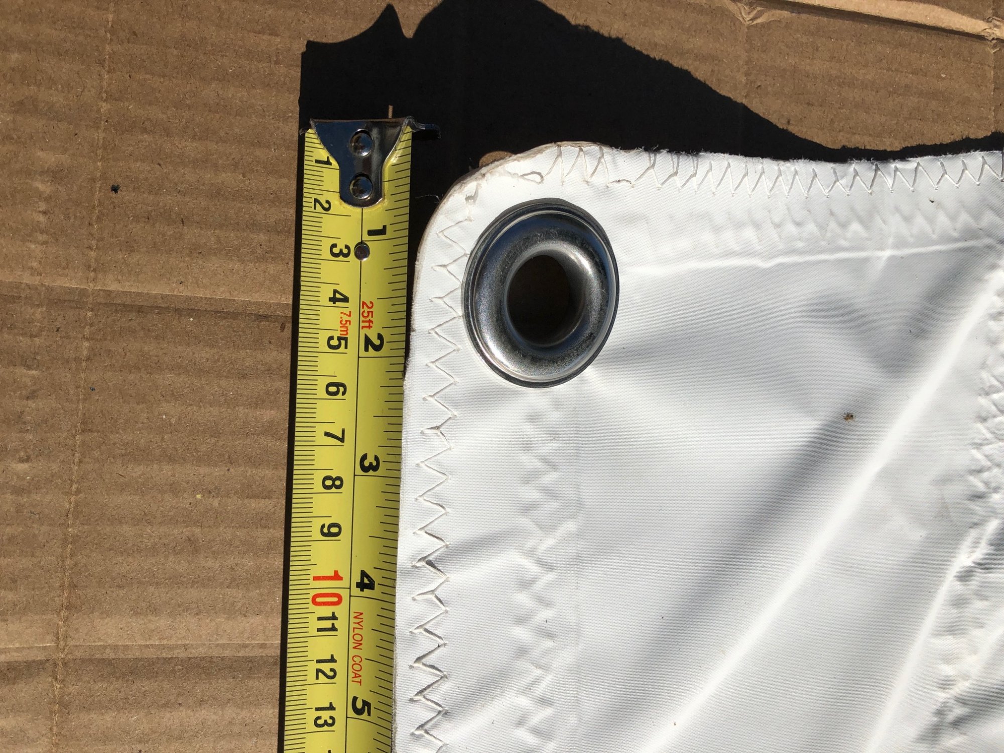

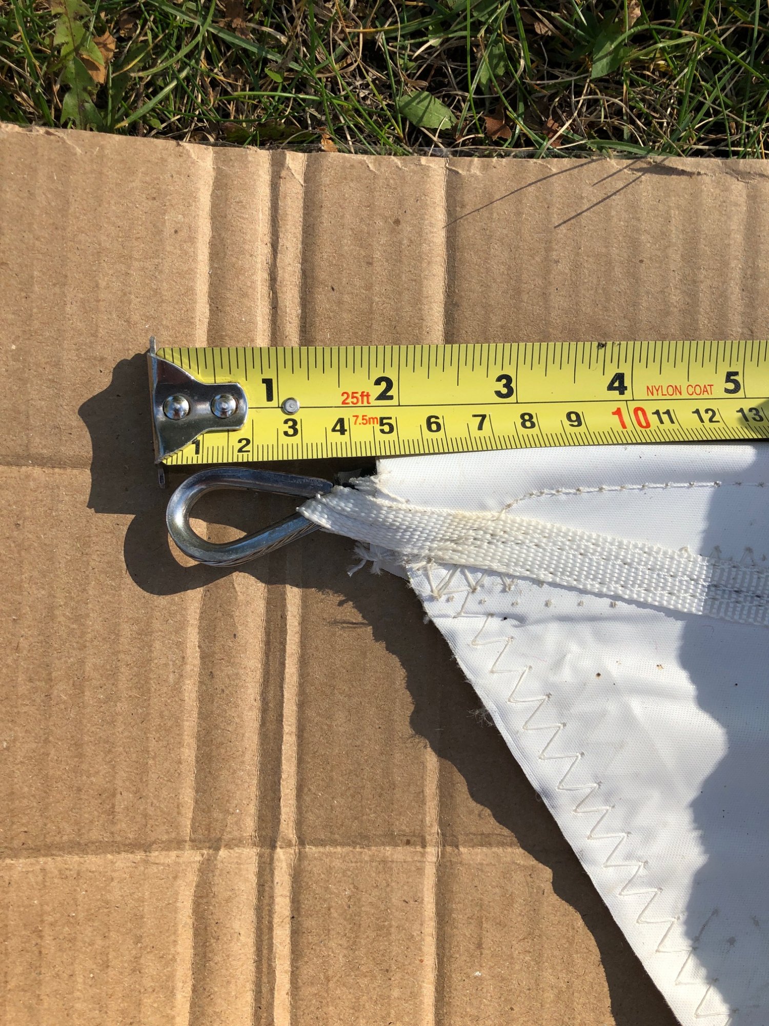

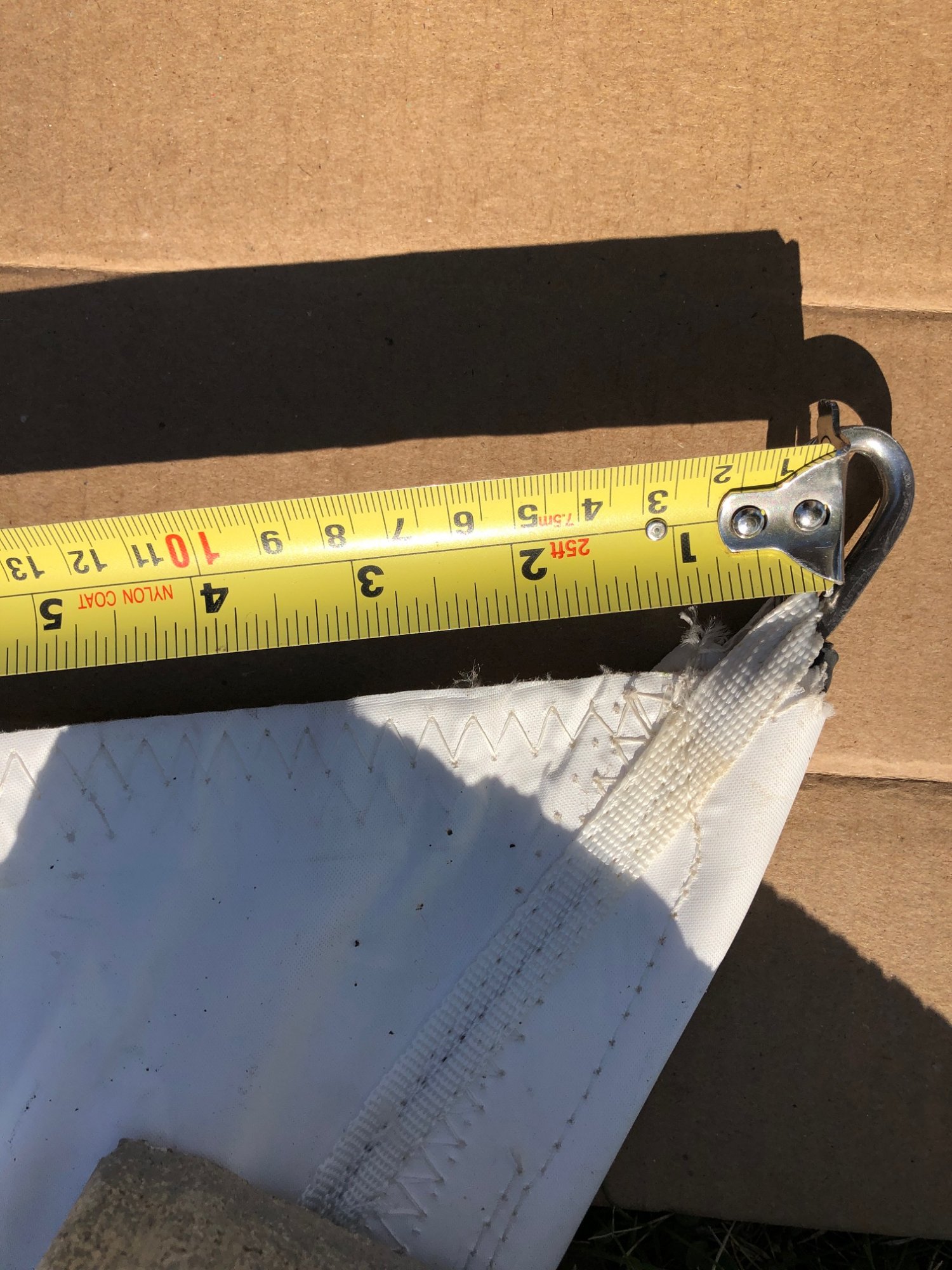

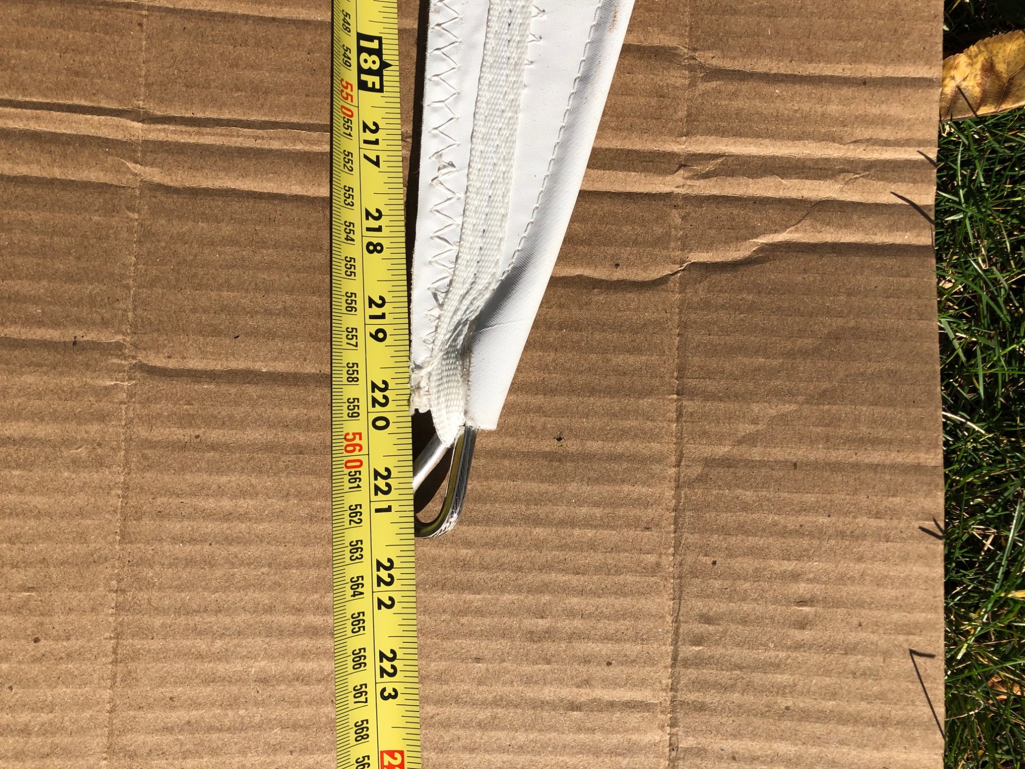

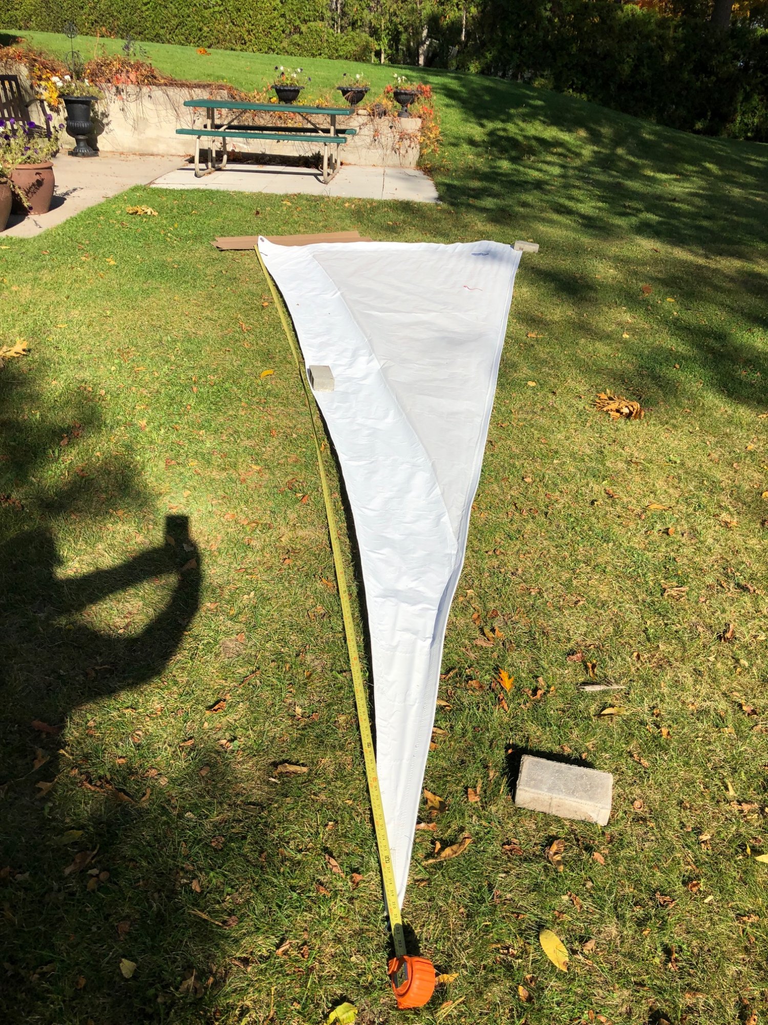

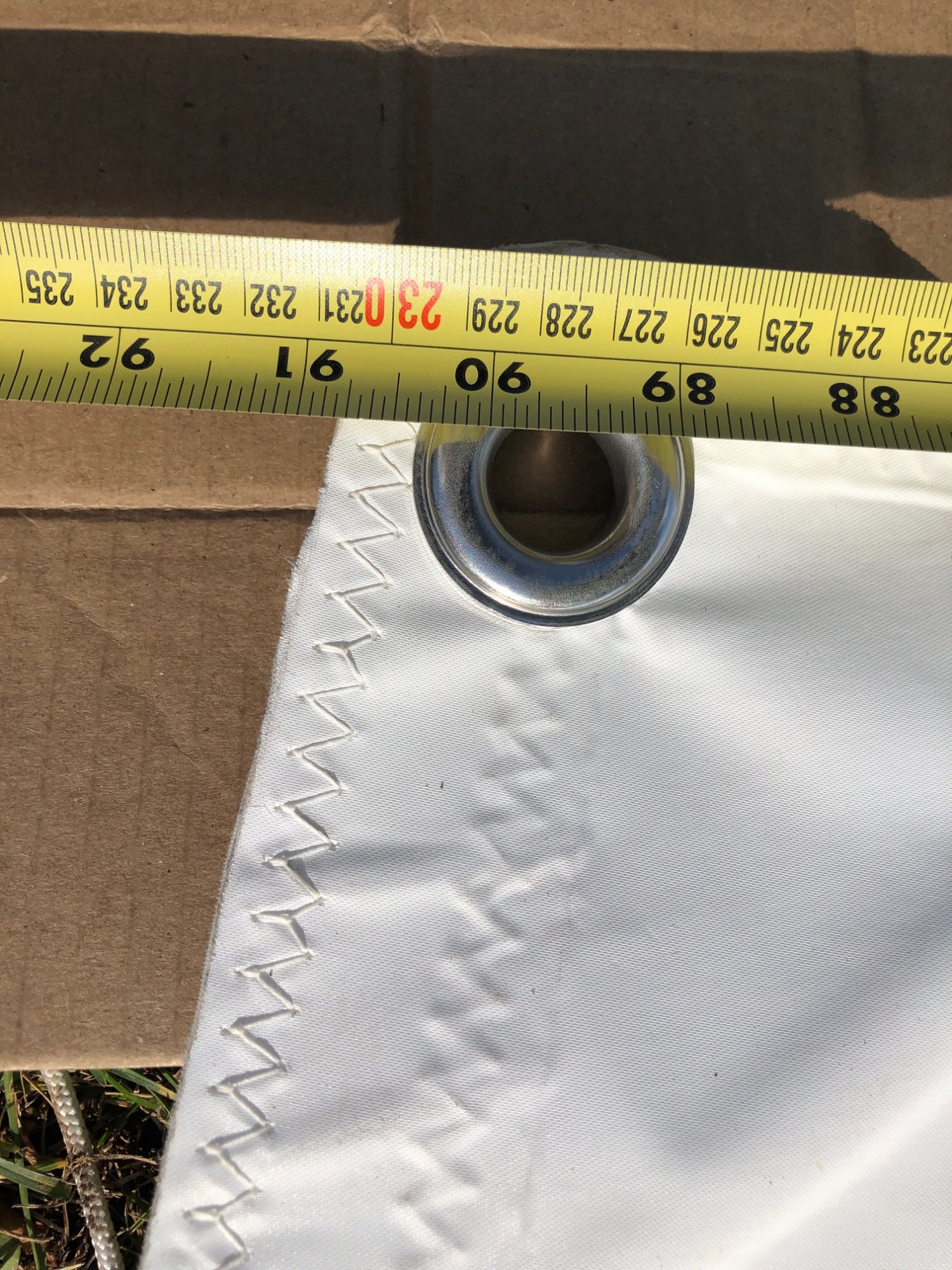

What I calculated is Luff=21' Leech= 18' 7" Foot= 8' 7 1/2 "
So of course, now I don't know how to advise the sailmaker.
I don’t think you have a choice on the length of the integrated stay which sort of drives the luff length, unless you want to alter the furler setup. The other two dimensions I “think” (I’m out of my depth here) create the angle the foot of the sail has to the upper decking on the boat. The “bulb” on the cuddy comes into play here. I guess the other factor those dimensions drive is how much the sail interacts with the main. I assume Glen Henderson the designer took all those factors into account a figured out a sail plan that was effective. Start changing the headsail will logically influence the main.
