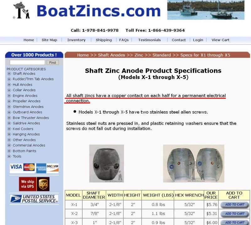

Last time I purchased zincs for the boat they did not have the copper contact balls I'm used to. We used to "set" our zincs with a hammer, supposedly creating a better bond between the zinc and shaft. Without the copper balls, I guess the hammer is of no use any more.
They seem to be working all right, but I feel like they just aren't the quality of the older ones.
The zincs with BBs are "Martyr" brand, made in China and are inferior, IMHO. A good anode doesn't need the BB to make good electrical contact.

The Camps I just installed had the BBs in them.

Only Cheap Martyr's .............................
........................ contain copper contacts ? ? ? ? These are Camps.
Good electrical contact is required, regardless of quality, and that's what the copper contacts are all about.

AFAIK, all Martyr brand zincs claim to be mil-spec. But they're also all made in China. My guess is the baby formula that the Chinese sold us that just happened to be laced with melamine was supposed to meet some quality standard as well. Whatever. I'm no super-patriot, but if I can avoid installing Chinese-made parts on my customer's boats, I will.
That being said, I do not like Martyr anodes for the following other reasons as well:
1.- Low quality attachment hardware
2.- PITA keeper rings on said hardware
3.- The whole copper BB thing. A properly designed anode with close tolerances shouldn't need a copper BB set in it to achieve good electrical contact, IMHO (and the best zincs don't.) The only other brand that uses BBs is Camp, and that my friend, is truly an inferior anode
4.- My primary zinc supplier (Svendsen's) no longer carries Martyr zincs. There's a reason for that and it isn't because they're such a great product
