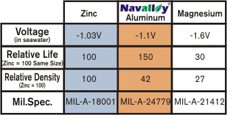

Some anodes in salt water can last longer than others, such as MIL Spec MIL-A-24779 aluminum anodes.

... Some anodes in salt water can last longer than others, such as MIL Spec MIL-A-24779 aluminum anodes...
I am wondering why there hasn't been more discussion about Aluminum/Indium anodes that were mentioned by Maine Sail.
I posted about a year ago about these as an alternative to traditional zinc anodes.

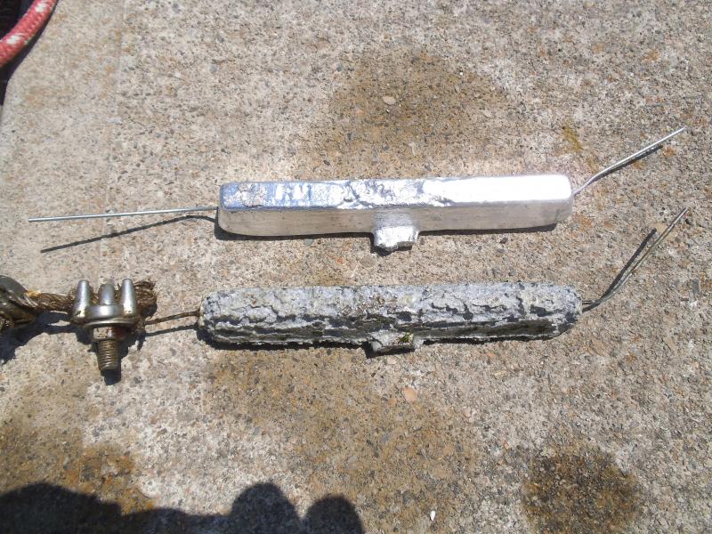

About the time of my posting, I was beginning a trial with a different anode regime. Learning that Aluminum anodes were a bit less noble than zinc (see the attached table and diagram jpg's*), I thought that maybe adding an aluminum fish anode, while at the same time still maintaining the zinc traditional shaft anode, would mean that the aluminum anode would sacrifice faster than zinc and so retard the depletion rate of the zinc shaft anode. Presumably, both would still protect my prop! I installed a shaft brush inside the boat to provide the least electrical resistance between the Al fish and the prop shaft. Also, I connected a fish pig tail lead to the engine block for good measure.
Six months later, I replaced the Al fish anode which maybe was down 40-50%. From visual observation, the zinc shaft anode still looked pretty robust. Prior to adding the Al fish, my zinc shaft anodes tended to last about 4-5 months and certainly were "thrown off" by six months if I hadn't asked a diver put on a new one.
Just two weeks ago, noticing a diver was cleaning my neighbor's boat, I asked him to take a hard look at my shaft zinc, now 11.5 months in service. He said that it probably had a couple of more months useful life left. Since he was at hand, I did have him put on a new shaft zinc. He left the 11.5 month zinc in place to be thrown off eventually.
So to me anyway, it appears that the Al fish anode is significantly retarding the depletion rate of the shaft zinc. For the Al fish anode, I am using ones sold to the crab/lobster industry for protecting pots. Cheap compared to shaft collar zinc + diver fees to install. He is a link to my purchase location.
http://www.rotometals.com/Crab-Lobster-Pot-Anodes-Zinc-or-Aluminum-s/41.htm
The other photo is of my six month Al/In anode next to a brand new one.
I await the backlash from forum members!

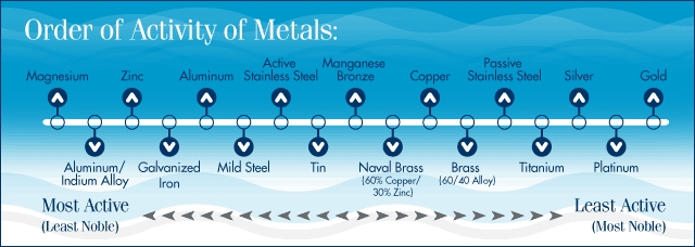

(* On the diagram attachment, observe the Al/Indium Alloy location to the left of zinc -- not the aluminum location which is to the right.)
