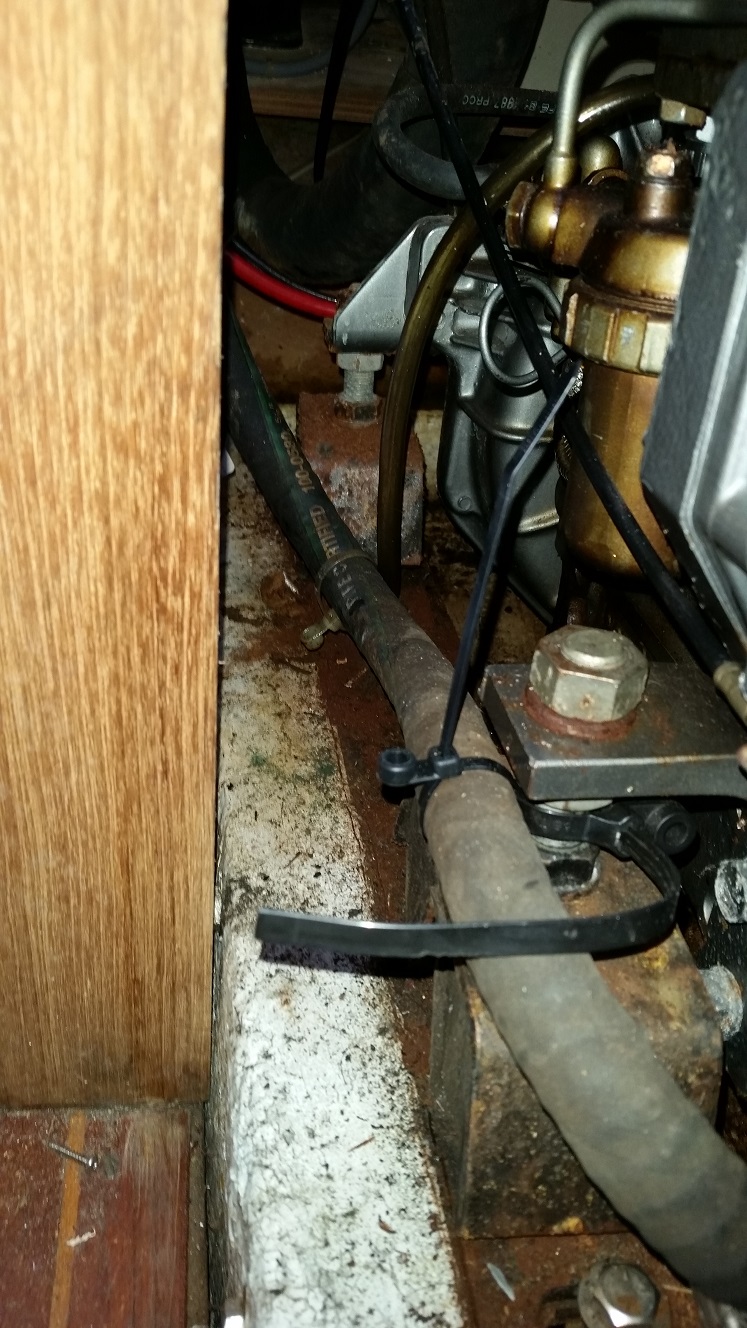

Does anyone know what the approx. cost of replacing (4) rusted Yanmar 3GM30 Engine mounts would be on a 1989 Caliber 33?
There seems to be plenty of engine compartment work-room to easily access the motor mounts.
Could I entertain doing this job myself?
Seems a leaky companionway sliding overhead hatchway has been leaking on the engine for some time.
I wonder if there is a possibility that there could be some bad wood around the stringer mounting screws as well and how one would check for that?
Thanks for your comments and advice.

Replacing engine mounts is not a big deal. Easy to do yourself. You can get OEM mounts, but there are other options out there. I was very happy with these. MM-Small-65 rubber - $35.00/each + M12 height adjuster $12.00/avproductsinc.com, http://www.anti-vibration-mounts.net/MM1.pdf. These work out to be just under $50 per mount which for 4 is about the cost of one OEM mount. There are other options out there.
Make sure you fix the leaky overhead hatchway first. There could be bad wood in the stringer but we do not know from your description. Do the mounting bolts torque down tight enough, then your are probably OK.

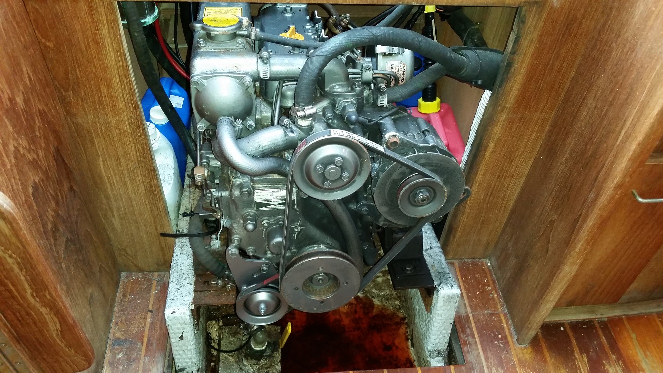

Ok, thanks for your replies...guess I will go with replacement Yanmar Motor Mounts.
Is replacing these motor mounts really considered a DIY repair?
If so, does anyone know how to do it?
I guess wooded wedges to lift motor, right?
What about the dreaded shaft alignment as a DIY project?
How?
