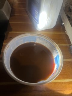

I use antifreeze 50/50 for my M25XPB 2001, I have no issues with over heating. Last year I started to see some rust colored water under the engine and eventually had a loss of coolant when I checked the manifold. I found that the fitting from the manifold which went to the overflow tank was clogged and the hole to the manifold was also clogged. I fixed these issues. I have drained the coolant from the drain on the Heat exchanger 3 times and it still comes out this rusty brown color. The coolant does not appear to be leaking. The coolant I use is a 50/50 mix color is green. I am guessing I have rust in the engine. The bottom line is I have no overheating problems. What would be any suggestions. It appears rusty looking antifreeze will still do the job cooling the engine. Any suggestions would be appreciated. Attached is a picture of the coolant color.

I hate to say this but any chance you've got a leak from the raw water cooling into the AF system ? That looks like pretty serious corrosion. Someone mentioned a test strip for NaCl in water a few days ago.
See post #2.
Once you're sure you have a sealed system, you would want to use a cleaning flush on the engine. Check the post archives for recommendations.

Pressure test the system to ensure it isn’t leaking after which you can flush with a rust removal acid bath but be cautious of the warnings associated with doing so.

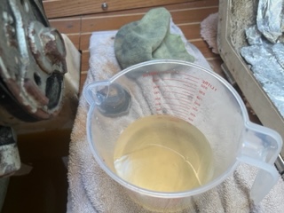

The heat exchanger which I replaced in 8-2015 from Mr Kool never had a drain valve after several trips to the hardware store I now have a drain valve which has a hose attachment so I can easily drain the heat exchanger. I am putting in distilled water and once it comes up to temperature I am draining it. It is not as bad as it has been, still some rust, I will post the next drain with a picture.

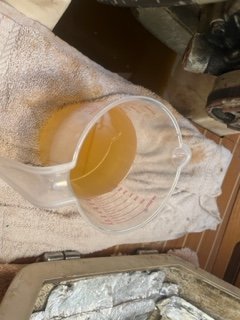

Here are the last two pictures of draining with distilled water to 170 F

That looks much better. You must have cleaned it.
