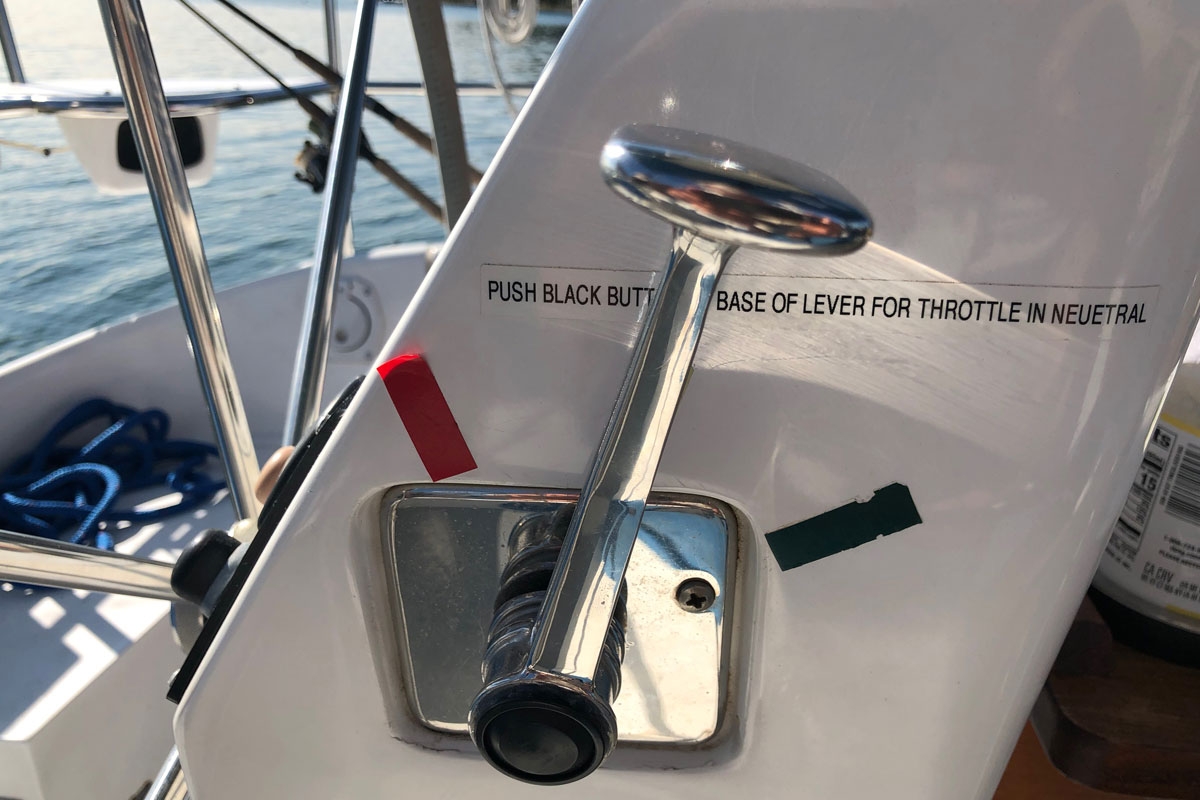

Hi folks. H386. How do you run up the throttle while not in gear? I seem to have no detent button on the throttle. TIA

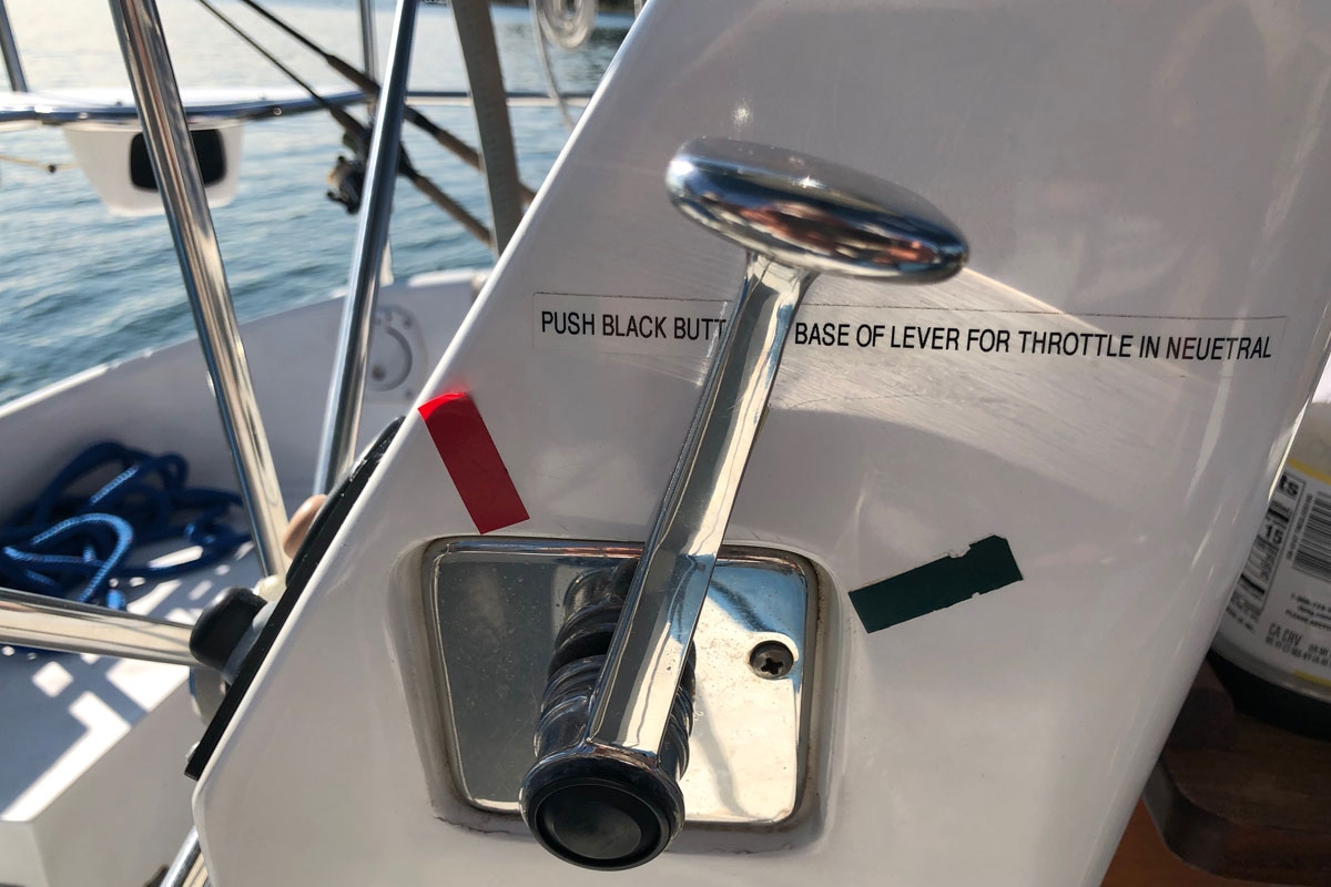

No button in the center of the gearshift/throttle?
Right.... The single lever throttles have a button to press that allows you to increase the throttle without engaging the transmission/gearbox. On my Hunter 38 it's a black button at the base of the lever like the one shown here. Press in (maybe firmly if it hasn't been used in a while) and hold while moving the lever forward.
The photo reminds me - I've operated a half dozen Hunter boats with these controls, and they drove me nuts because it was difficult to confirm that the shifter is in neutral as there is no positive detent for neutral. Your experience too...?

Some you pull the lever outward on its shaft and then in either direction for revs without gear.

.....H386. How do you run up the throttle while not in gear? I seem to have no detent button on the throttle...............
I also had a Hunter 386 and now 46. To run the engine rpm out of gear you to depress the black rubber button (with plunger) on the throttle handle. If you are missing one you can order a replacement rubber button and plunger from Lewmar Engine Control Mechanism | Lewmar

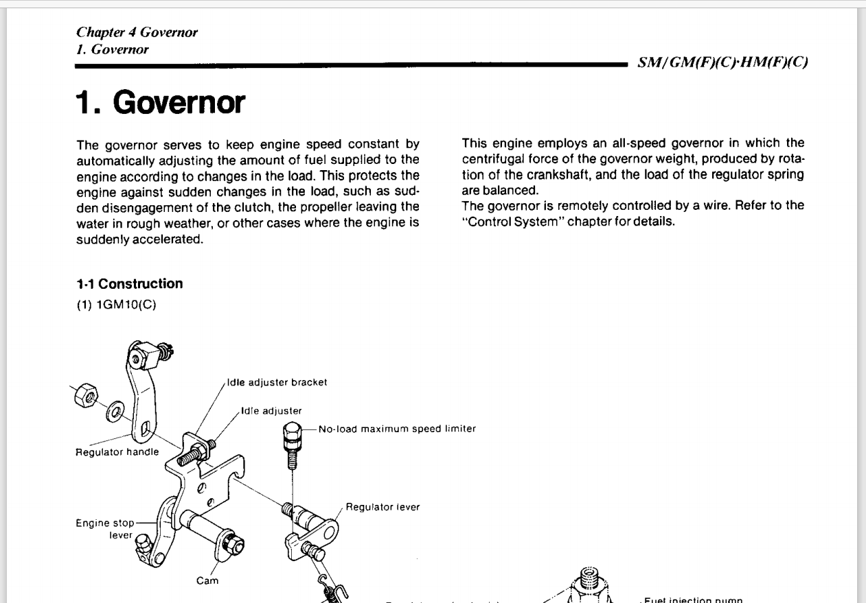

technically it’s not a throttle on a diesel, it’s a fuel delivery rate control,
That's about the closest I've seen here. The correct term from the manufacturer is called a "governor". It's purpose is to control the speed of the prop as it's coming out of the water and then digging back in when when in rough sea. When you increase the throttle, you are increasing the governor speed adjustment.
And rather than finishing up with the usual dumbass phrase of "that's a fact", this is taken from my Yanmar service manual.
