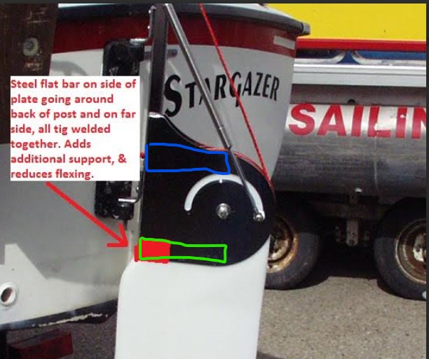

Well I tried to take a look at the space but I'd need much higher resolution images and some known dimensions. It looks like 5 or 6 mm of clearance at the top but the image is so poor I can't even guess down at the rudder connection.
Clearly I can't guess about how they do the attachments.
I will say, those pintals look pretty flimsy...

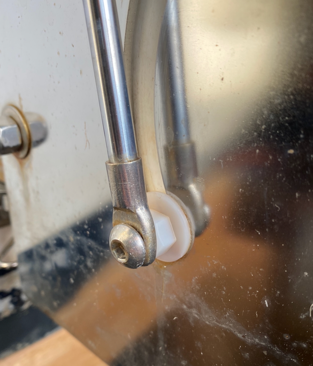

Q: How much space between the hydraulic shaft and the SS side plate?
A: Tight between the cylinder and the plate - maybe .1" or so. About .3" between the shaft (outside the cylinder) and the plate.
Q: How is the hydraulic pin attached to the rudder blade?
A: Good question - you can see the screw and spacer in the attached image, but I have no idea how it's anchored in the HDPE itself.

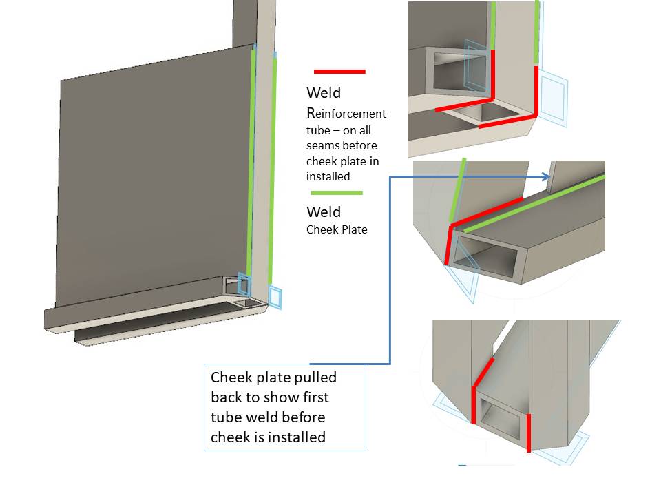

yeah, saw that in the Catalina post, that's why I was thinking to build my own frame thinking RC wouldn't want to do additional customization. I was wrong. I talked to Jeff at RC today and the bad news is he won't sell me just the blade the good news is he's open to modifying the design for extra strength. This what I sent him - a square tube along the bottom that will allow welding from all four seams and provide additional torsion/twisting reinforcement.
Since it seems I won't have a chance to build my own, I probably don't need anymore technical questions answered :-( I was SO looking to building my own frame - now if someone could teach me how to create that blade in fiberglass with like a 0015 NACA profile maybe I could totally DIY it - but really, with the time I'd have into it, buying one makes the most sense as long as I can get it how I want it.

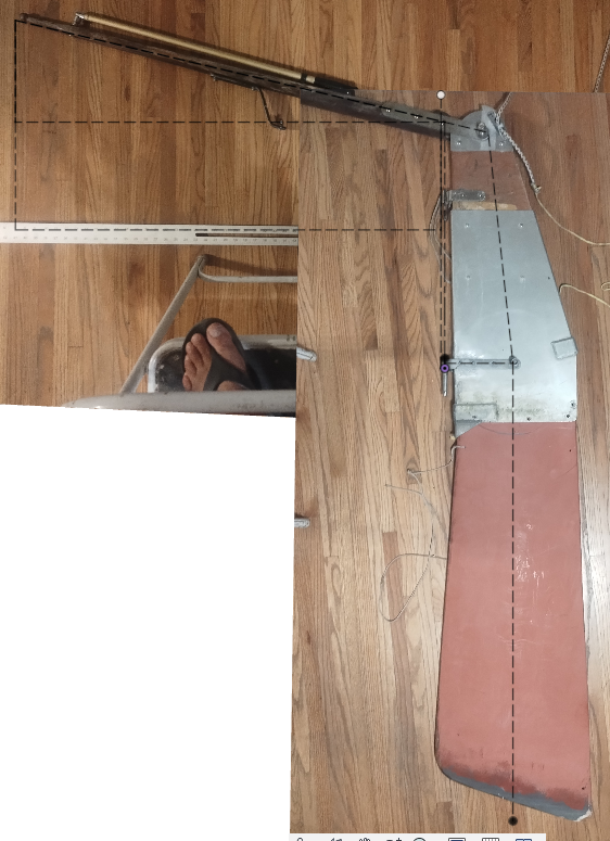

FWIW, this is the 50.4 lb monstrosity I'm replacing. The blade on this is SUPER heavy at 32.1 lb (the upper rudder is 13.3 lb and tiller is 5 lb)

@Paceship.org : I might be misunderstanding...but to me it looks like your design provides more secure cheek-plate attachment - a good thing, but the weld failures I'm aware of were the pintle pins themselves - see Andre's thread, and ask @Gene Neill and @AndreInPortland for their experience. I think we'd all love an improved design from RC, but especially one that would address the pintle failures.
Aug 23, 2023
35
Paceship PY23 Gulfport, FL (Tampa)

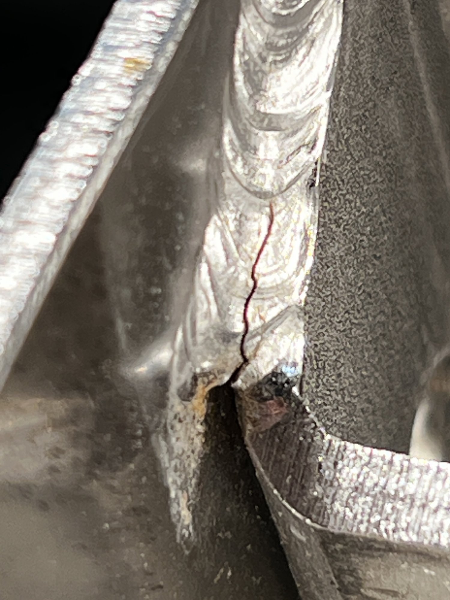

that is correct. it is a response to this cheek weld issue (also in the Cat 22 pintle thread) which is an impossible field fail/repair where as the pintle though not wanted, can be addressed with a spare on hand. Ruddercraft Lower Pintle Failure
I won't speak for RC on the 3/8 pintle issue (the explanation they gave me seemed reasonable) nd since I need 1/2" of which none have failed it is not an issue I hope to have to deal with.

I won't speak for RC on the 3/8 pintle issue (the explanation they gave me seemed reasonable) and since I need 1/2" of which none have failed it is not an issue I hope to have to deal with.
Mine were 1/2" and they failed spectacularly.

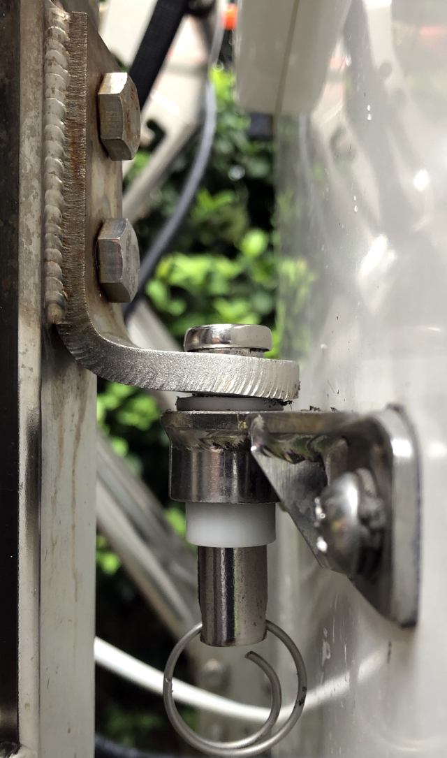

What modifications do you believe are required?

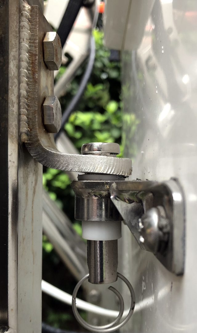

Remove pintles from their brackets. Drill the holes out cleanly.
Bend the brackets to 90 degrees (they are somewhat obtuse from the factory)
Bolt the brackets to the rudder frame and weld them in place. (mine repeatedly loosened over time)
Use clevis pins as your new pintles.
My brackets were already welded on when my pintles broke and the rudder fell off the boat, so I wasn't able to put the proper 90 degree bend on them.
  • Helpful
Likes: AaronD
Thank you. I saw your post/picture in the Cat22 forum but wasn't sure what all it tired to address other than a replacement pintle so thanks for the additional detail and the heads up on the loosening bolts of the bracket.
I see you have a bushing/sleeve/bearing (white) around the clevis pin.
I'm trying to resolve the pin size / bracket hole size / gudgeon size / pin spacer size relationship. If its on a Cat22, wouldn't the original pintle be 3/8" ?
What size is your gudgeon? 3/8" or 1/2"
What size is the replacement pin?
What size was the failed pintle? (if the failed pintle was 1/2" and gudgeon is 1/2" how did you remove a 1/2" pintle [leaving a 1/2" hole I conclude] and drill a smaller hole in the bracket to fit a smaller pin to allow for the bushing to fill a 1/2" gudgeon?

...If its on a Cat22, wouldn't the original pintle be 3/8" ?...
Catalina moved from 3/8" to 1/2" pintles at some point in the manufacturing run, and the switch to 1/2" is a recommended upgrade for earlier boats. I think Gene's boat is recent enough that it came with 1/2", and I swapped mine when I replaced my rudder.
The 1/2" gudgeons are a little oversized and accept a low-friction bushing - as seen in Gene's picture. (I'm too lazy to pull my rudder off now and measure the actual hole diameter in the gudgeon, but something ~0.6").
