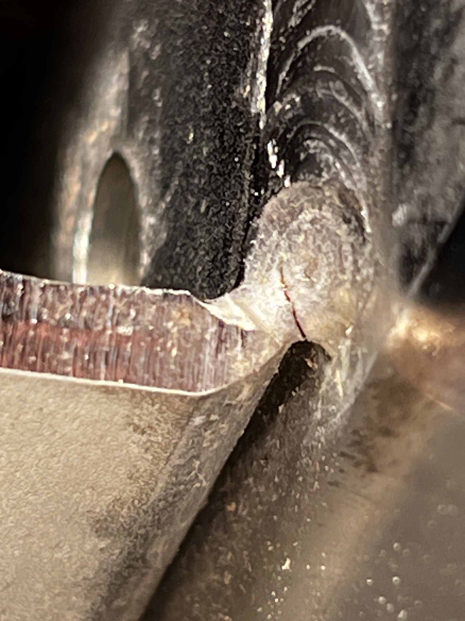

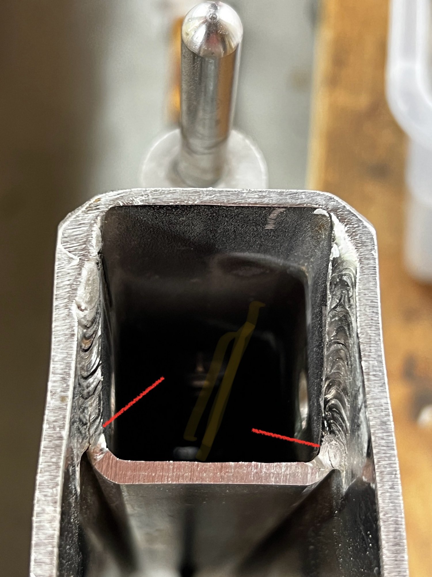

While you Ruddercraft guys are doing your off season inspections. Check the welds on the bottom on the vertical stainless tube below the lower pintle… this is what I found. Prob nothing, but I’m inspecting everything with this system.
Sep 15, 2016
844
Catalina 22 Minnesota
Might be time to call for a warrantee replacement.
Sep 8, 2022
52
Catalina 22 Green Bay
I spoke with RC, they recommend re-welding the cracked area. Not under warranty because I’m not the original owner. I could buy a replacement part or have it welded. I have the resources to weld it so I’m going that route.
I’m also working on redesign of pintle and gudgeon. Have mocked up in wood… next trip to the boat will check fits and clearances.
