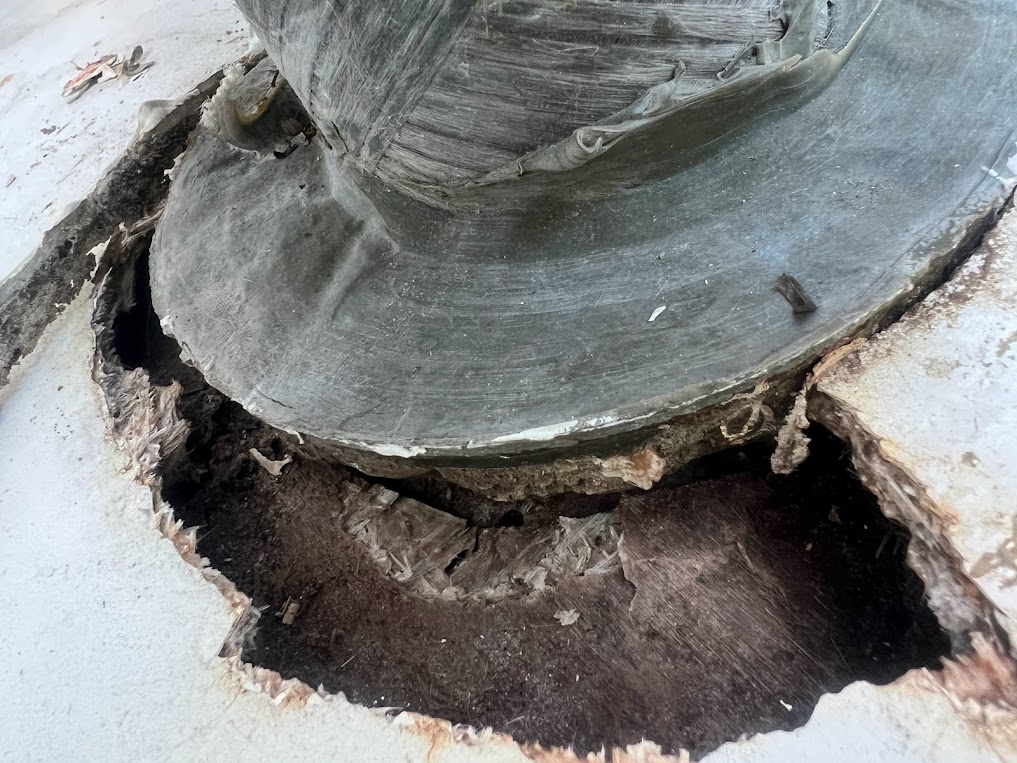

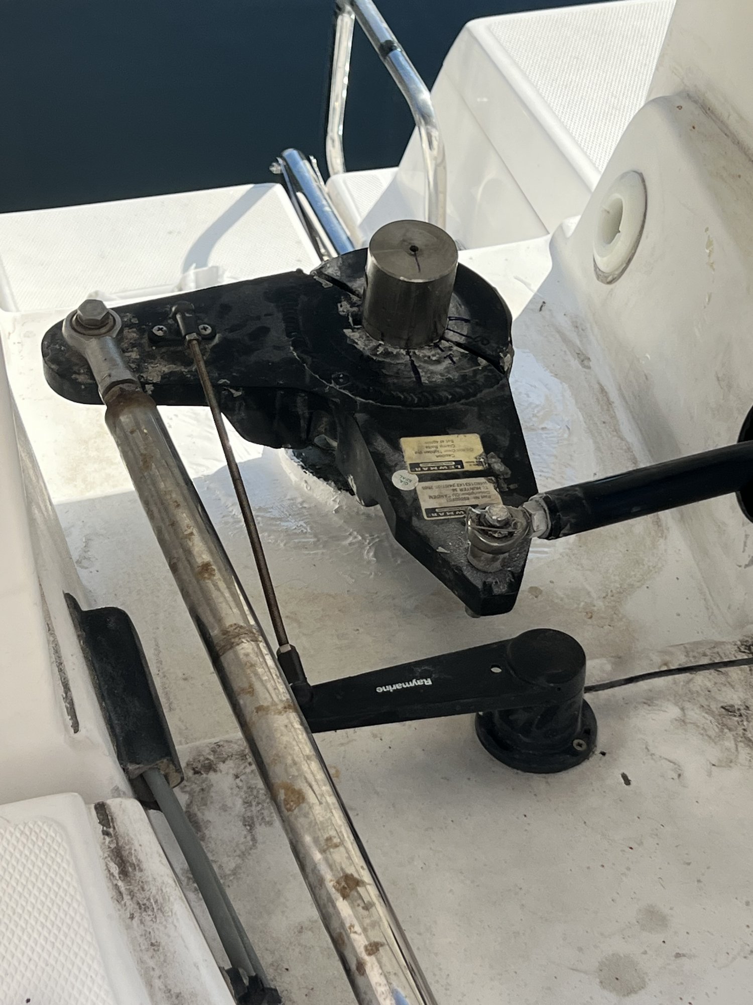

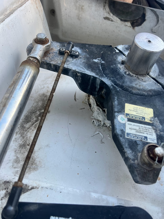

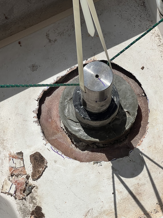

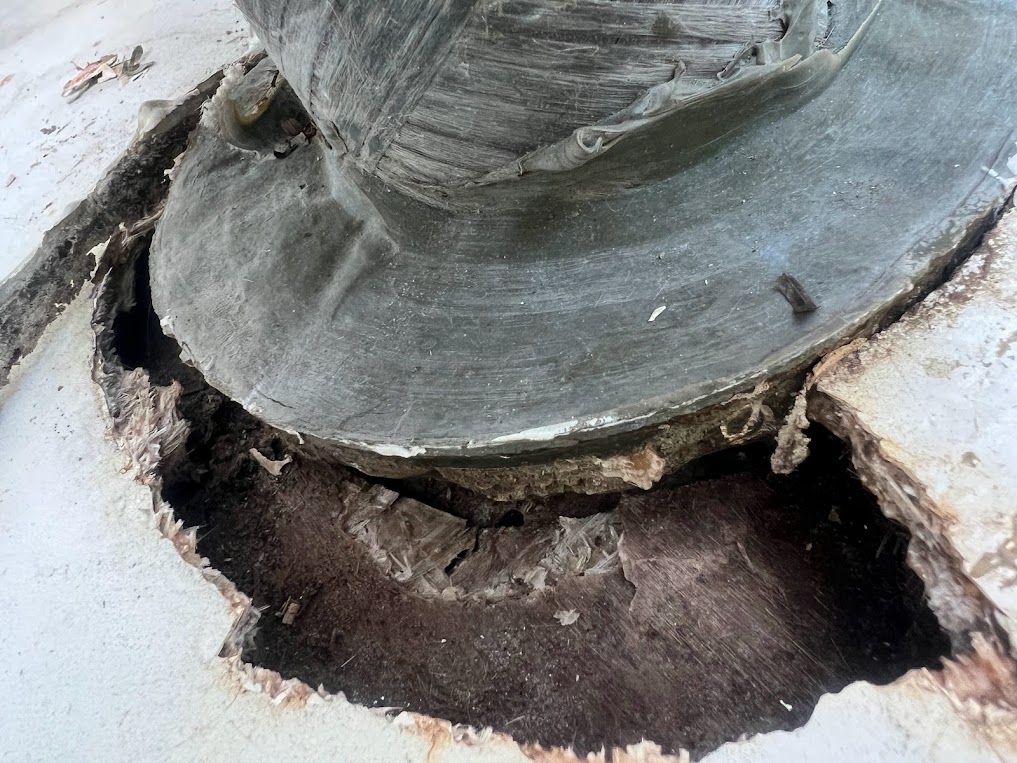

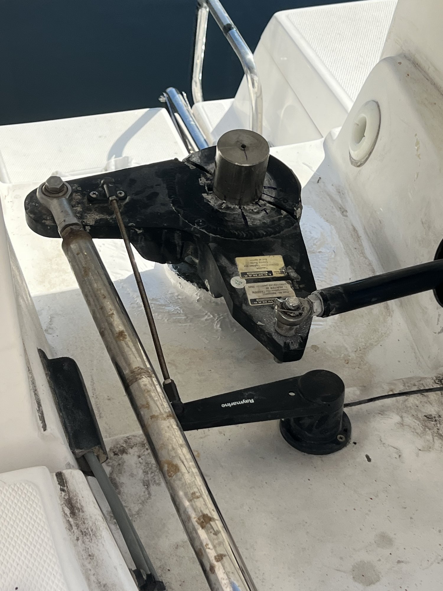

Hello guys, I am restoring a 2008 Hunter 36. I have realized that the Hunter 36 has lots of 'construction/projects hiccups' and I am trying to fix and improve as I get in contact with them. One that is very common, as per the internet, is the 5200 failure on the rudder tube bonding with the under deck. I came in contact with it once I was chasing leaks, and I had one on the rear corner of the cabin port side, which I thought it was from the Autopilot Hydraulic arm, and I came in contact with a catastrophic break, a loosened top tube part. And a terrible fixing attempted by the former owner: Here you will find the pictures showing the first stage of the repair, and as it progresses, I will update it here. Any questions, feel free to contact me.

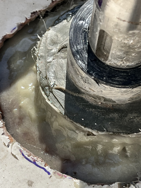

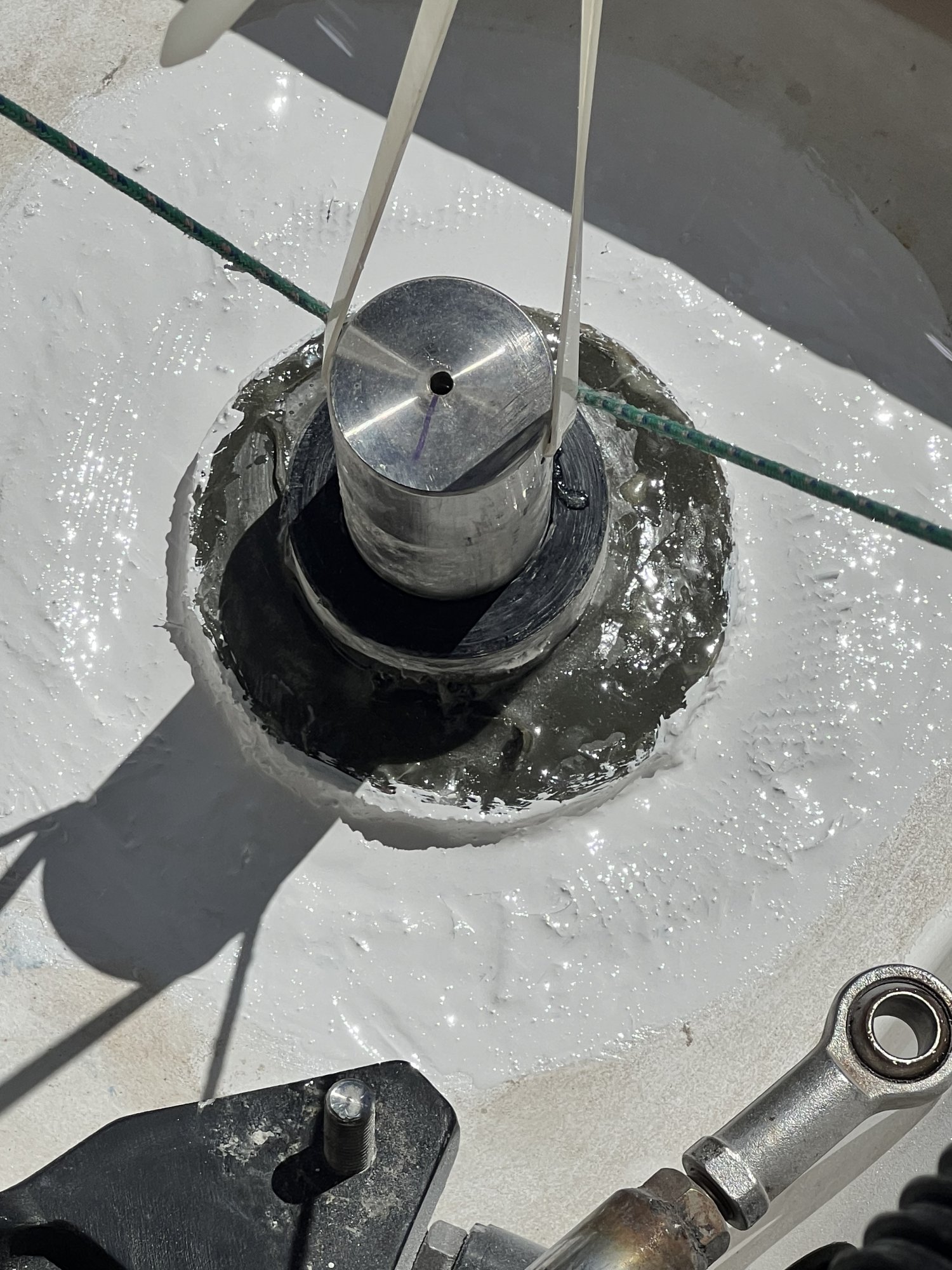

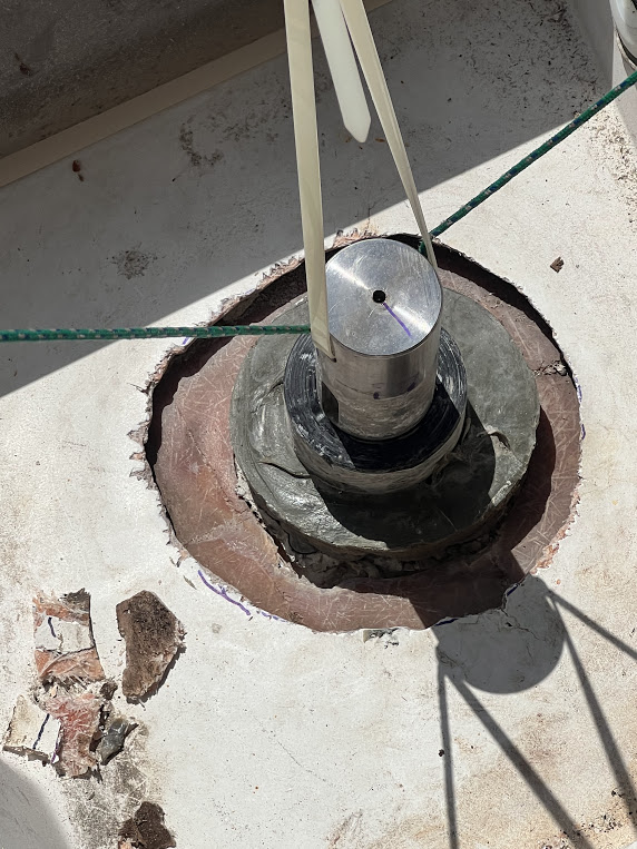

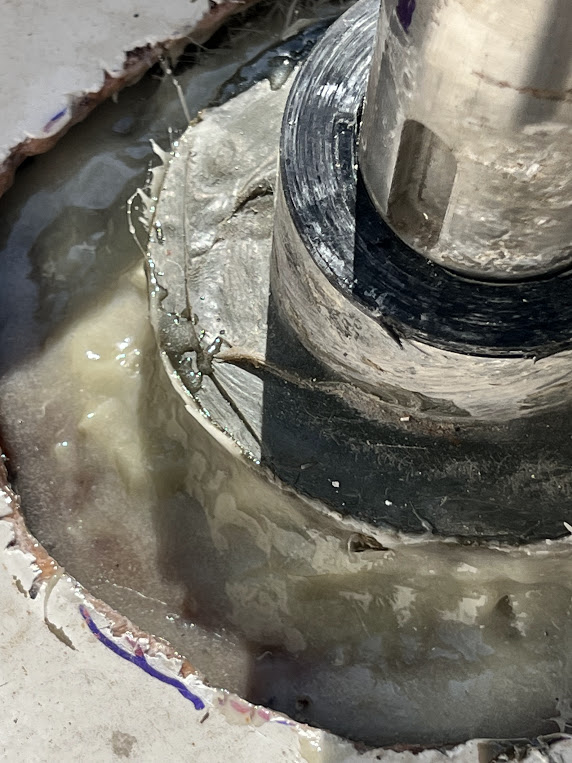

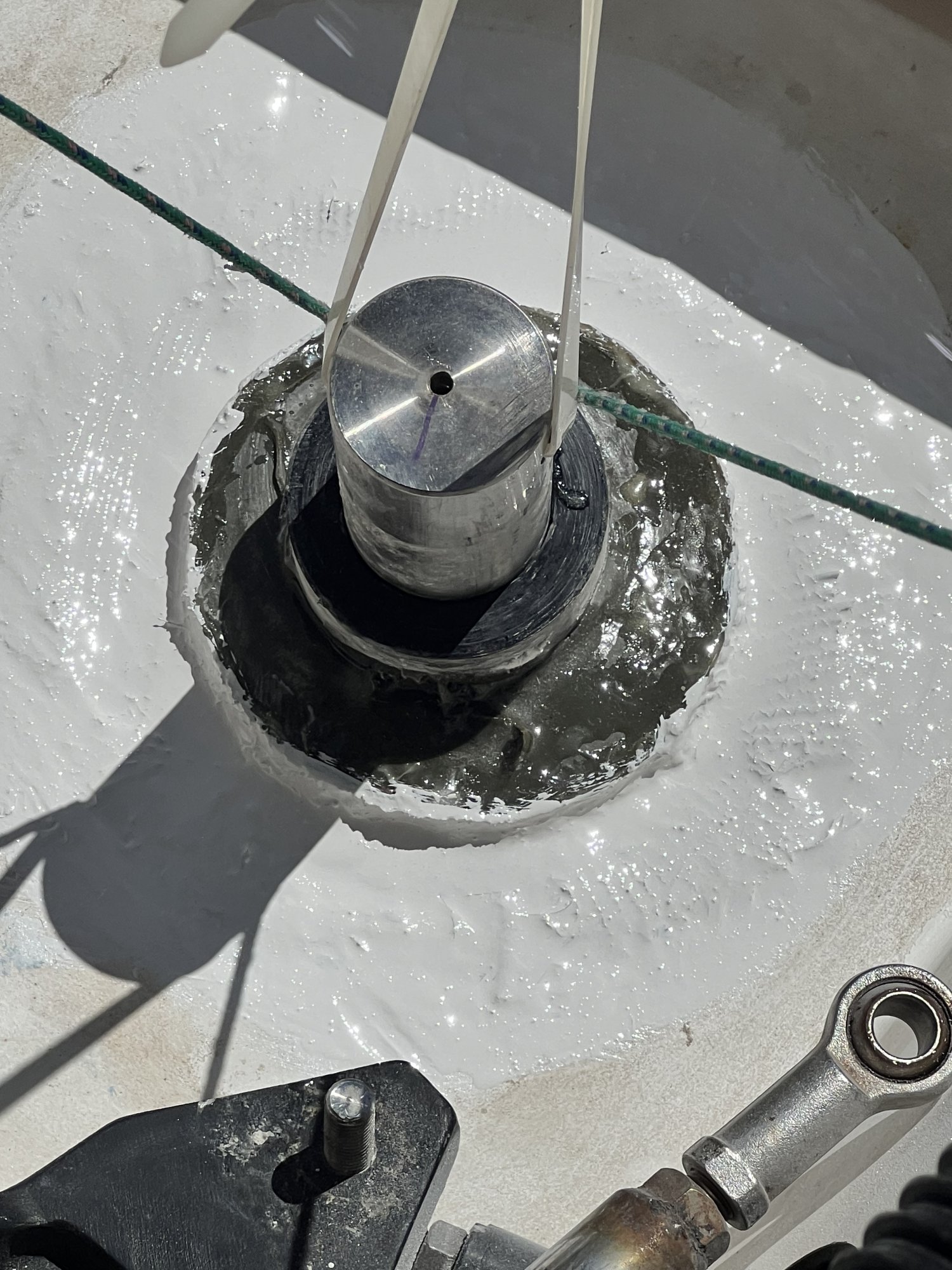

Access cut and clean with a mechanical wire brush. starting to bond it back with Epoxy and thickener. I am using the West System. Underneath the deck, top part has a hollow area before reach the tube post compartment. There is no workable space in it, not even from the rear cabin. I realized after I popped something in my spine. I am almost 6.2.

I am thinking maybe that boat had a very bad grounding and the rudder was also damaged.
:plus:
Perhaps a flood victim boat. Raised up on the surge, shifted in place and dropped hard on the rudder. James knows about such happenings. Not thinking it was bad design by Hunter. The designer likely never considered the boat would be lifted and dropped on the rudder. It would not be a normal use.

@skipperclaud, That makes perfect sense to me. It is a nice act you are sharing. Your attached image in message #8 looks a whole lot better then the before work images.
