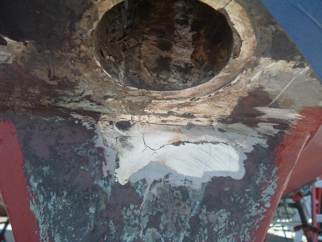

I repacked mine only to find that it was the hull itself that was leaking(picture). Probably from the grounding that bent my rudder stock.

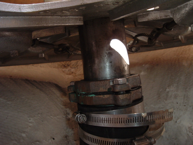

Meanwhile here is one link that shows the packing gland much like mine. Under the packing gland on my boat is about six inches of very heavy hose, like radiator hose.
http://www.c34.org/faq-pages/techdata-rudder-packing-gland.html
And is mentioned in the text of the link, most packing glands are above the waterline except when motoring(squatting). That is why mine leaked, it was not the packing but six inches lower where the cracks existed.

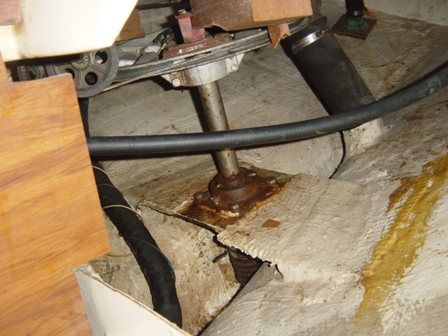

Found pics: top of stuffing box and bottom(with cracks visible).

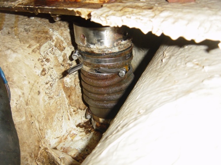

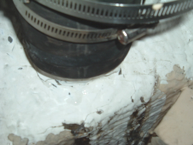

Here are a couple of pictures of what my 33' has on it. Maybe someone can tell me what I am looking at and how, if at all, I add packing to this while in the water. My major leakage is around the top of the rubber bellows.DSC08416.JPG

Geez, see what you mean! I have been sitting here comparing your pictures with the ones that are in the first link I gave you. The two are really different. Ken's has no hose of any type. And his pictures do not show that lower collar, actually a bearing to keep the rudder from floating up. And you say the leak is from the top of the hose, right above that top clamp?
Have you had someone turn the wheel while you are watching that area? The big collar should turn but the metal under the clamp should not. That collar looks like the same thing they use on the PSS dripless shaft seal. Could it be that there is no packing gland? Instead you have one of those magnetic seals? Maybe that is where the water is from instead of from under the hose?
Yep, more I study that picture the more I am convinced that you have a PSS shaft seal for a rudder stock. The bellows is what provides the tension between the two sealing surfaces. It has probably weakened . The normal fix on a propellor shaft is to move that big collar down. I think it just takes an allen wrench. If the bellows is shot then yes, the rudder has to be dropped.
Dec 2, 1999
15,184
Steve/Ed:
It would seem to me that the two hose clamps should be right next to each other.
I would try lowering the bellows and making sure that there are smooth surfaces all around that top fitting. Then try to get the bellows as level as possible and as high as possible. Tighten the top one and move the lower one right next to the top one.
Jun 2, 2004
5,802
Not following you Steve. Doesn't the bottom of the bellows need to remain at the bottom, on the strongest part of the hull stub? Then to get more tension on the bellows that big stainless collar has to be moved down. Or maybe that's what you wrote.
Dec 2, 1999
15,184
Ed: I was suggesting that the bellows are straight (looks like they are slightly cocked).
When the bellows are properly positioned the two hose clamps should be butted right next to each other.
I would just be sure that there is nothing under the bellows or on the stub (at the top) to prevent a perfect seal.

You are both right. The lower of the top two clamps is loose in the picture as it had slipped off the surface and was causing more leakage. I will first have someone rotate the rudder and see what happens and then I will try to lower the upper collar with the bellows attached and see what happens. I thank you all for the help and I will let you know what happens.

OK - it is still leaking. I would hope that someone out there would know exactly how this setup works because every time I mess with this thing it starts leaking more and the nearest travel-Lift is about 2 hours away. I really do appreciate all the input I have received so far. I just do not know how to proceed without getting in a position where I cannot stop the flow of water.

To replace the bellows will require dropping the rudder which also involves removing the steering drive wheel, so a haul out seems inevitable. I suggest that in the meantime you remove the two clamps, wrap the whole bellows really well with self-amalgamating tape like Tommy Tape and then put two new clamps back on. I know the access is difficult but you certainly don't want it to get any worse, and as you said, you are a couple of hours away from a lift.
