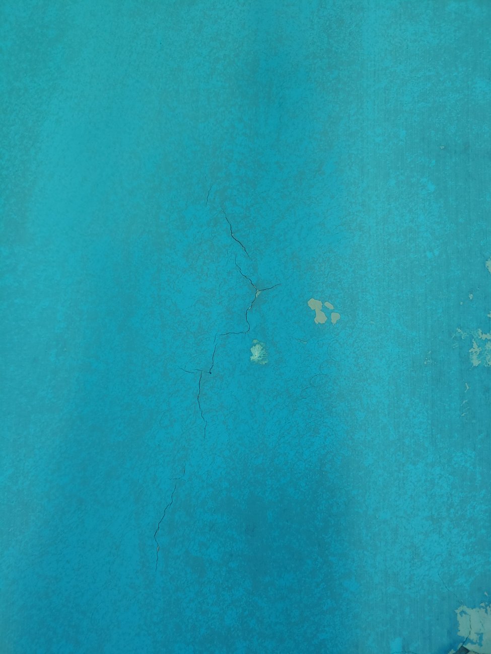

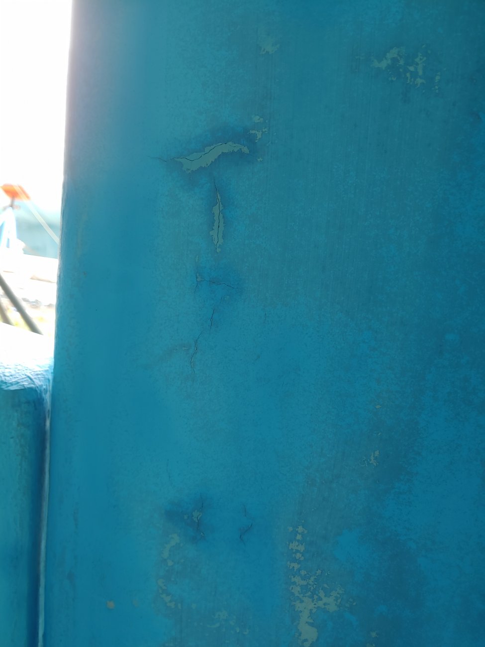

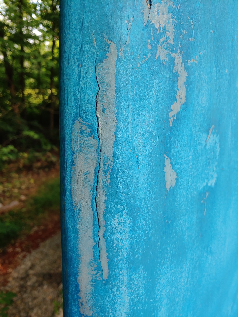

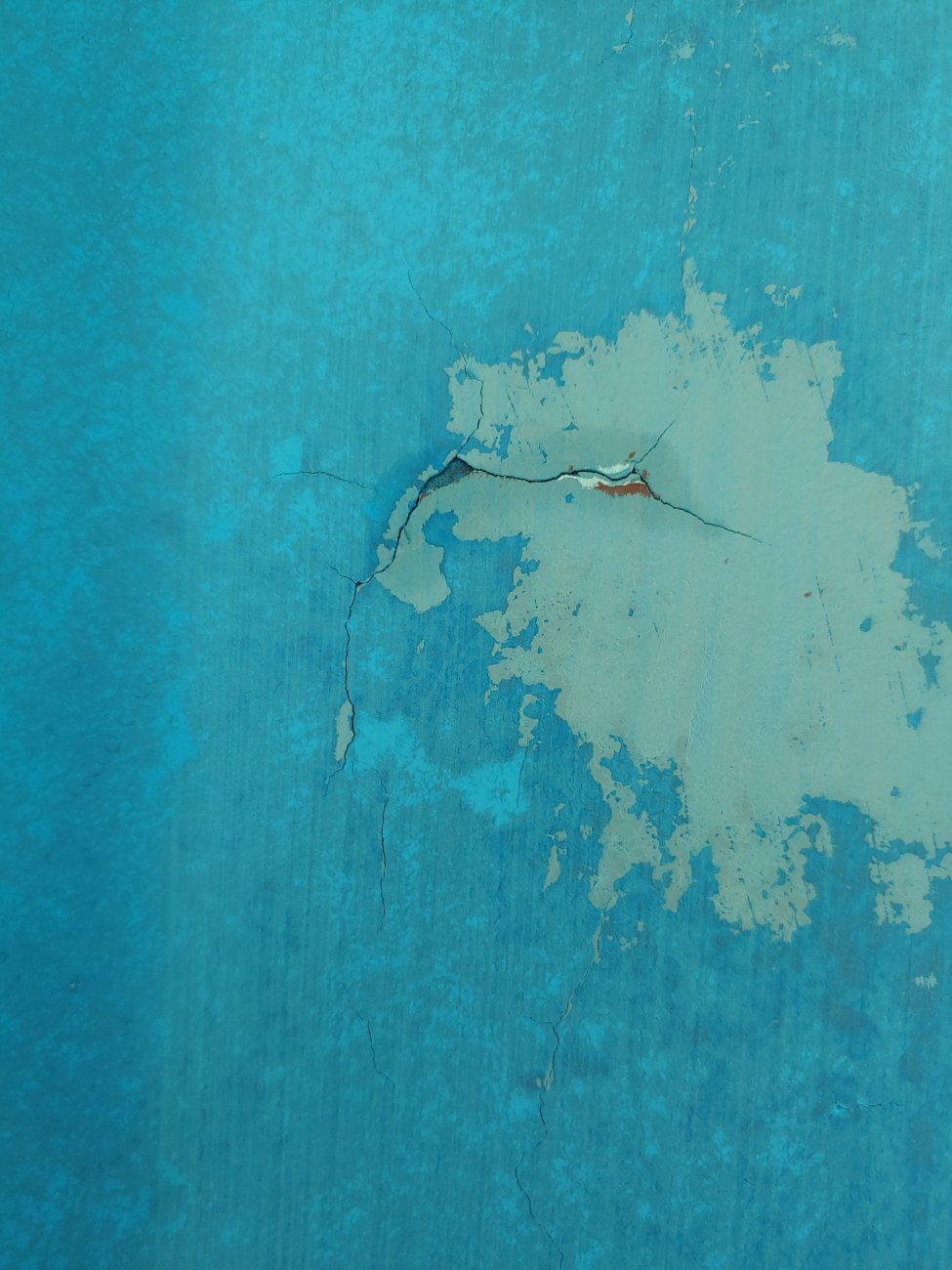

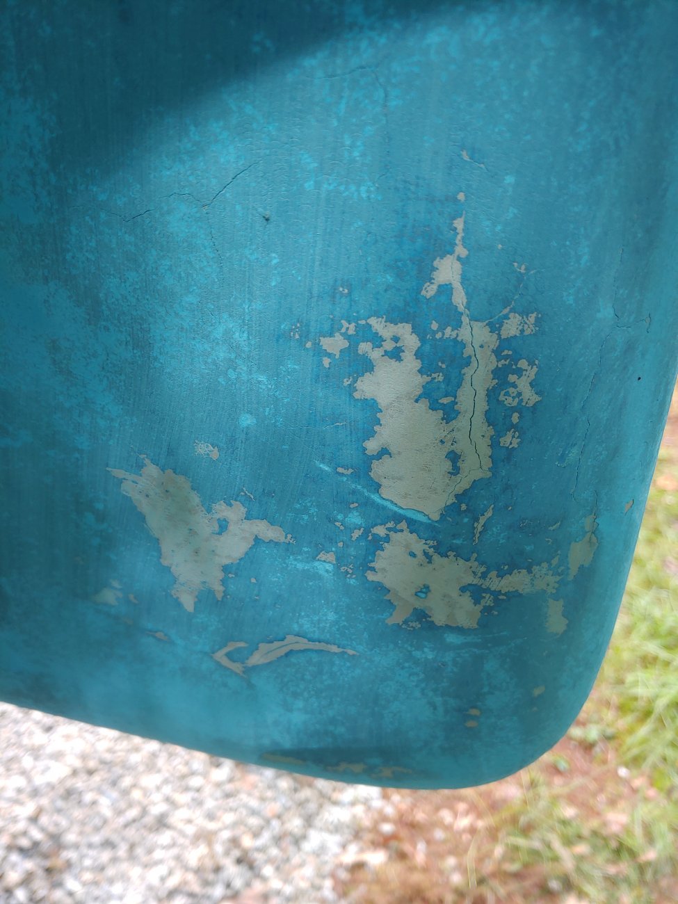

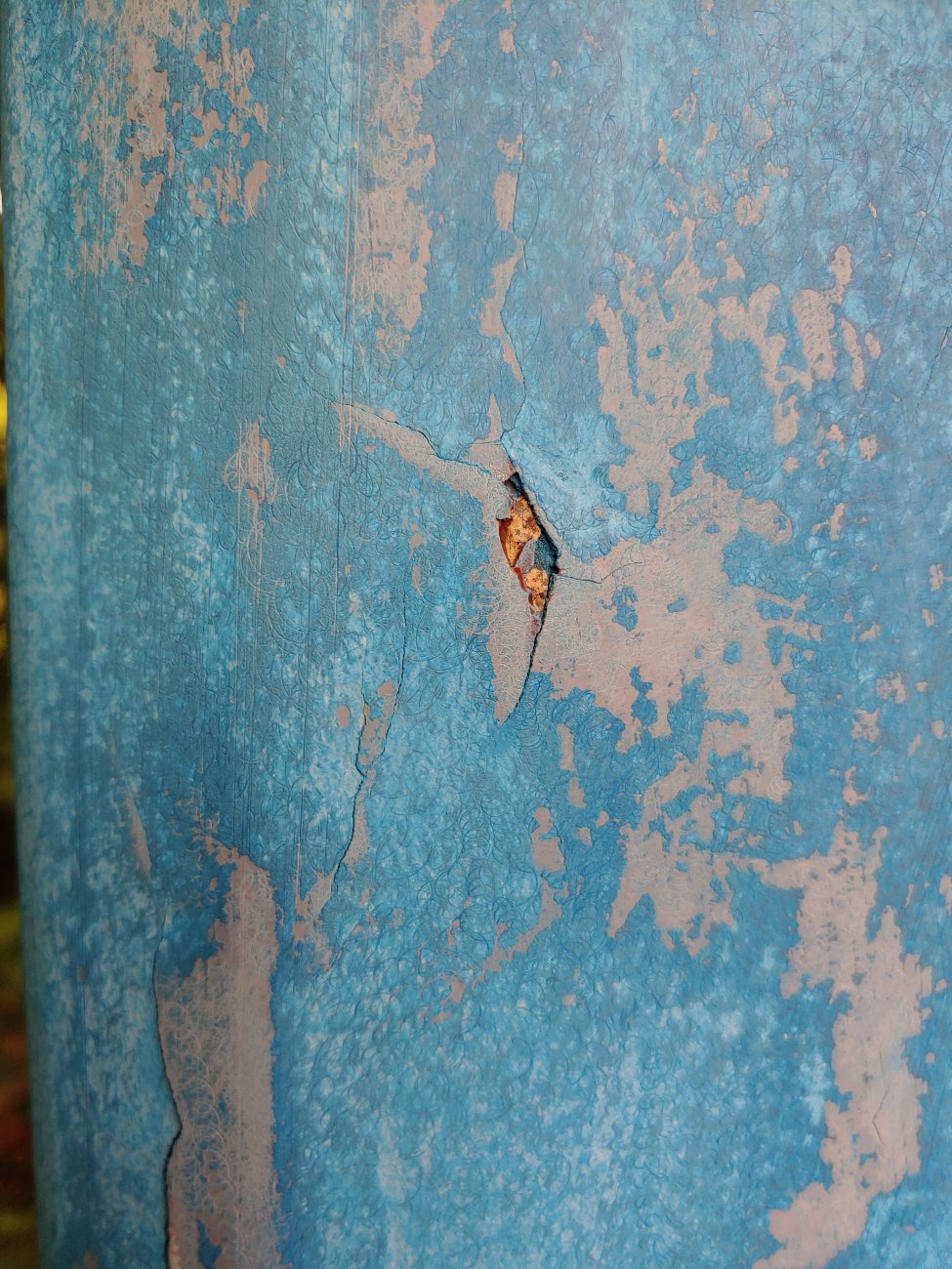

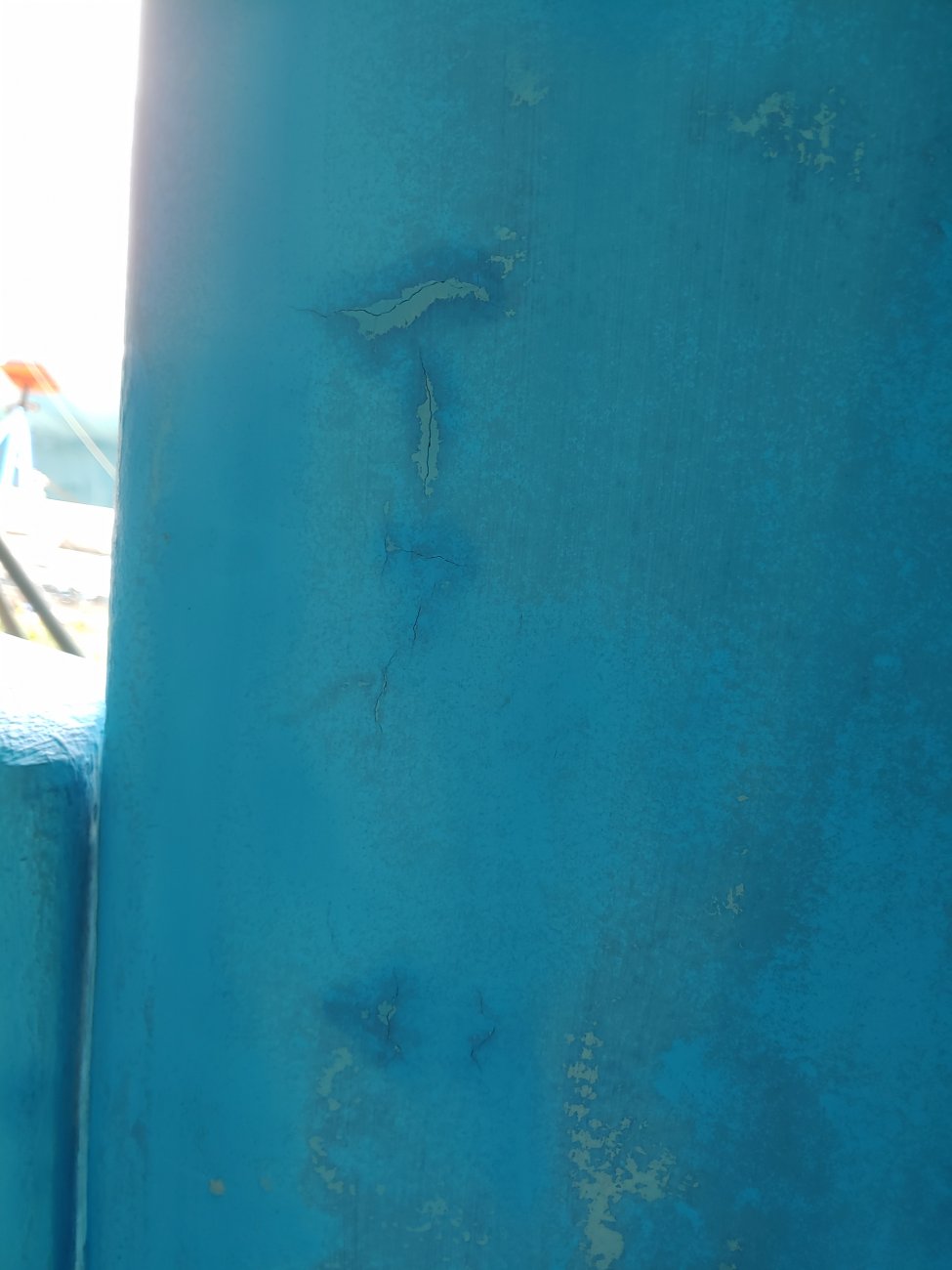

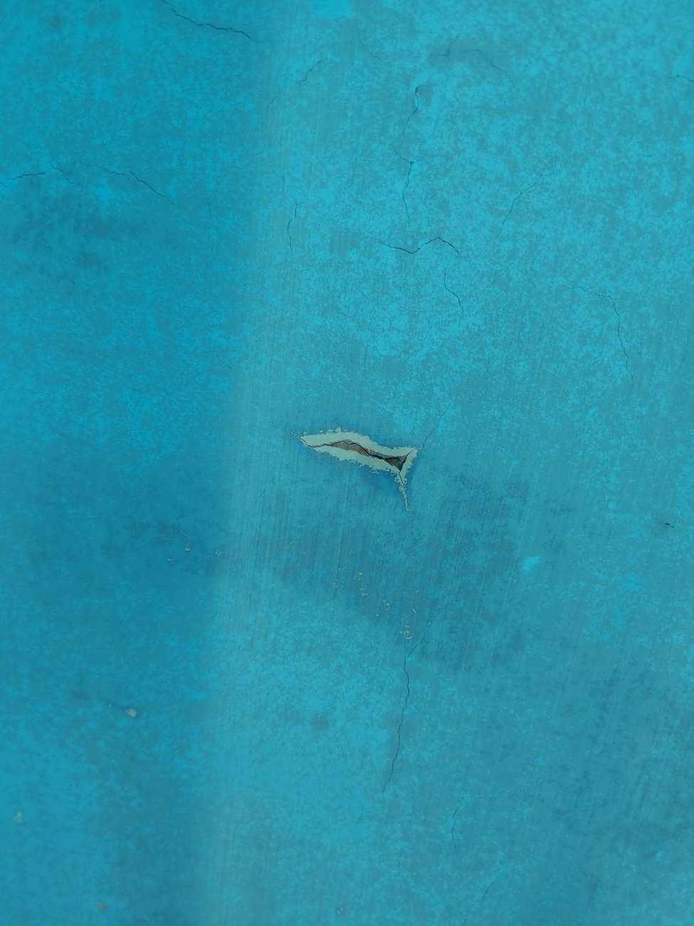

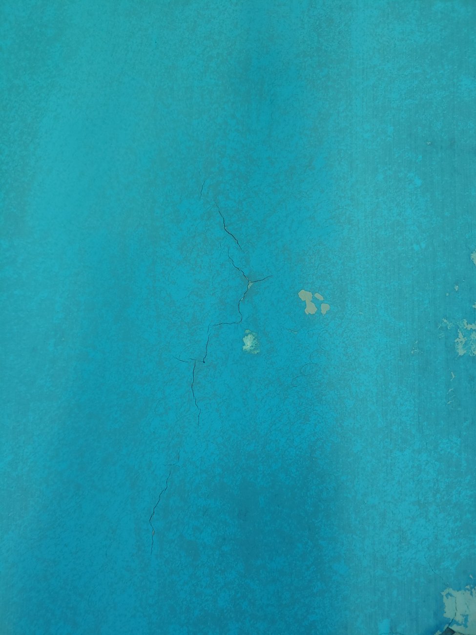

Hello all. My sister and I were recently offered a free 83 Bruce Roberts 34. We have some experience sailing but never owned a sailboat before. Of course it has needs and I really need help with one of them.
What is going on with the rudder here? I know the crack is more than just paint but I'm pretty sure else can just sand it down and fiberglass over it.
Is the cracking the barrier coat, gel coat? How should we best to the repair before painting?

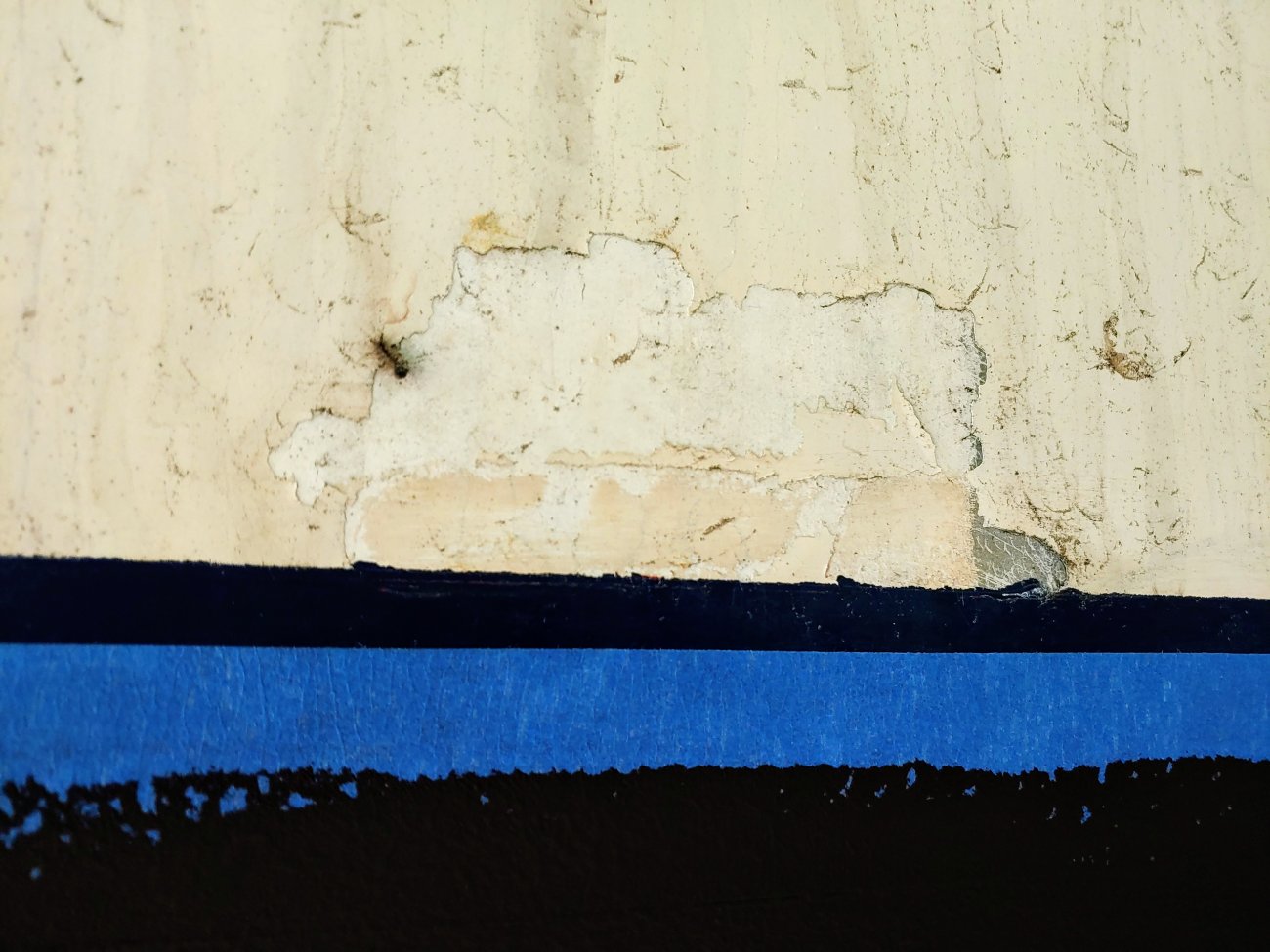

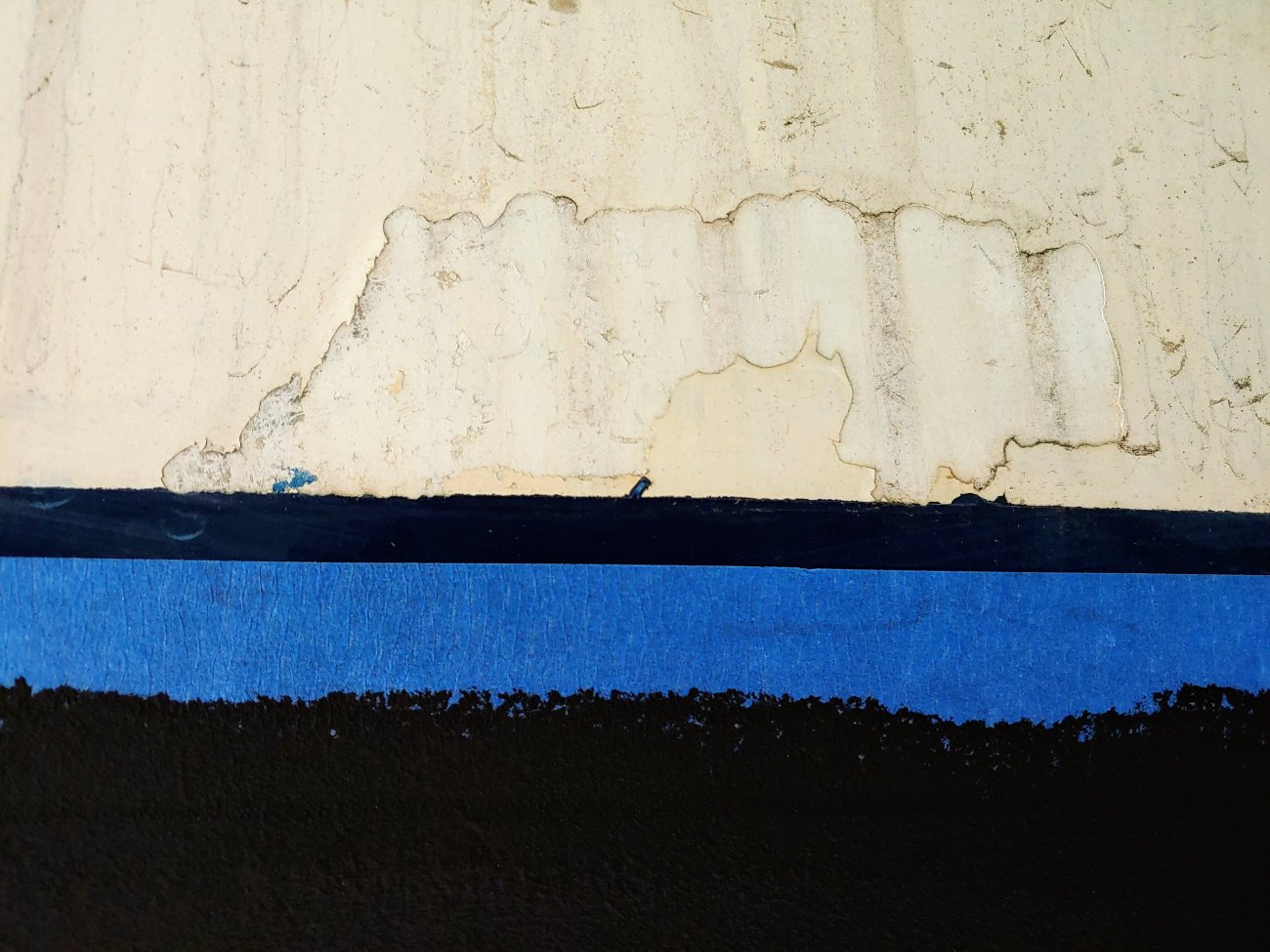

It also needs some spot work above the waterline. Any advice there would be great too.

Based on the first photo, it appears the rudder is wood covered with fiberglass or simply covered with some fairing compound. Some exploratory surgery would give a better idea. Try drilling a ¼" hole in the rudder to see what comes out.
If it is wood, the wood is probably rotted. The cracks look like expansion cracks from water freezing inside the rudder. If indeed that is the case, then the rudder is probably toast. The water would have caused the wood to rot, losing its structural strength. Waterlogged rudders are not unusual in an older boat.
Replacing the rudder is probably a better plan than trying to repair this rudder.

All anyone can discern by looking at pictures here is to guess at what the problem is. Assuming you are at or near a boatyard or know someone knowledgeable, have them inspect it properly. This isn’t something to guess about.
