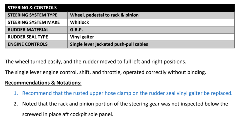

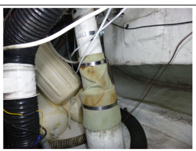

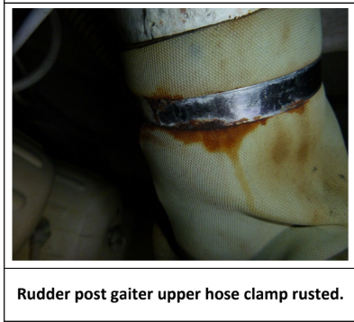

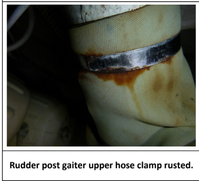

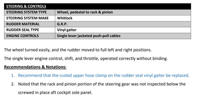

Not sure how useful the survey recommendation is to “replace a rusted clamp”. That’s ’village idiot’ stuff and has no ‘bearing’ on the shaft bearing condition.

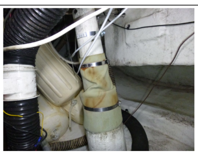

It appears to be easy to remove the collar so you can see the top bearing even if the boat is in.
It does not wobble, there is no play. I was going to replace the clamp, but ran out of time. Will do it this week and try to take some pictures. Thanks!

PS - I agree with @dLj about the hose clamp - Your surveyor was just stating the obvious for an inconsequential cosmetic issue. That cloth was apparently trapping moisture beneath the stainless in an anaerobic state, which would cause any stainless to rust. It’s just a cover.
While I'd love to take credit for that, but it was @Don S/V ILLusion to whom that comment should be credited...

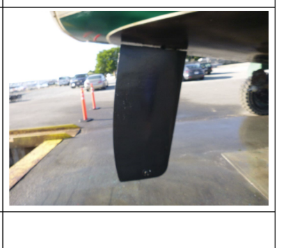

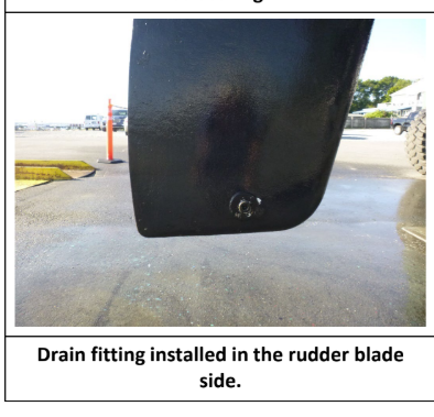

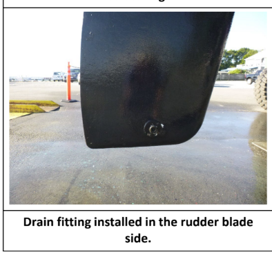

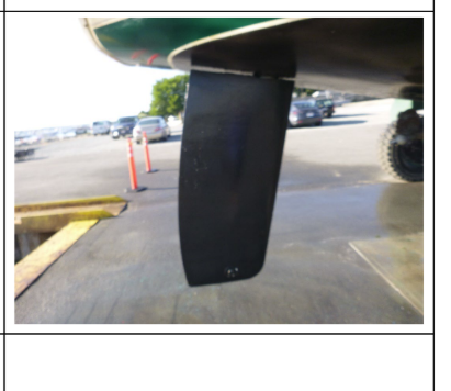

I was wondering about the drain fitting installed on the side of the rudder? Is that a common thing? I realize water in rudders is a relatively frequent problem and not always easily fixed. I see boats in our boatyard with small drilled holes in the bottom of the rudder to drain them when hauled out for the winter. Just wondering about that drain fitting( I realize it has nothing to do with the squeaking), does it drain a wet rudder faster and better?

I was wondering about the drain fitting installed on the side of the rudder. Is that a common thing? I realize water in rudders is a relatively frequent problem and not always easily fixed. I see boats in our boatyard with small drilled holes in the bottom of the rudder to drain them when hauled out for the winter. Just wondering about that drain fitting( I realize it has nothing to do with the squeaking), does it drain a wet rudder faster and better?
I was told by multiple people to take a look at it when I get the boat out of the water. From what I read, water in the rudder will make the metallic frame (and possibly the foam/filling) rust/rot with time. The fitting just slows down this process, but doesn't fix it. I've found some videos of people restoring their rudders, but this is a big project that takes some experience with it (I wouldn't do it myself, to be honest). I'll probably take my boat out of the water by October and will get someone with experience to inspect it. The last thing we want is for the rudder to disintegrate while we're out.
