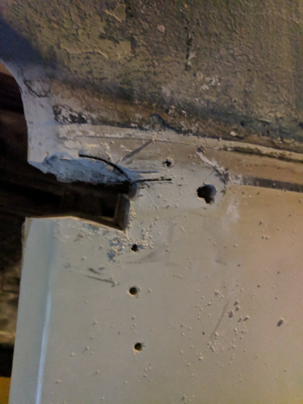

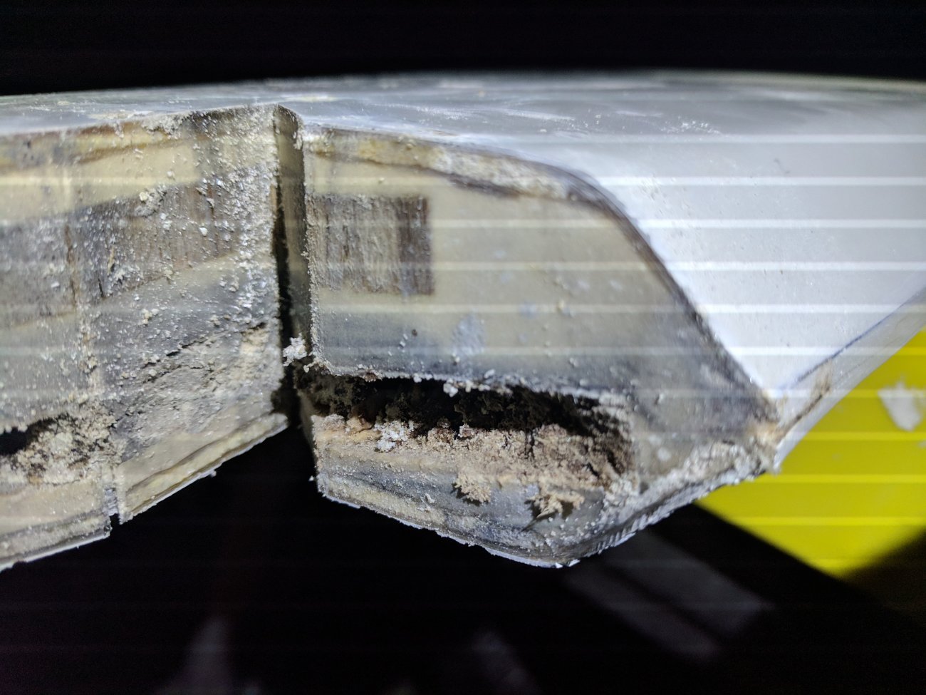

So did some surgery on the rudder last night. Cut out some pieces and drilled some holes. Up to 5 inch away from the damage (i.e. lower pintle) soggy pieces of wood came out. There's a bunch of layers, I'm not sure what it all is.. (FG/foam-wood-foam/FG?)
Attaches some photos. The lower (in the photo) filler looks like soggy sawdust. Not providing any support, not sure how far away it extends. In the upper wood layer water squeeze out when I press it.
So yeah, guess I need to figure out how far away the soggy, powerdery wood extends, and then how to replace it. But like I said this has probably sat for at least 3-4 years so ripping off at least one side will probably be required. And if the (still solid) wood ever dries out will it be strong enough again?

The strength of the rudder is in the skin, foam core works to shape the rudder. It may be the case that the wood is only where the gudgeon is mounted. This would give the screws something substantial to bite into. The wood is unnecessary if the gudgeon is through bolted. The wood looks like end grain balsa.
I see a couple of options. The easiest fastest option would be to excavate the rest of the rotten wood to see how far it goes. A thin chisel or screwdriver will probably work. If the screwdriver goes in its full length and is still digging out rotted wood, then the wood probably extends most of the length of the rudder. The void could be filled with thickened epoxy and a block of wood could be glassed in to replace the piece you cut out. Fair the rudder and call it a day and go sailing.
Option 2 would entail removing the skin from one side of the rudder and excavating the entire core. Replacing the core and glassing the skin back on. This process is shown on a series of videos on Boatworks Today.
A third option, would start with Option 1, then next fall drill a series of holes in the rudder and let it dry out over the winter. Fill the holes with thickened epoxy in the spring fair and paint and go sailing.

You may want to add photo of the whole rudder. Does it swing up and down on a pin when mounted, or is it a fixed position? If it we're me, I think I'd see what the pour-in foam costs, the type used in that boat works video. If enough to fill your rudder is affordable, I would remove one side all around where the "chine" line is, dig out all the wet stuff, sand the insides of the rudder sides a bit, and fill with foam, then epoxy the side back on. Probably far less work and cost than new rudder.
