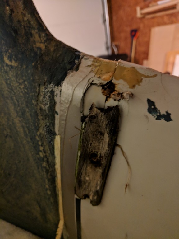

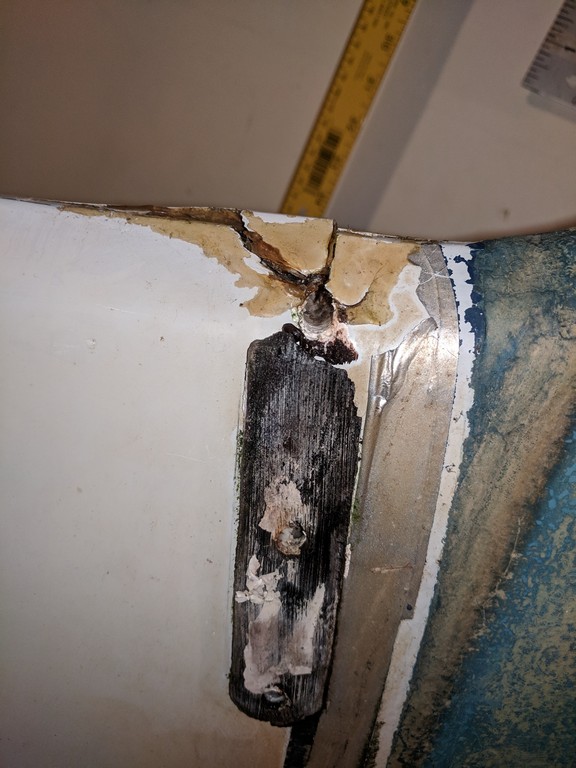

Any input on the best way to repair this loose piece damage on the rudder (seaward 23)? By the waterline where 1 of the 3 bolts attach. The piece on the left is loose enough to wiggle slightly. PO tried...something? Looks like gluing it on was the intent. I assume best is cut it off and redo fiberglass? Or can I just slather on a chunk of epoxy? Not sure how i'd get the shape right though (a lot of sanding..?), but I suppose it doesn't have to be perfect.

Never mind. I took more apart last night.
All three bolt holes were filled with some soft caulk which was saturated with water. Pulling it out I found the core, which I think is wood in the center, some foam along one edge? It was soaked! and falling out or very soft most places I could get to it. Now, if I could only remove and fill in the rotten core.. But the fiberglass outer shell is cracked all the way from the 1st to 2nd bolt hole, on both sides. I does seem ok from 2-3, but I'm skeptical. The force of the pintle attachment on the hollow core has deformed the fiberglass in the whole area.
So I'm not sure how, or if, one would fix this. Assume something like drying out, cutting off everything couple inches to either side then trying to lay new fiberglass over the whole area? There will be a lot of force around the bolts so will have to be strong, and anything that's just epoxy I imagine would crack. But also worry about adhesion to the rudder. Even if the new part is very strong I can see how that whole thing just rips away from the rest of the rudder. Not to mention I don't know how long it might take to dry out this whole thing, I put two window fans on it for now. I just bought the boat; I'd like to use it this season.. This is beyond what I'd do as my first FG project, so am in talks with a local repair place so we'll see what quote they give. I'm guessing more than a new one.

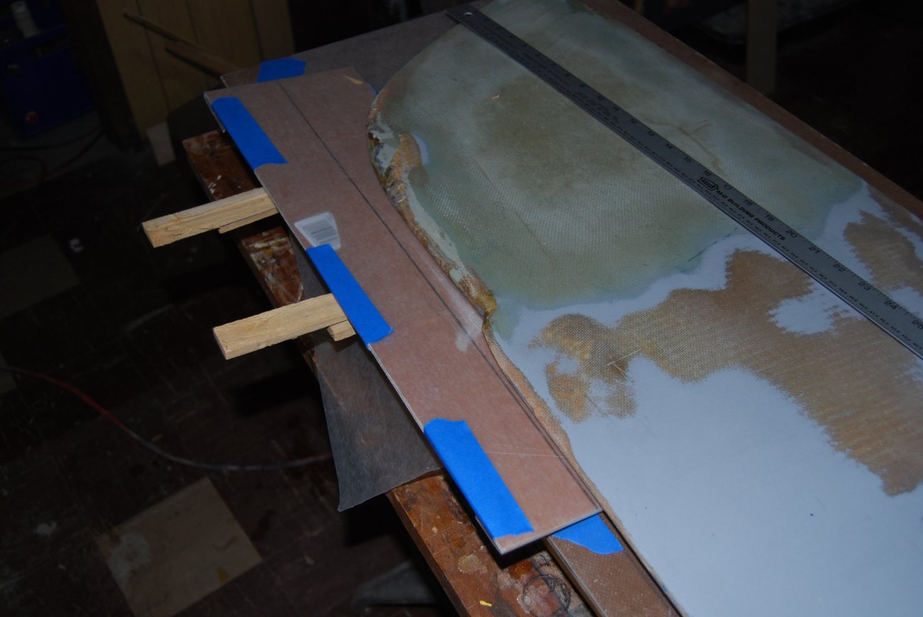

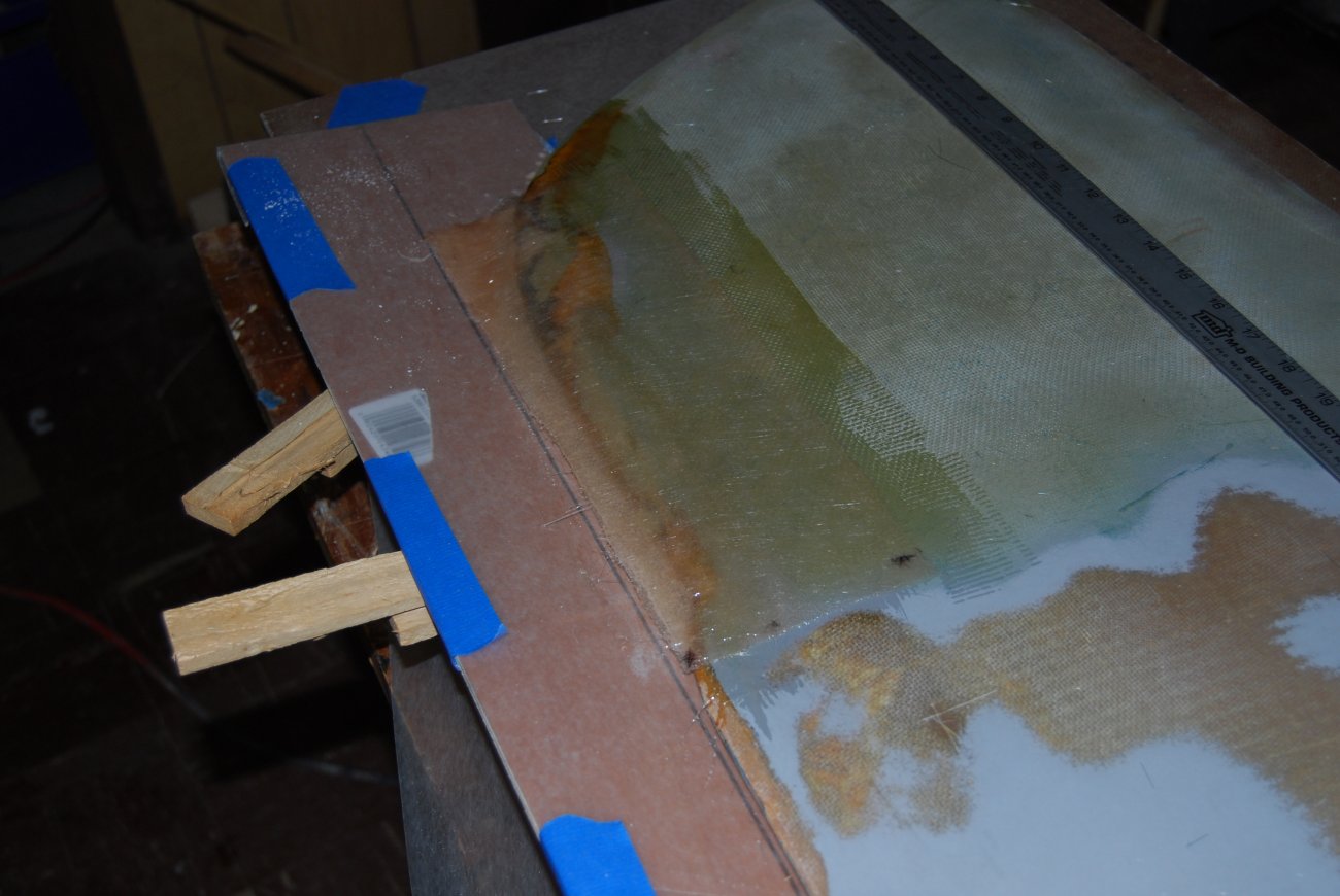

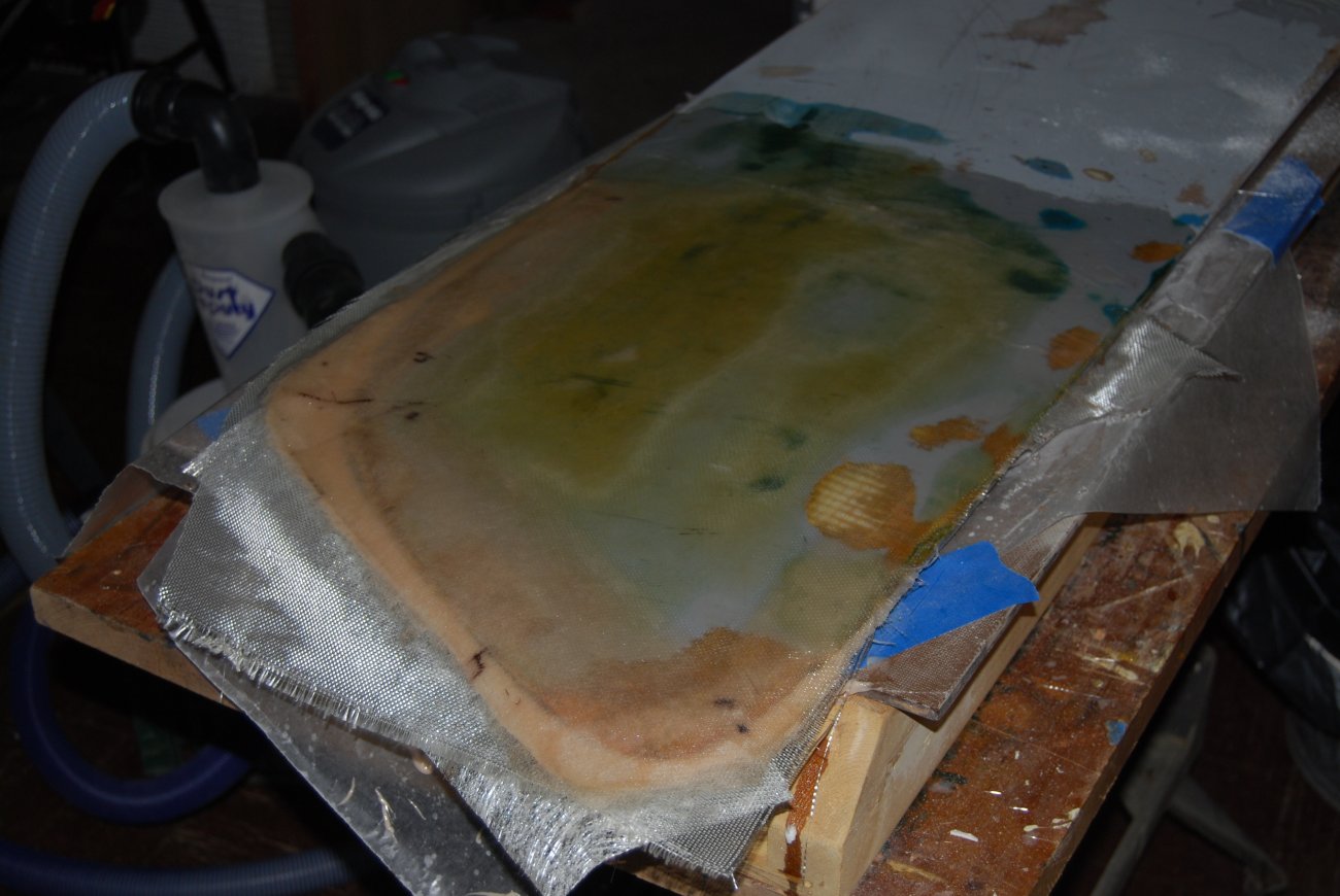

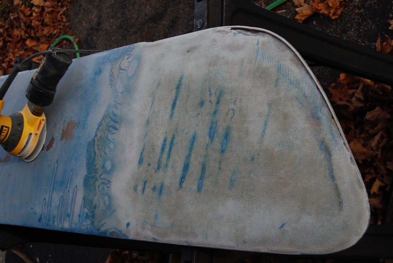

The CB on my Scot had been severely damaged by some prior owner. And then poorly repaired. It appears that the CB had come in contact with a rock on multiple occasions. The repair consisted of a ¼" bronze or brass rod bent to the shape of the rudder and then filled with thickened resin. Eventually, it all chipped away. This first picture shows the damage after some time spent gloriously sanding away bottom paint and whatever to assess the damage. You can also see that the glass was not well saturated with resin as it white.

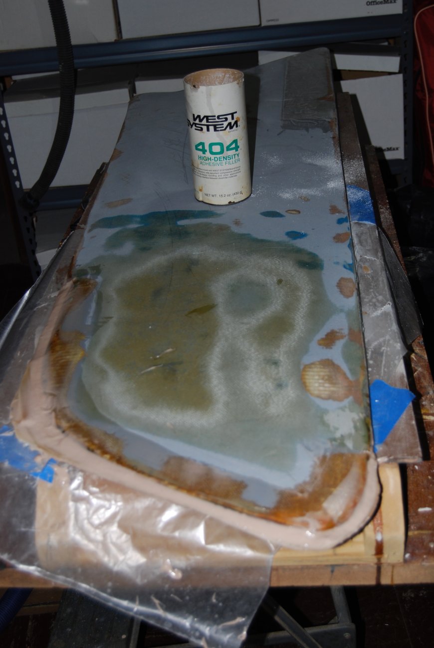

Once all the failed repair was removed, it was time to start building up the end of the CB. Simply adding thickened epoxy would be a bad choice as another chance meeting with a rock would likely damage it. In this photo you can see the damage on the leading edge after the old repair was removed. The board below it is covered in wax paper and shimmed up to provide support for the new glass being laid up. The line on the board shows where the edge should be.
The second photo shows the edge after several layers of glass and mat were in place. There are 2 schools of thought here. One says start with small pieces and build up to larger and larger overlapping pieces. Another school says start with big pieces and then smaller and smaller. I went with the first option. The mistake I made here was using mat with epoxy resin. The glue that holds the mat together is styrene based and does not absorb epoxy resin all that well. Polyester resins work well with mat. For this application, it probably doesn't matter a lot, but I would do it differently in the future.

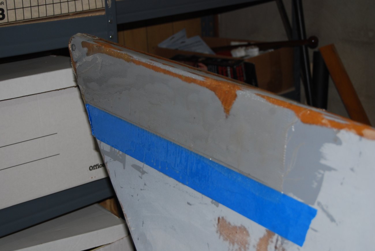

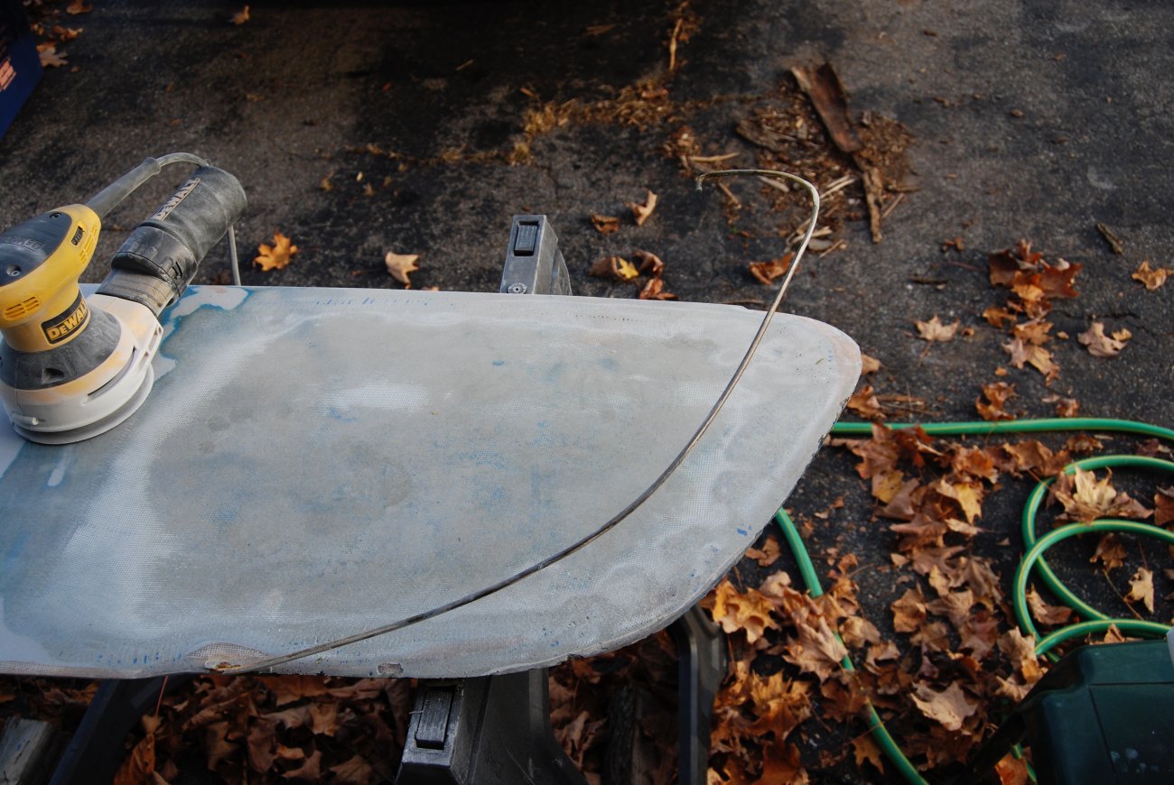

The lower half of the CB was then covered with a layer of 2 of glass. To make life easier I just let the glass hang off the end and trimmed it when it was partially cured. It was a bit faster to do it this way than trying to fiddle with the cloth to get it perfect or to wait until it was fully cured and spend more quality time with the sander. Once the first side was glassed, I flipped the board over and built up the lower edge with epoxy thickened with a high density filler and then encapsulated it in more fiberglass cloth. From that point on, it was a matter of adding fairing compound, sanding, more fairing compound and sanding until I got the shape I wanted.
Once it was faired, I painted it with Interlux 2000 to give it a nice hard epoxy surface and then I got distracted by life and a new boat, and it is still in the basement waiting for final touches.
