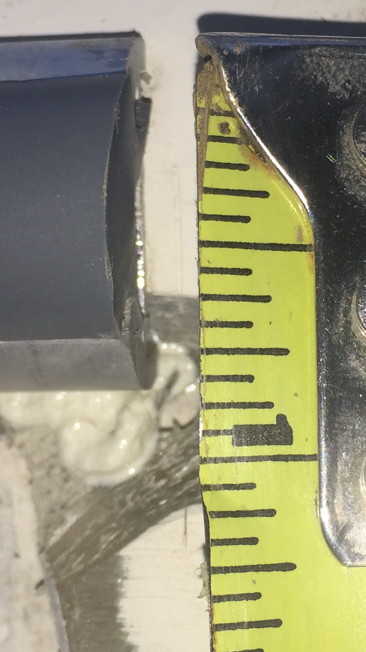

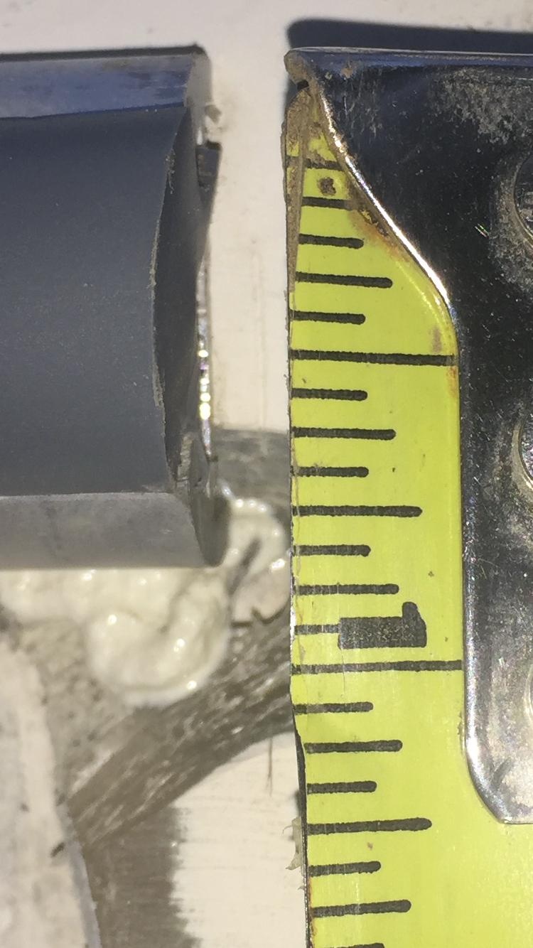

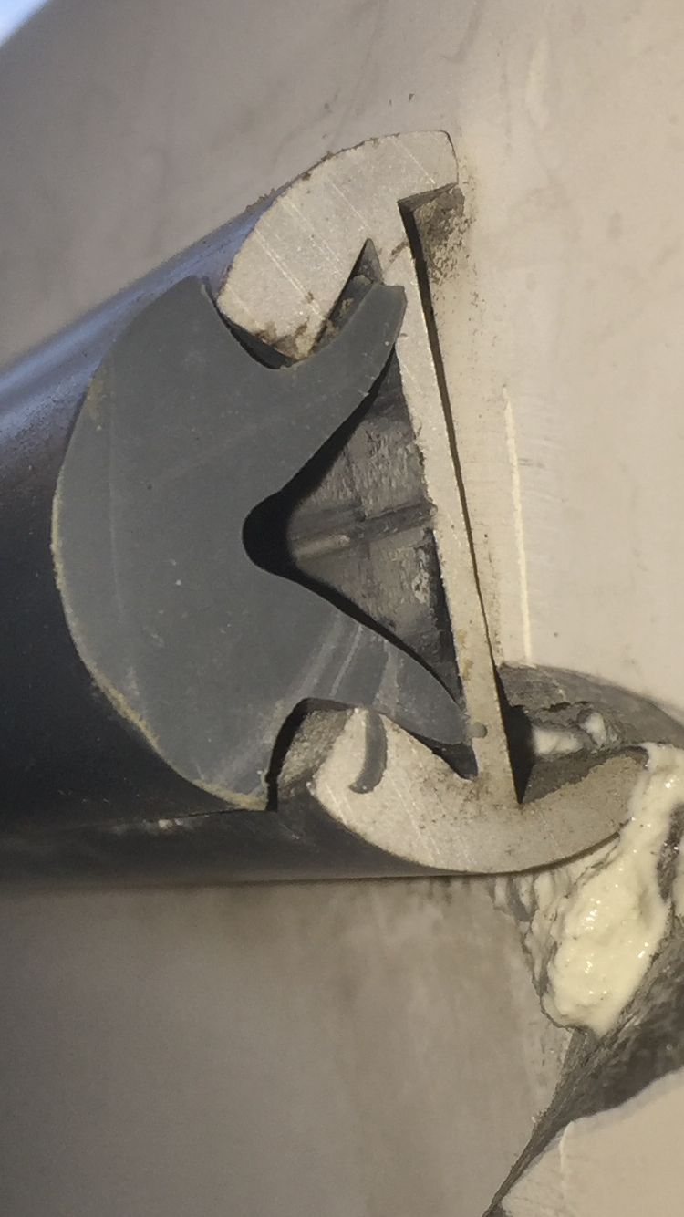

image.png image.jpeg maybe it is my heat intolerance, but this rub rail insert is a pain. Two inches at a time, this is as far as I got in an hour. My arms hurt and my fingers are sore. Pictures of the old and the new.

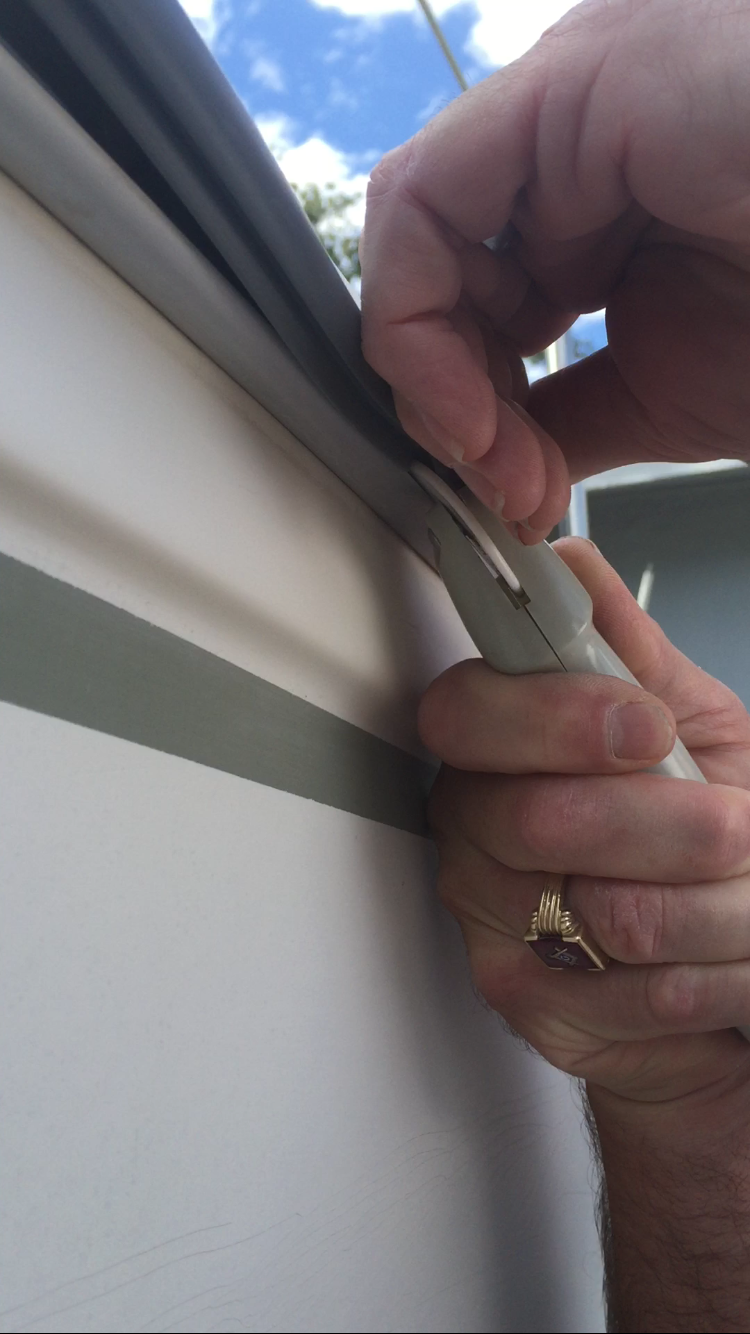

been down this road, not on my Cat22 (yet), but on several powerboats...try a window screen spline roller...insert top first as said, roll in the bottom with the spline tool...

A spline tool! Great idea - and I have one. I've been installing the bottom first. Okay, a heat gun, spline tool, unwind the roll and set the top first. Thank you, rpludwig, Gene Neill, Leeward Rail and Jacomo Sailor. There are times when I think I'm too old for this. I'd like to get this bucket in the drink before I throw in the towel. Your commiserations, advice and encouragement are inspiring. Thank you!

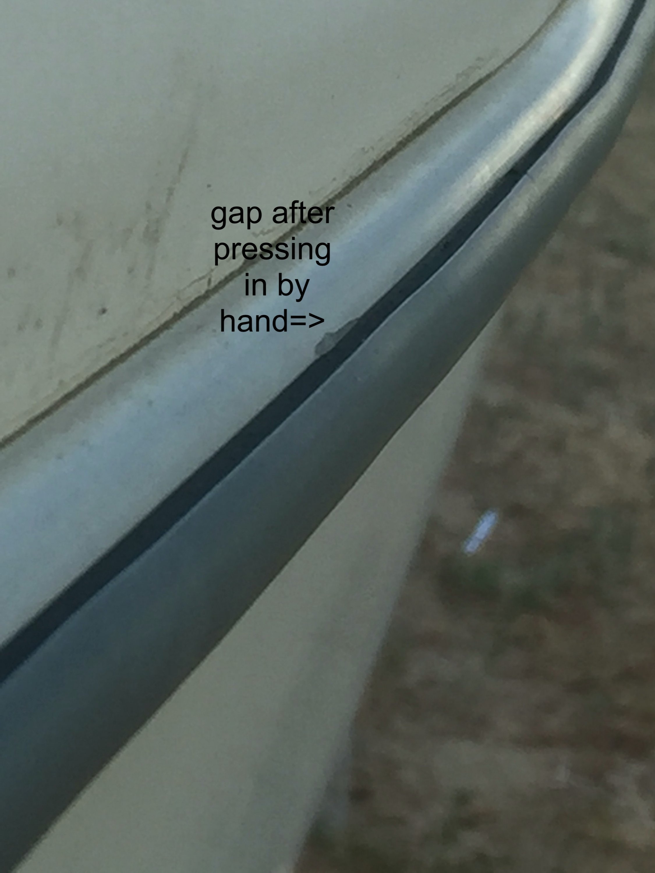

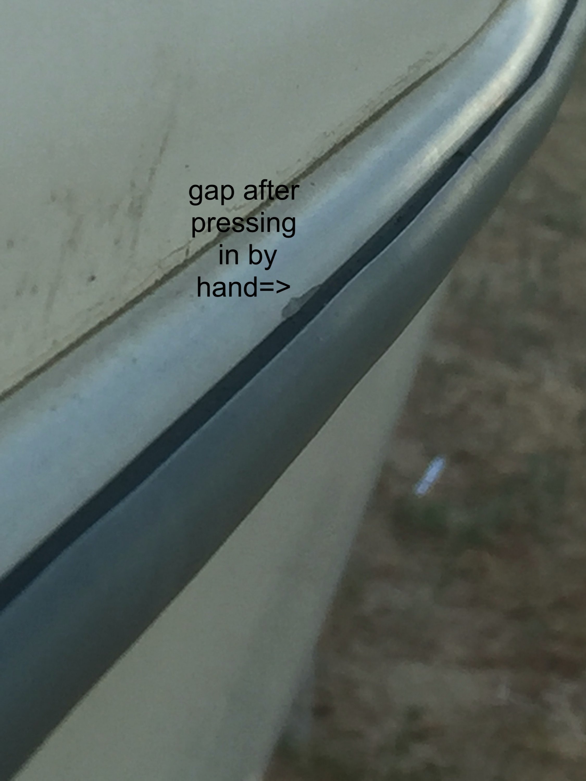

Yesterday, it was 100° here in Sacramento. I had moved the vinyl insert from the bucket of soapy hot water to a cooler. I unwound it from the tight roll, too. Since it was so warm, I tried installing it by seating the top first and using the nylon spatula to seat the bottom bead without the warm soapy water. My arms didn't get as tired, but my thumbs hurt like hell. Only got a couple feet installed. But it seemed a bit easier. I have been using a big rubber mallet to seat the vinyl in the aluminum rail. It seems to have a small gap (~1/32") that I can't close by pressing. I will give the spline tool a shot today WITH hot soapy water. And maybe try the heat gun since 88° is the forecasted high today. Perhaps I can get my daughter to help.

I don't know about the spline roller, but a nylon spatula sounds way too soft. A flat tip screwdriver will do it, but only a very short section at a time. My dull wood chisel was perfect.
Push the bottom up, primarily, not in. This is probably why the mallet is leaving a gap.

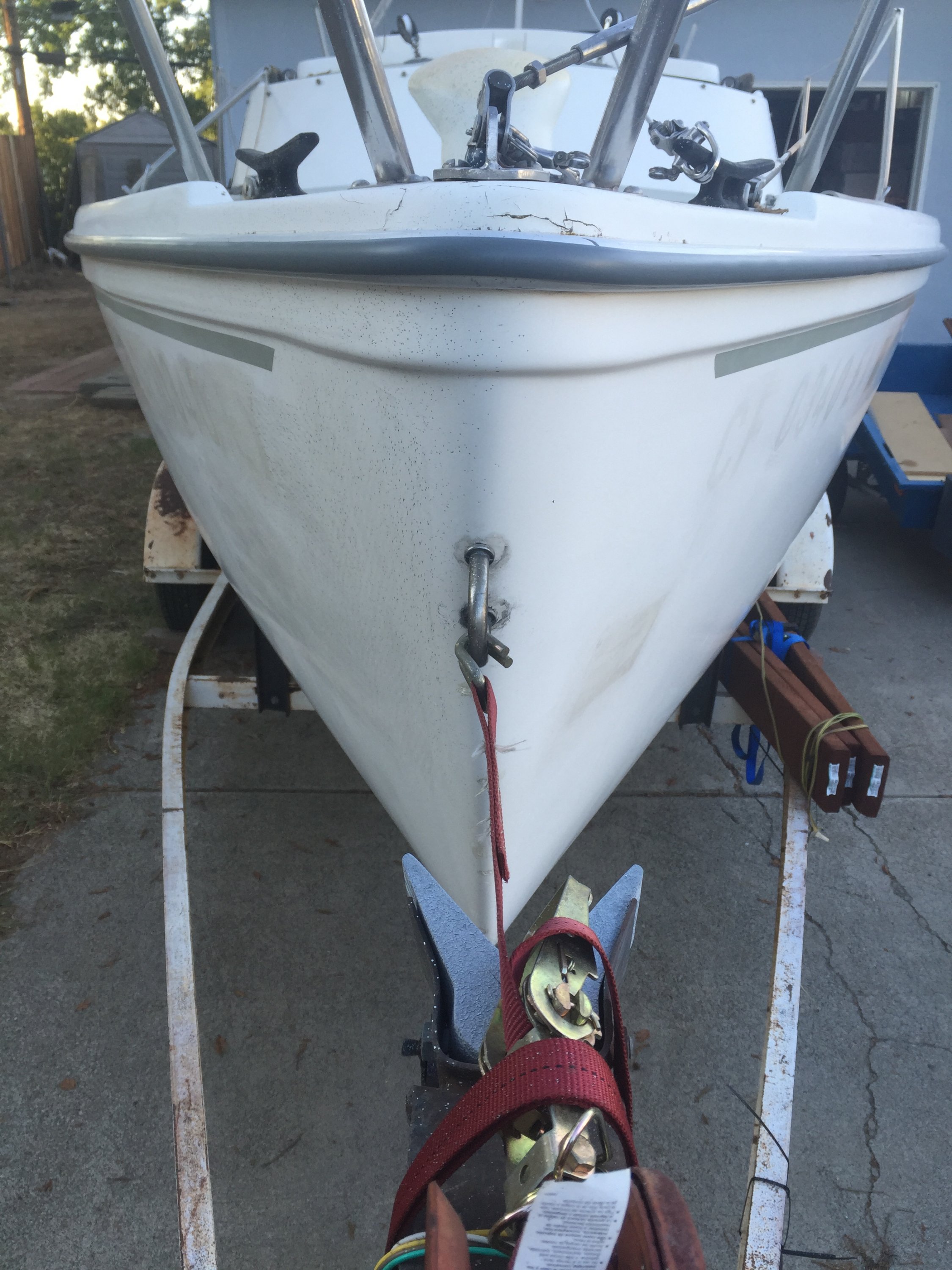

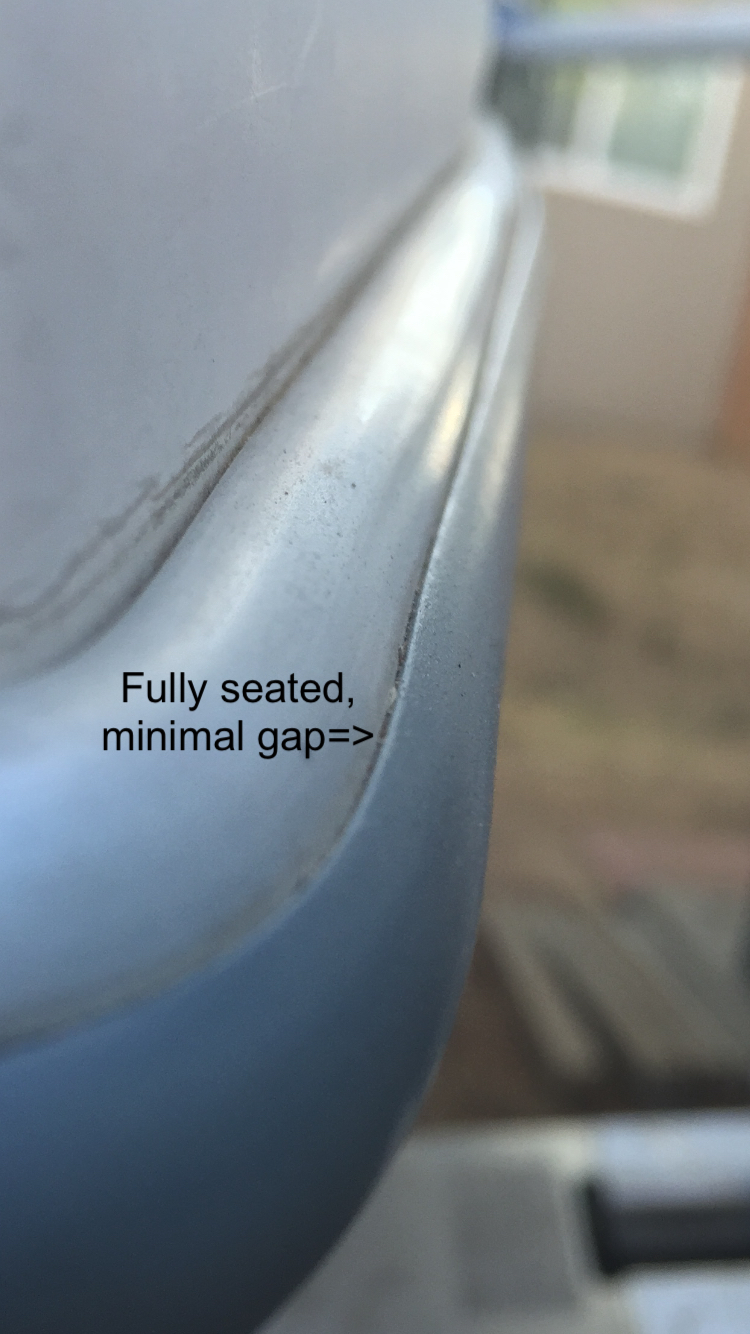

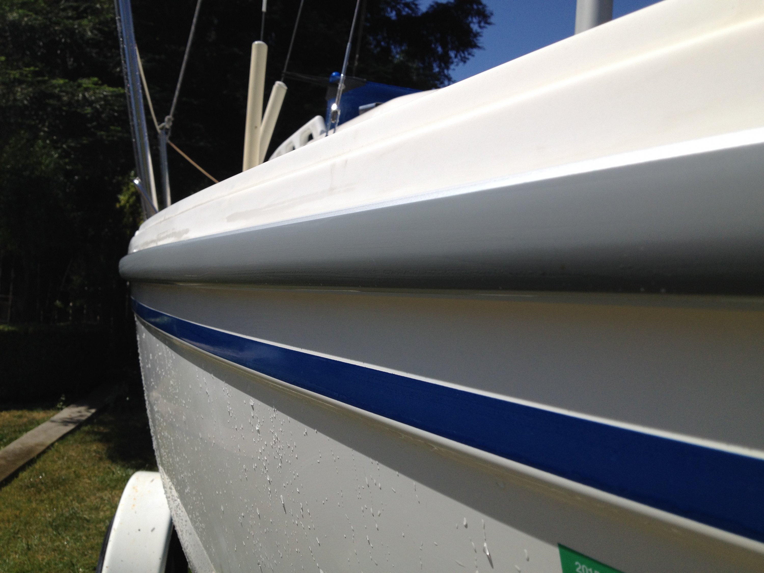

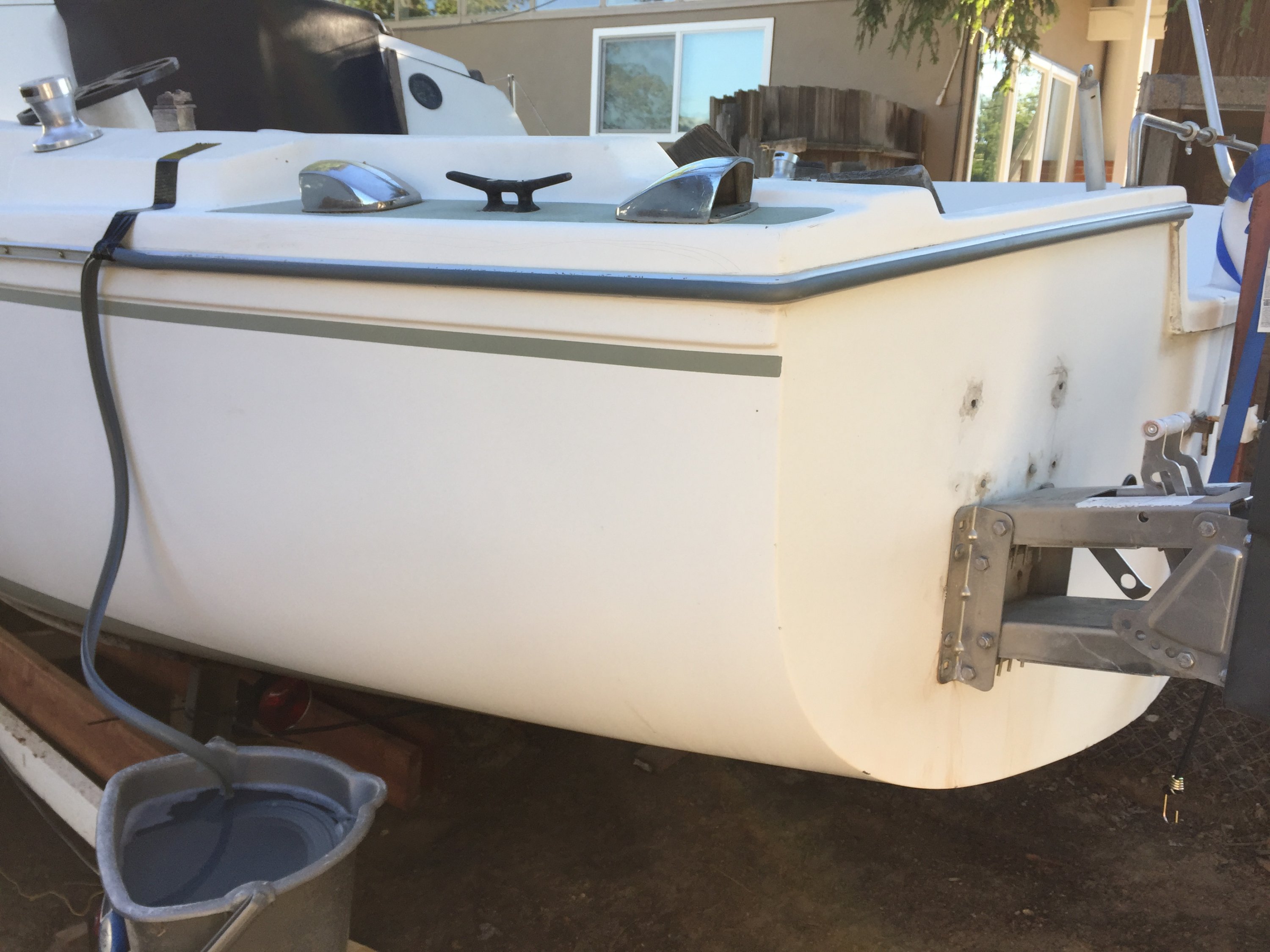

Thank you, Gene! The spline roller worked great for me. I'm nearly done. The sunset side went a lot quicker because I laid the insert along the deck. Warmed by the setting sun, it went in much easier and more rapidly. I broke out the heat gun on the last corner, the vinyl had stiffened in the shade and didn't want to make the turn.
Here are some photos as I finish up:
