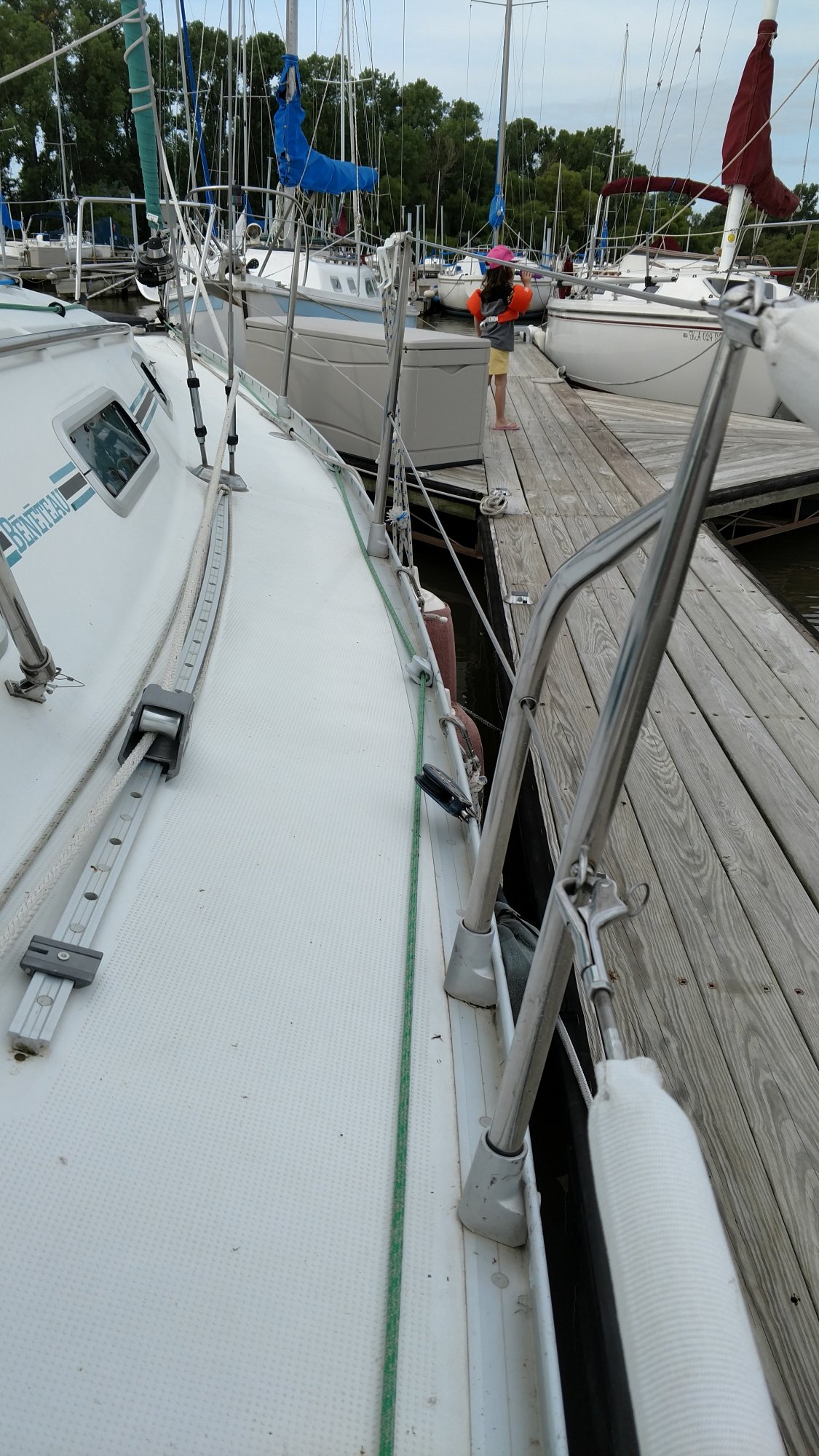

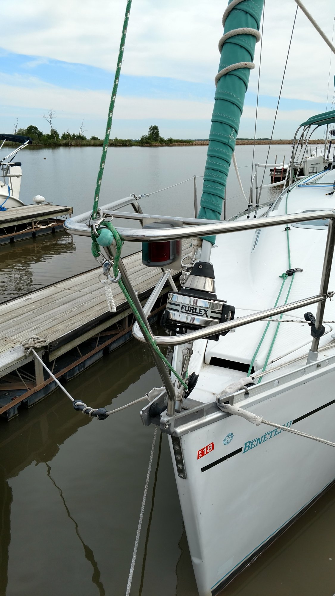

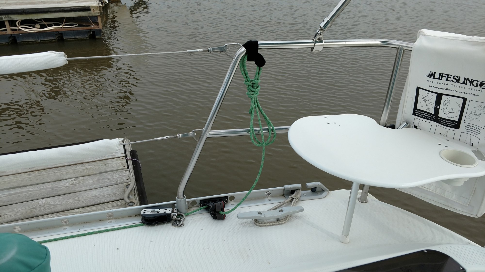

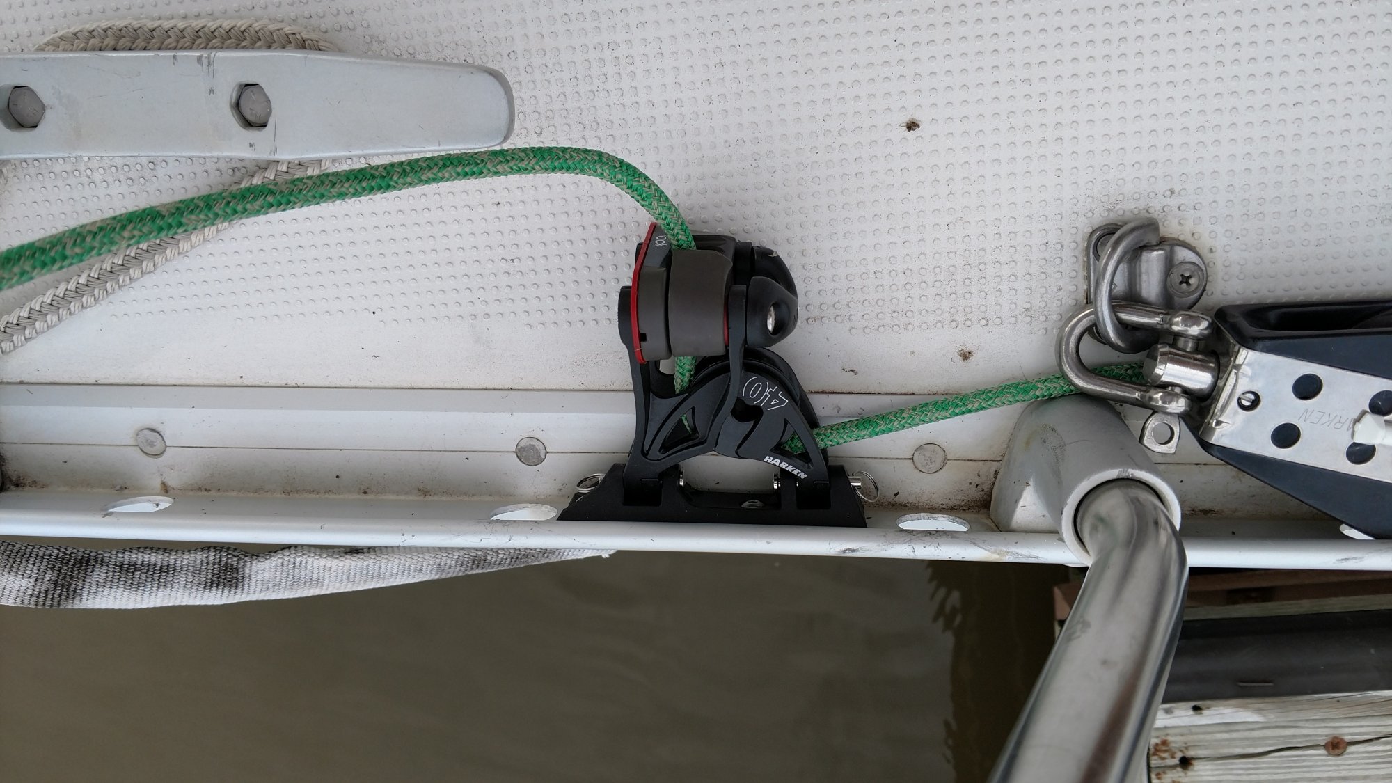

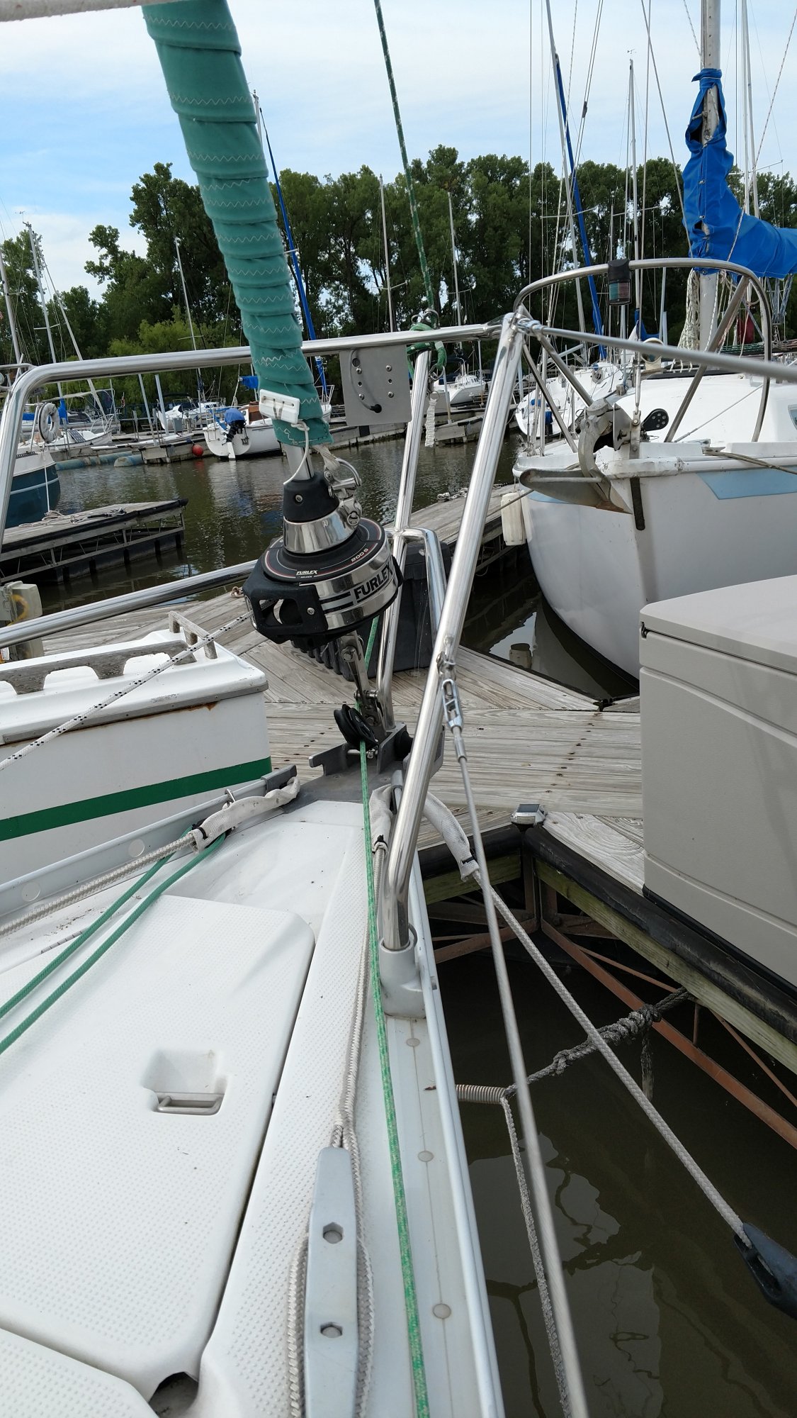

Here are some pics of how my asym tack line is set up. It runs from back by the cockpit along the toe rail using the same type of OEM sheaves that Beneteau uses for the roller furler line - they are not cheap from Beneteau but they work well and are out of the way.

@JRacer I like your set up of the tack line at the stern and along the rail.
I am wondering about the location at the bow and how it sets with the sail. I can see when you are running off the wind how the tack line will be up and out beyond the bow pulpit.
What happens if you try to bring the bow up closer to the wind. Then you draw the tack line in does the sail hit the upper pulpit? Are there any conflicts? Or do you generally sail with the asymmetric well greater than 90 degrees?

Generally don't run it close enough to the wind for it to be an issue. Present setup at the bow is a temporary arrangement until I can get my Selden retractable bowsprit installed.
