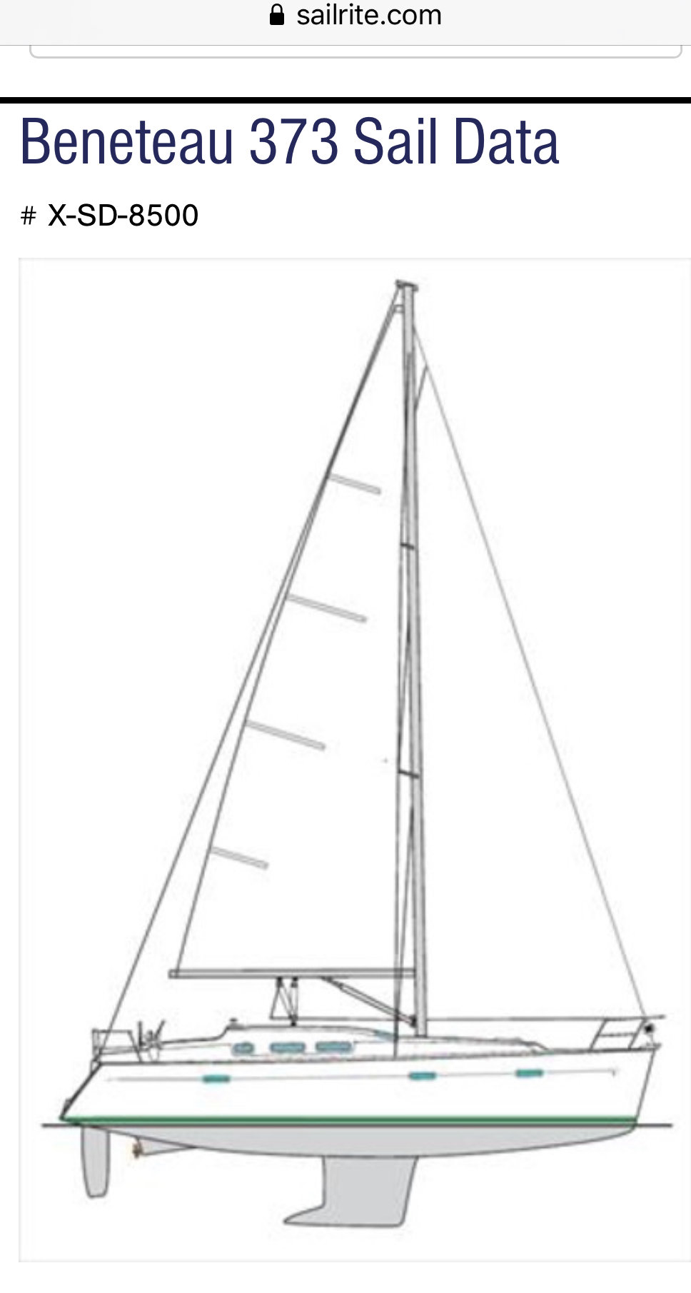

I've never considered flying a spinnaker from a jib halyard. Do many people do this? I'm asking because I just had a conversation yesterday with the owner of a Gulfstar 42 who wants to fly a spinnaker but wasn't sure how best to add the spin halyard. It seems jibing would be a real challenge and using the snuffer would almost be mandatory for jibing with this setup.

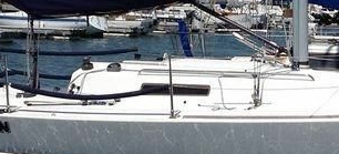

put a cam cleat on the cabin side aft edge. Tack line should be able to then lead to cockpit coaming winch for release and easing under load. Loads can be up there so be careful how long you keep your A sail up. Our A sail is bigger than yours and Harken 150 with fairlead holds it well. Our small A3 (1000 sq ft) loads up quite a bit at 80 degrees apparent wind angle and 14 knots true wind. At 15-20 knots true wind, apparent wind angles go to about 100 degrees which is when we start to take off.

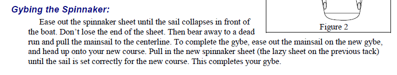

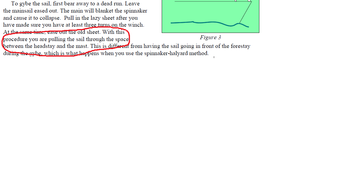

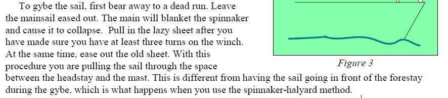

I'd refer you to the following :
which is a useful reference because the sailmaker's instructions are explicit regarding the use of the two different halyard types, and of the two different jibing procedures. Unfortunately most spinnaker handling instructions you find on the net assume readers understand what a "spinnaker" halyard is, and so dont make explicit an distinction regarding headsai/genoa/jib halyard use, which as we can see from this thread, is a bad assumption.
then gets to the related jibe procedure for this type of halyard, which involves jibing the chute in front of the forestay
then has a section on the alternative type of halyard, which is what is the commonly installed style on most non-racing boats, unless an owner or manufacturer has done a halyard upgrade, I have been referring to this as a headsail halyard:
Then to the jibing procedure appropriate to this type of halyard, which involves jibing the chute through the foretriangle, ie aft of the forestay:

To use the OP’s boat as an example,
the forestay appears to be attached to the mast just below the actual masthead.
To me the only “safe” way to rig a flying sail, cruising chute, asym would be to have a “spinnaker halyard” connected via a block that could move and NOT chafe to a point ABOVE the forestay attachment point. The tack of the sail should be connected to a point IN FRONT OF the forestay.
If it was me I would want a top down furler rigged to a retractable bowsprit and at the actual masthead or perhaps a masthead crane if extra clearance was required. The furler would allow me to do almost all of the sail handling from the cockpit.
I believe that there are boats rigged where the asym is managed INSIDE the “fortriangle” :) I guess for budget reasons but if you can afford the asym it would seem logical that you could afford a “real” spin halyard;) Just my 2cents :)
