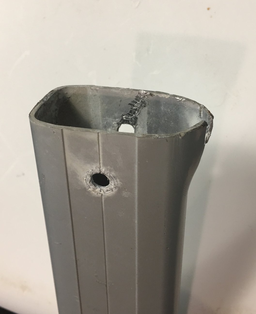

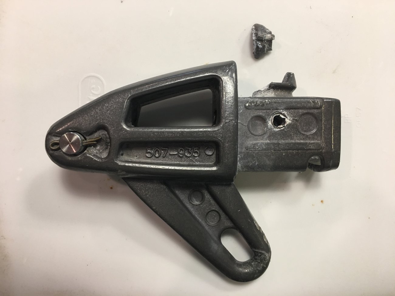

Perfect, thanks JRacer. Either the cable gave way or the tab on the casting/fitting broke. But, there is some deformation on the end of the extrusion I'll have to cut off. I'll remove the vang off the boat today or tomorrow and take it apart and post photos.

Tab on the bottom end fitting broke off and the extrusion deformed when the cable pulled by. New fitting unavailable on line, ordered from a local rigging company, about $60. I need to cut about an inch and a half off the end and drill new rivet holes. I may get a gas strut for it while I'm working on it, is it worth having the strut in the vang for $150 more?

Ouch. That's what I was expecting.

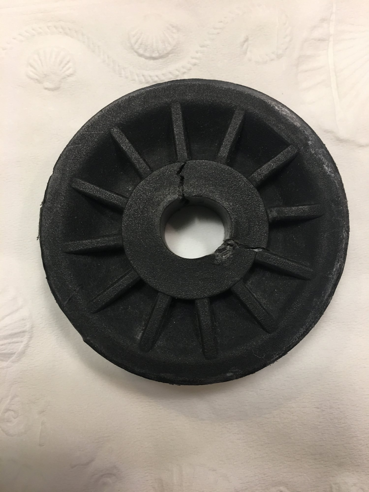

After the last race, I took the vang apart again to get the cable shortened, found the wire sheave in pretty rough shape. Nobody can find one, local rigger says they can machine one from delrin for about $30. Probably cheaper than if I did find the Selden part.

Wow, that thing has had some load on it! Assume the rigger contacted Selden in SC. Surely they have a replacement part. Or, have you looked for an aluminum replacement? Would think some mfgr has a replacement that would fit the size specs.
Makes me wonder whether the kicker you have is undersized for the loads involved.

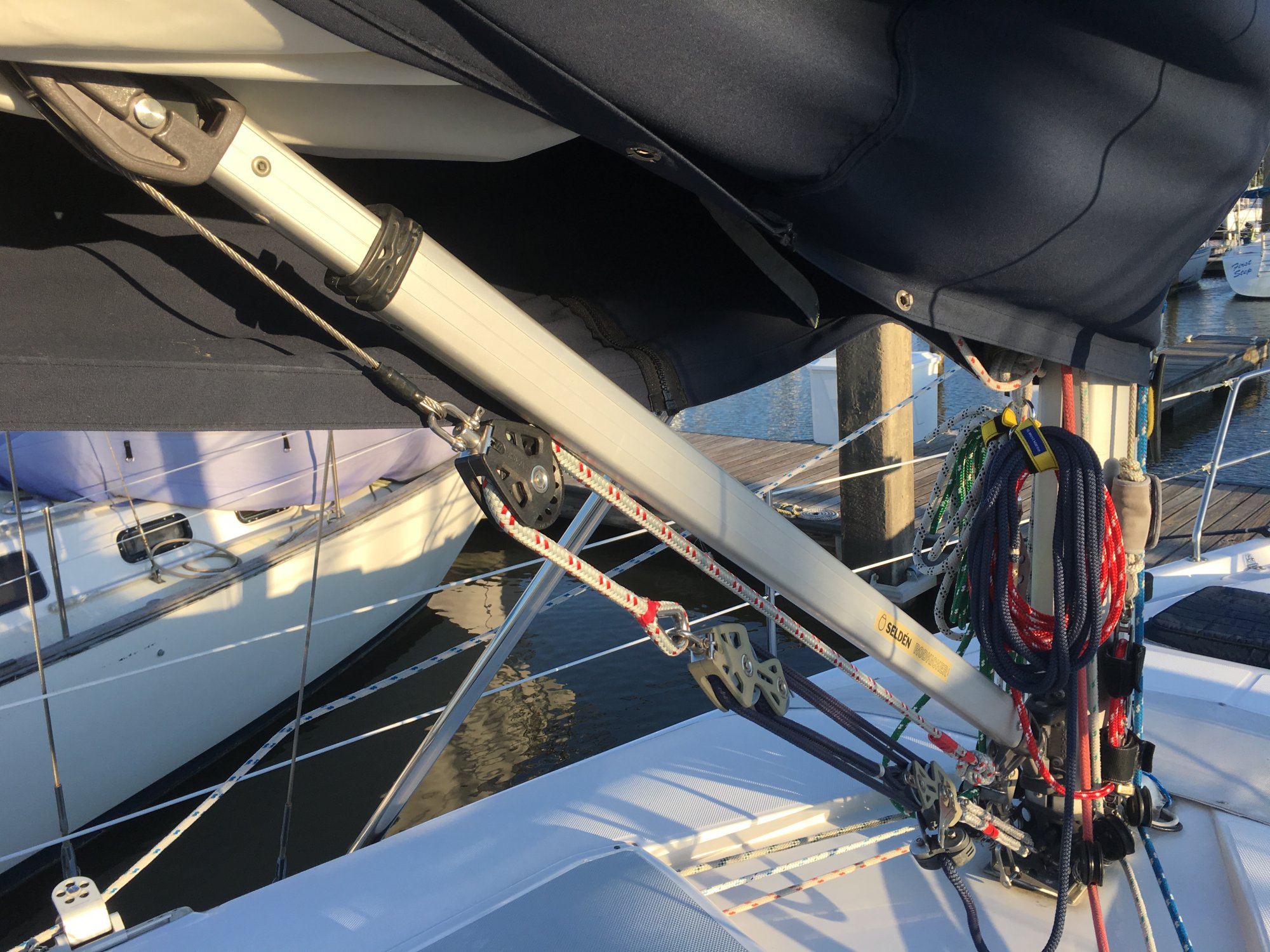

Looks like you keep the vang sheet handling up at the vang and mast.
When your main sail and main sheet tight is the vang bottomed out or do you still have some adjustment? Do you mainly sail with the vang sheet released, except for down wind?
I inverted the cable/blocks and ran the vang sheet to a block at the mast plate and back thru a clutch to the cockpit so I don't need to go forward to adjust. Was also looking to get a gas cartridge as I don't think mine has one.

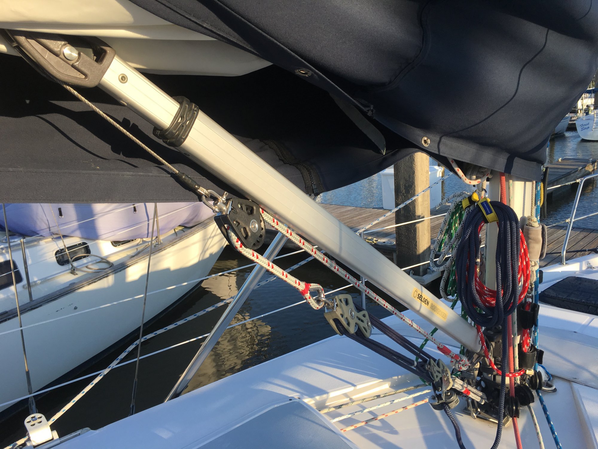

Yes, we trim the vang from the mast base for now. I have been setting the twist with the vang and using the sheet for angle of attack, upwind and down, fine tuning upwind with the traveler. I will get a better photo that shows the whole vang in use, we have a practice race on Saturday.
One more thing to do, get a 10" cable made with loops on both ends so the block with the clam cleat is up off the deck. Using a piece of rope right now. I would like to run it to the cockpit someday, the outhaul, topping lift, and cunningham are at the mast base, too.
I think I've got it set up right, plenty of adjustment room between the blocks, even fully trimmed. 16:1 is amazing how easy it is to adjust under load, even with the 16' boom on my boat. Last few times out, I have been adjusting it way too much just because I can now! And I did use a nylon line for the 4:1 between the fiddles to absorb some shock from jibes and I think that's going to work out nicely.

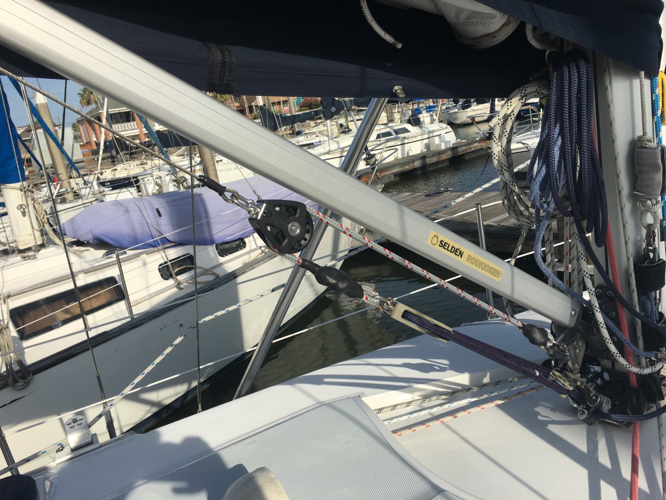

Vang is pretty much repaired and completed. I used a dynema loop instead of a crimped stainless cable from the base of the mast to the bottom fiddle block to get it up off the deck and make it easier to use the cam cleat. I've got the cascade line tied on one end with an anchor hitch. Should the knot be an anchor hitch, a shackle knot, or a bowline?
I know the base of the mast is busy, but it works for now until I can get more lines to the cockpit. The red line is the topping lift, the Velcro straps around the blocks are to keep them from scratching the mast. The green line on port side is combination outhaul and Cunningham.
I used it in a practice race on Saturday, it works fine. I think I also found the problem with my mainsail leech in my other thread, but I want to be sure before I post.
