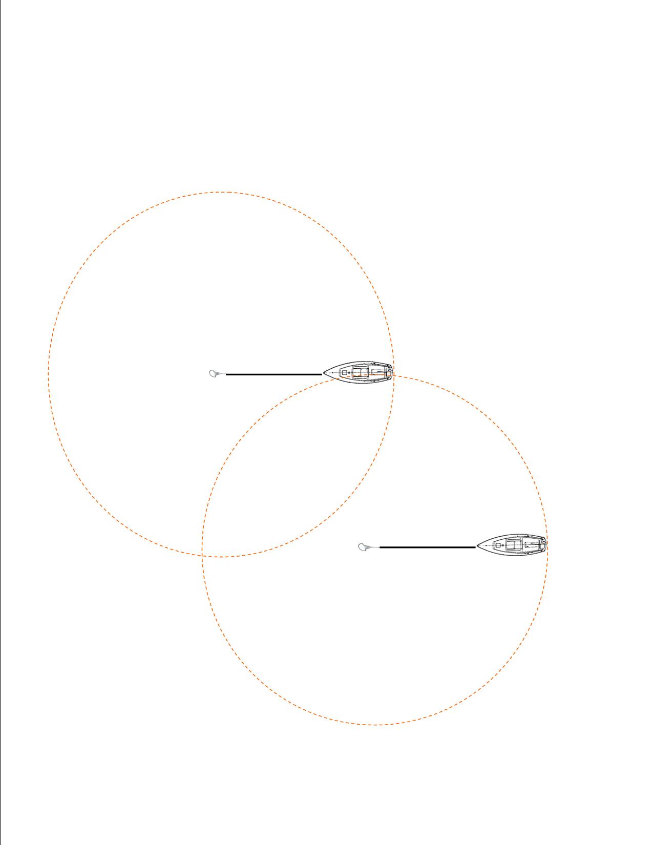

Just because no one has mentioned it directly:
Case law says (and anyone can interpret this--Google the topic) that the first boat has the right to swing and that later arrivals must keep clear (not foul the berth of the first boat). It does not say that they must be outside your swing circle, only that they must not foul you (contact or tangle rodes). This first boat privilege stops if you drag (you are no longer moored).
Obviously no one wants to get into this argument, proof is a bugger (folks will claim the other boat dragged anchor), and courtesy says give people room. Heck, if they wanted to hear your conversations they would have stayed in a marina! Courtesty might say shorten your scope, but not if you feel, based on YOUR ground tackle, the bottom type, and the weather during the time you will be there, that you need more scope. Do what is safe.
If you use rope rode, a light kellet (loop of chain) will help you swing with boats on chain and reduce yawing in lighter winds. But it does not really reduce your scope requirement, which will be greater than all-chain. The corollary is to EXPECT that boats with rope rode have greater scope. They must. Assume they do not use a kellet.
One rule of thumb for MINIMUM spacing is to drop abeam of other boats, about one rode + boat length away, and then hang back (see below). Swing circles will overlap, but not too much, and the maximum number of boats with fit (hexagonal close packing). This is the BARE minimum. More is better, and assume the other guy is using more scope than you think.
I can't open the attachment. It shows with a red "X" through it.
