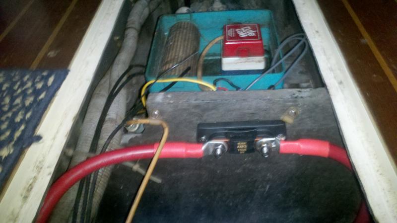

Did manage to get down into the locker and wire the panel. It is shown without the covers over the fuse and new 12v bus. I forgot to buy the 1/0 cable from the charger fuse to the bus. :doh: Also mounted the fuse in the bilge where the two new 6v batteries will live.

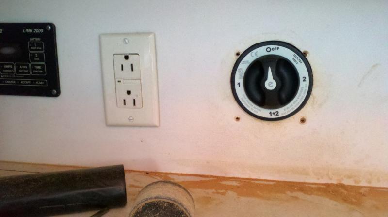

Then I was able to use a drum sander on the drill to enlarge the original battery switch hole. The new Blue Sea switch then inserts from the back.

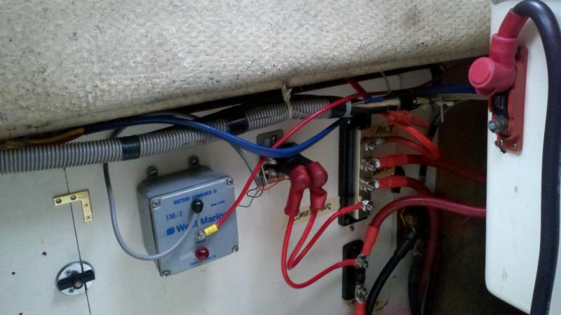

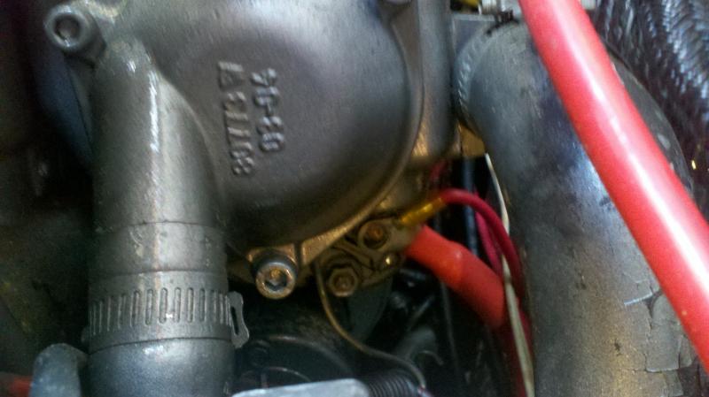

Maine Sail, just one thick lug from GenuineDealz on the 1/0 cable. Then three very thin lugs, one to the Balmar for exciter and two to the panel. Some years ago I ran a second panel #12 instead of trying to replace the original with something heavier.
That starter post is in an impossible place to work. I got the nut off by using two extensions on my socket wrench. Just forward of the starter and unseen is the engine mount. There is no access from the top or back. And no way will there be enough threads for the lock washer. Maybe I can use a fiber locknut.

What panel? Are you using the starter lug to feed the DC panel? DC panel shoud ideally come directly of the "C" post of the battery switch or a POS dist buss down stream of the "C" post.. The starter post is not intended to be a dist buss..
The Balmar does not need to be there either as if this is your "ON" for the reg it will be on any time your battery switch is on. The "ON" for the regulator should be key switched by the ignition... I am not clear as to what you mean by "excite" what color Balmar wire is this??

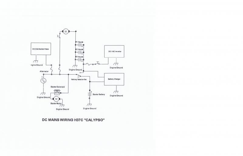

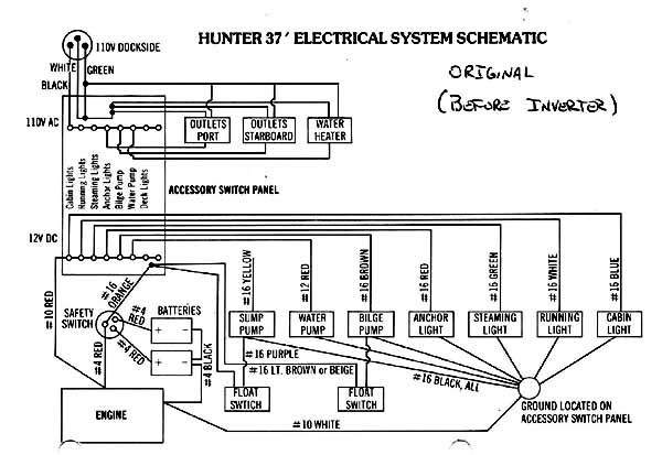

All the Cherubinis were wired this way Maine Sail. Common from battery switch to starter post. Alternator to the same starter post. DC #12 wire from that same post to electrical panel. If it weren't so late I could reference a schematic here on SBO. In the picture of the back of the Balmar it is a wire from the top post spliced into the Yanmar cable. The bottom post is where I removed the wire to the starter and installed the #4 that you see there. Goes directly to the bus bar.
1,090
Quite right Ed, as the original schematic drawing you uploaded to the Boat Info section here on HOW shows - the engine starter was a sort of "+ DC distribution point" as originally wired. This was kind of an 'automotive' design philosophy that was common on boats back then.
When I rewired my boat, I ran a dedicated #6 AWG (or was it #8?...can't remember!) wire from the DC ditribution panel at the nav station to an 80 A fuse block located right beside the battery selector switch. For the 1750 W inverter, I took a #2 AWG feeder from a fuse next to the relocated battery bank under the cabin sole. All my heavy wiring (I used #2 AWG) is fused except the runs from the batteries to the battery switch and from the battery switch to the starter. That was correct according to ABYC recommended practice at the time. I am now planning to put fuses next to the batteries, as you did in your new design.
Interestingly, all the big DC negative wires still go back to the engine block. I had to install a longer bolt after I put in the inverter and the windlass

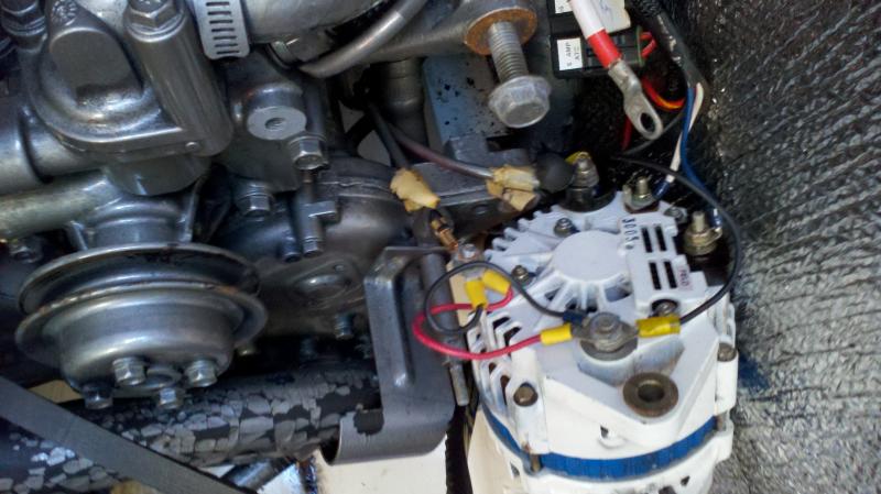

Maine Sail, about that Balmar. You are right of course, there is no exciter voltage. You asked how many wires. In the picture of the Balmar there are two gray cables with old tape on them. One is the 12v to the starter, the other a ground. They go into a harness. Where the 12v wire comes out of the harness at the starter there are two thin lugs. They were both on the starter post along with the #4 and the two #10s to the panel. I thought that second lug was from the second gray cable. Obviously not or I would have been tying the 12v to case ground on the alternator. So not having a good Yanmar diagram I am in the dark about that lug.
Jim, that is much better solution. It is a pain that the starter, alternator, and electrical panel are on port with the batteries and battery switch on starboard. I never saw a real problem with the orginal setup though. Never had a problem until I decided it would be better to have the alternator tied directly to the 12v bus bar. I had added the second 12v #10(not #12 as previously guessed at) when I still had the 2QM20. I guess I should have just left the original wire and ran one heavier wire. But the wire lugs for the alternator and those two #10s are very thin. Its just that the 1/0 lugs are so thick. And I did size the various ends for the post/bolt sizes with GenuineDealz.
I am aware of that but can't believe anyone still has it there.. Voltage transients can cause real problems with the DC panel pulling directly off the starter lug. Not to mention that you are at the very end of the voltage drop in the system at the starter lug...
You lost me on why there is a Balmar wire is on the starter lug again..? If you ran the output to the house then there should not be any need to have a Balmar wire on the starter post...

I reviewed my wiring diagrams and now realize what I was looking at. Out of the harness and in the same small cable were two small wires with lugs at the starter post. One was from the alternator, the one removed. The other is the hot wire to the ignition. It just confused me that the two wires were in exactly the same kind of cable seen at the alternator end.

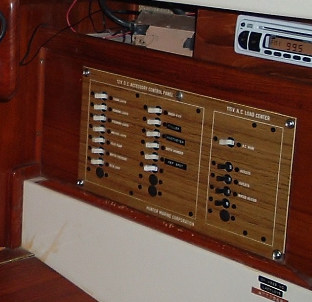

And how do you connect a #6 wire to the small bus on our H37C panels? The screw sizes are very small. I guess I can ask GenuineDealz.
Jun 2, 2004
5,802
I don't recognize that Jim. There is nothing that neat on my boat. :)
So there must be a way to get a reasonably sized lug on that huge wire. You wrote "main breaker" though. My panel does not have a 12 volt main. Rather it has two bus bars common to all the 12v breakers. . . . I think.

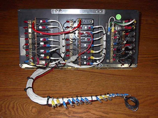

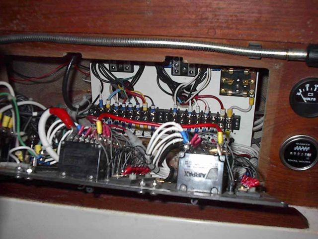

I guess that's another difference to enter in the database. My switchboard was/is 3 separate black "Bass" brand panels (which I joned together on a common hinge). The AC circuits are on the left on my boat and the top breaker in the middle row is the 'master breaker' for the rest of the DC circuits. Originally there were 4 or 5 blanks on the lower end of the right hand panel, including, I think, a fuse holder for the extra brown wire to the bilge pump. I added extra circuit breakers. Anyway, I reckon you can source a #6 AWG lug that will fit a busbar screw - I think I used a Blue Seas lug.
BTW, if I were installing a hinge on the switchboard today, I would do it the way Phillipe (Mathurin II) did on his boat (see attached photo) - much easier access!

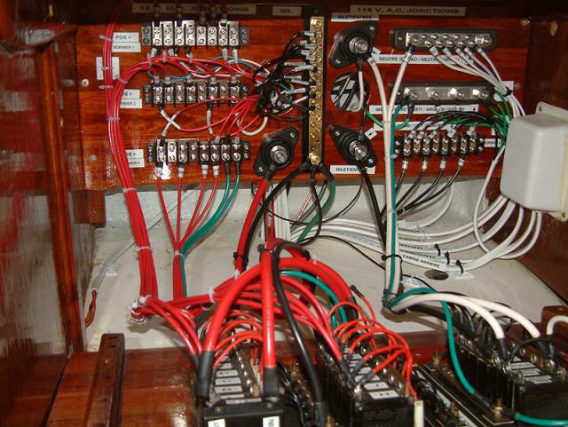

You would be amazed what you can do with 6GA wire.. Re-built this panel for a customer over the weekend and the only thing that will remain, when done, will be the physical panel board. Note the 6GA wire feeding the three rows of new circuit breakers... This is rather precise work but it can be done. The factory wiring from "C" post to buss bars was 10GA and there was some pretty bad voltage drop.
Jun 2, 2004
5,802
Great pictures guys, more than worth a thousand words. I was in awe of Jim's panel work when I first saw it, still am. Although it looks like the AC is on the right in the picture. Your photo shows exactly what I am up against Maine Sail. Including the little jumper between the two banks. And I assume I should have a fuse on my 12-foot #6 somewhere close to the battery switch.
