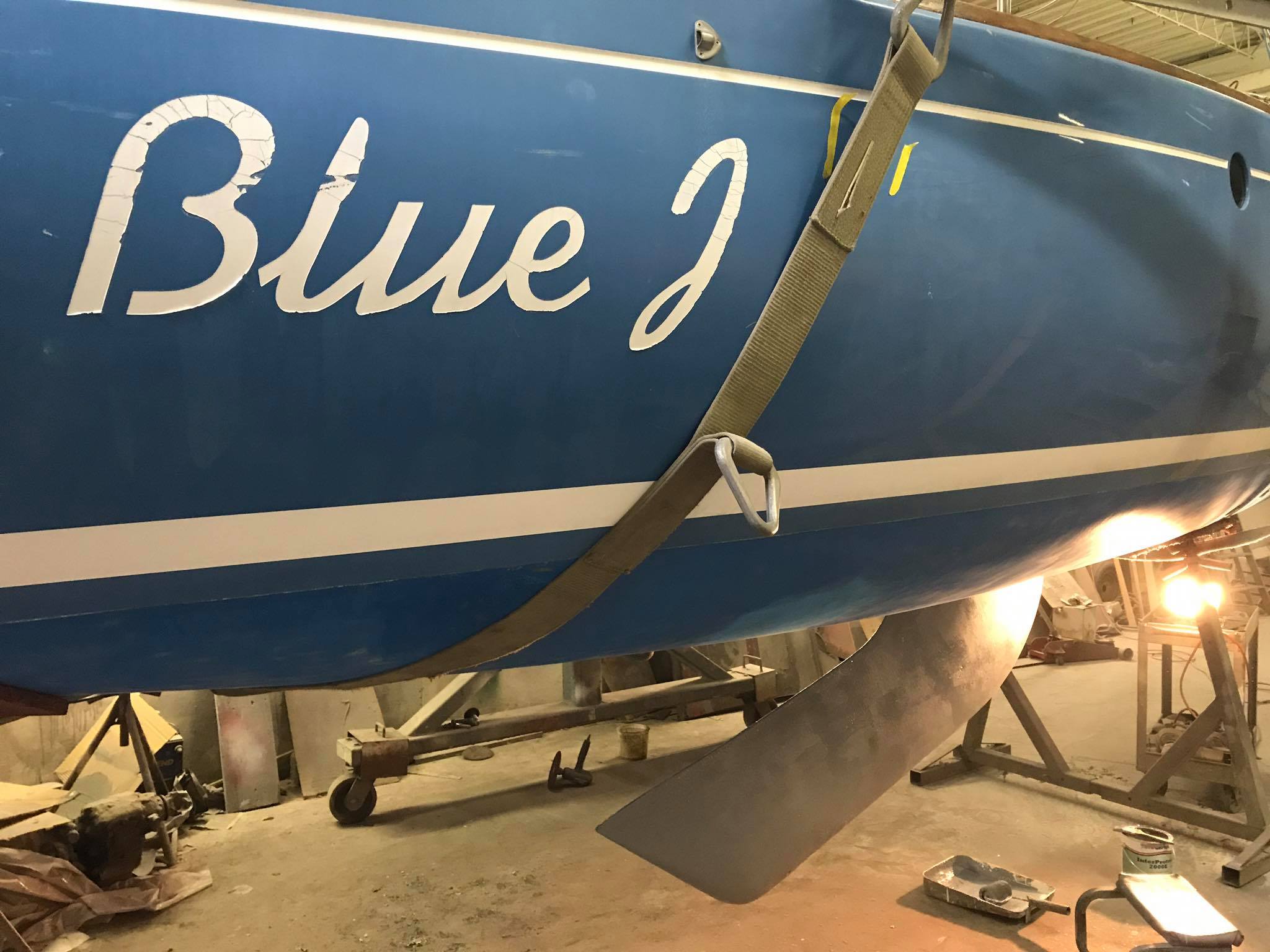

While getting BlueJ's bottom done, I got to see how much her Gelcoat had faded. The picture shows the original color on her bottom after the soda blasting.
So here is the question. While I would like to have that darker blue topsides, its not a HUGE deal for me. AKA I'm not going to spend a ton or time and money on that; I want to get her in the water and spend money making her faster. SO..... is there a quick and kinda easy way to get most or some of the dark blue back? Is it possible?? I'm OK if it takes two people (crew!) a day.
What say you??

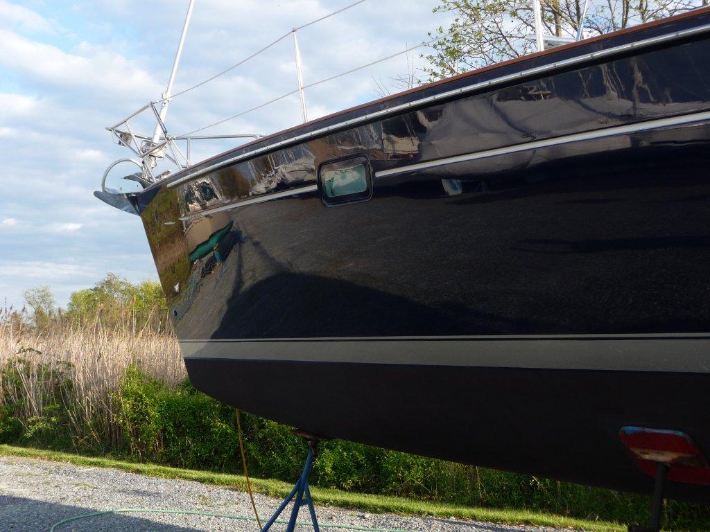

You need new decals, too. :) Wet sanding with 1200 - 1600 grit can be as time consuming as you let it be. I would probably start with a once over by hand but not spend more than an hour for the boat. Compounding with the Makita set-up that Gunni suggests will go a long way toward bringing the color back. Compound / Polish / wax is a quick fix with good results. What better way to spend a day? I've got to fit time in for that myself this spring, somewhere along the way.

It is not that bad, I second Gunni's approach. I spent 14 hours with a dual action Porter Cable polisher and a tub of Buff magic, topped off with a coat of McGuires. Boat looks 1000 times better than it did. I was not going after a high gloss finish, she's 41 and it's the original gel coat.

I would suggest taking photos of the boat name and exact measurements so you can have them re-made. You'll find darker gelcoat under the removed letters. Better yet, if you can re-order from the original source if they still have the dwg file, perfect fit. No shadow of letters sticking out like a sore thumb.

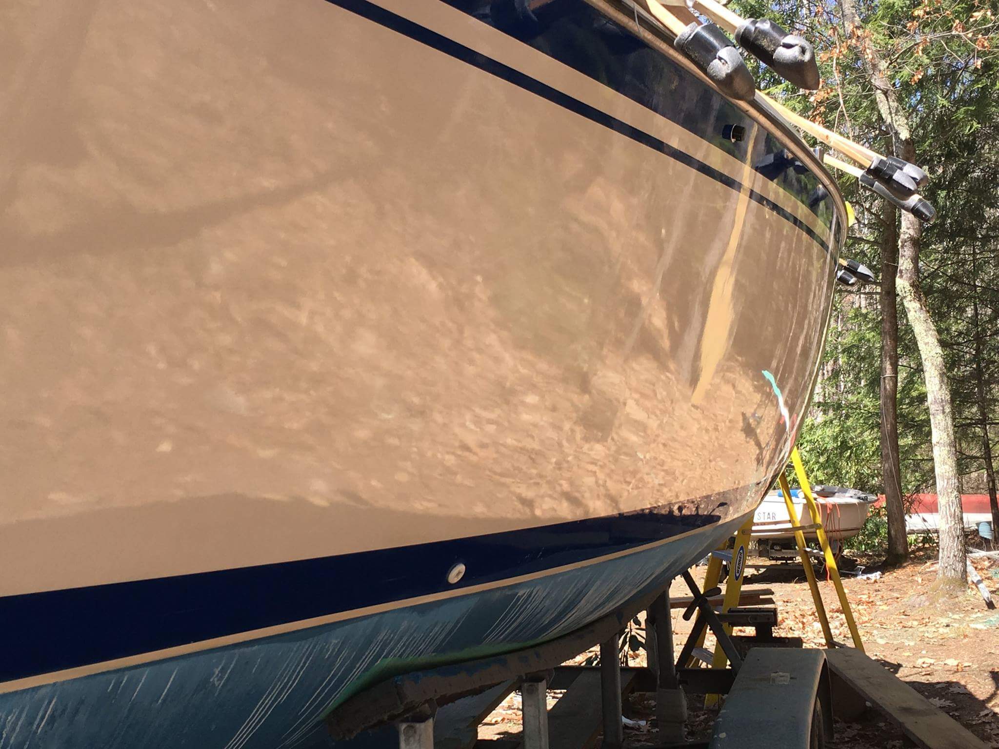

Nothing says spring commissioning like a good spit-shine. This is BEFORE wax, and that is flag blue gelcoat:
