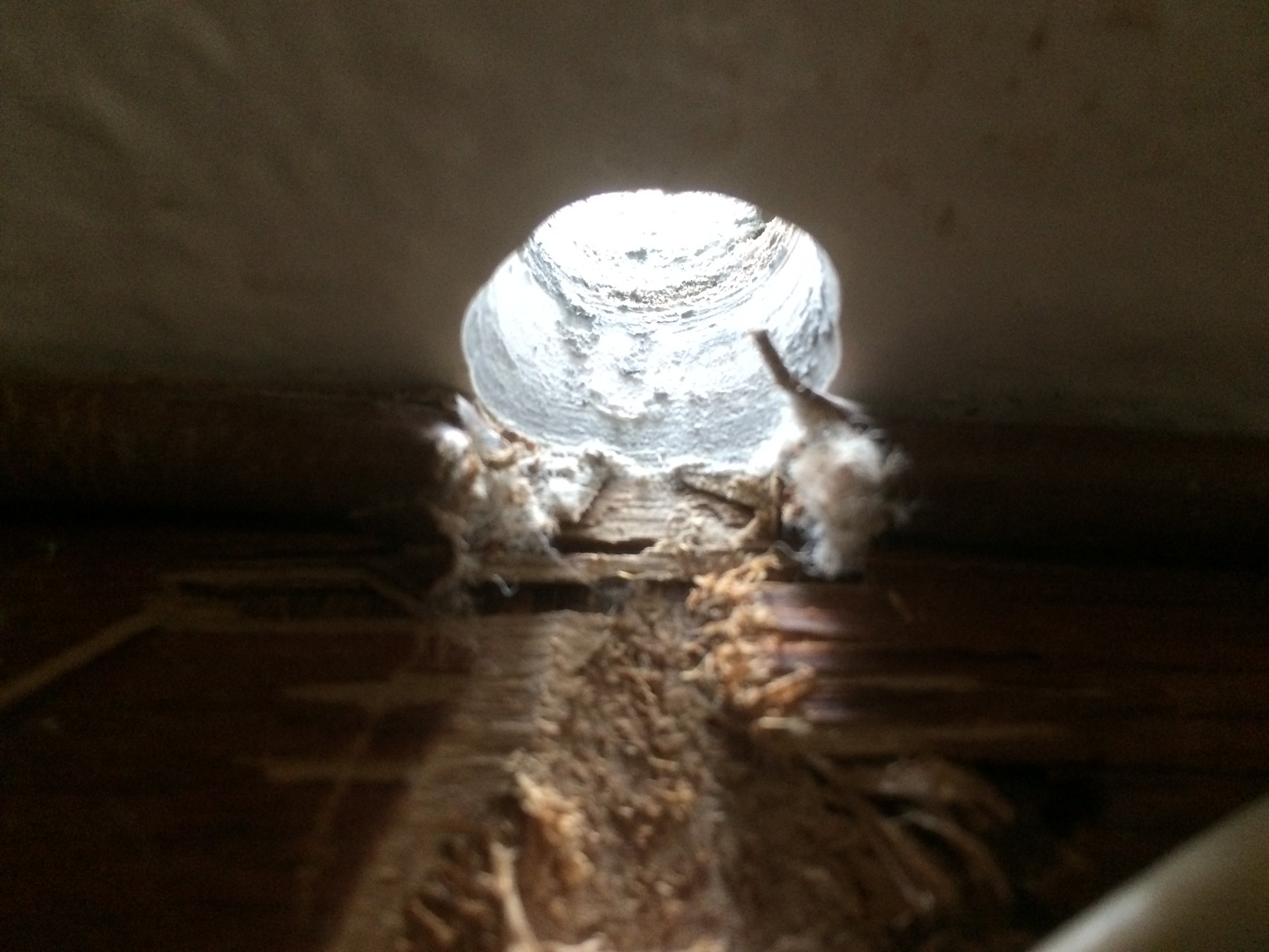

For those that are interested, this is a pic of a 1/2" hole as viewed from inside the cabin next to the compression post on a h27.
It appears the glass is 1/2" - 3/4" thick in the area under the t-shaped platform. Above the glass is an 1/8" aluminum plate and a thin wood core above that.
