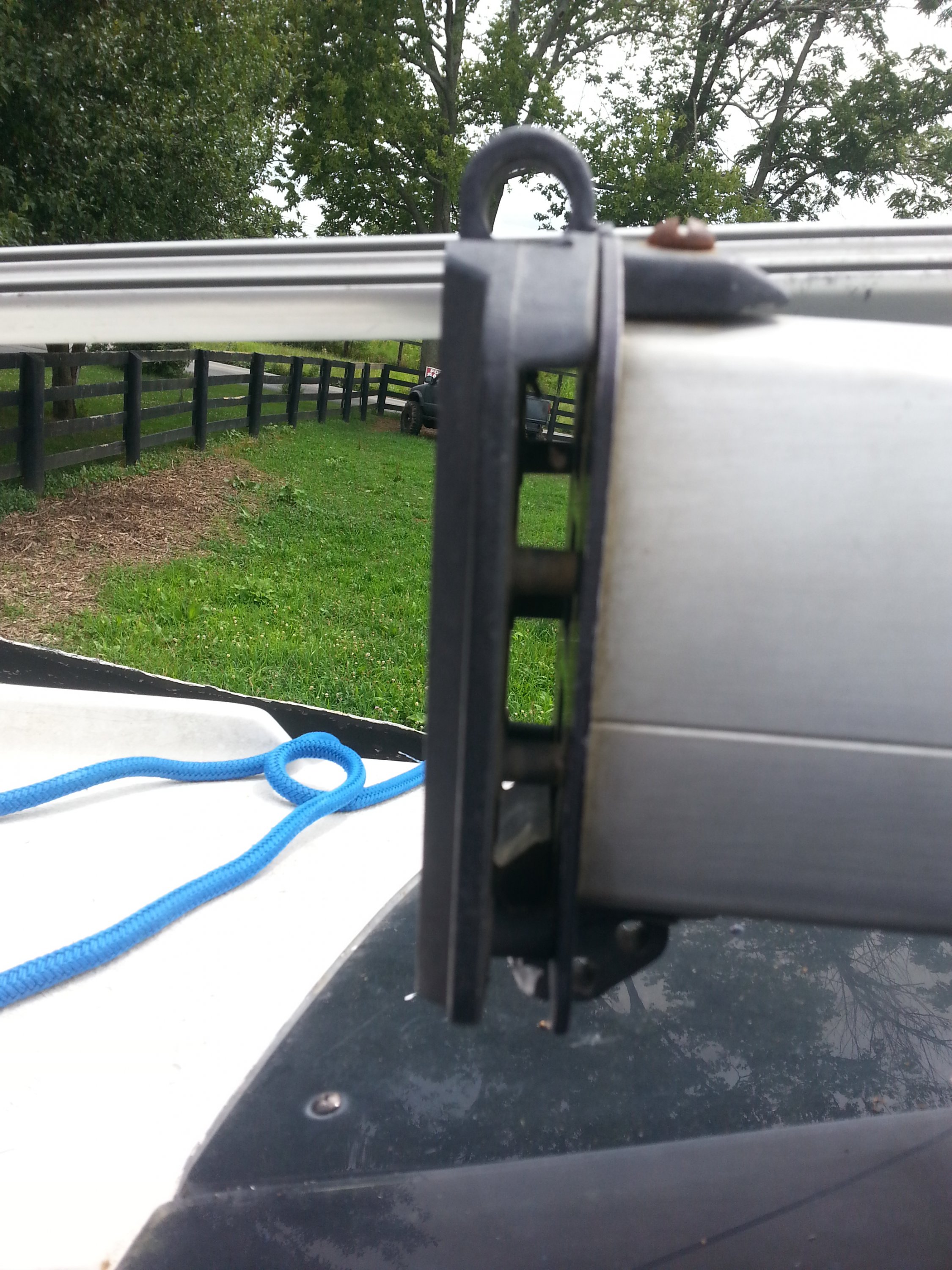

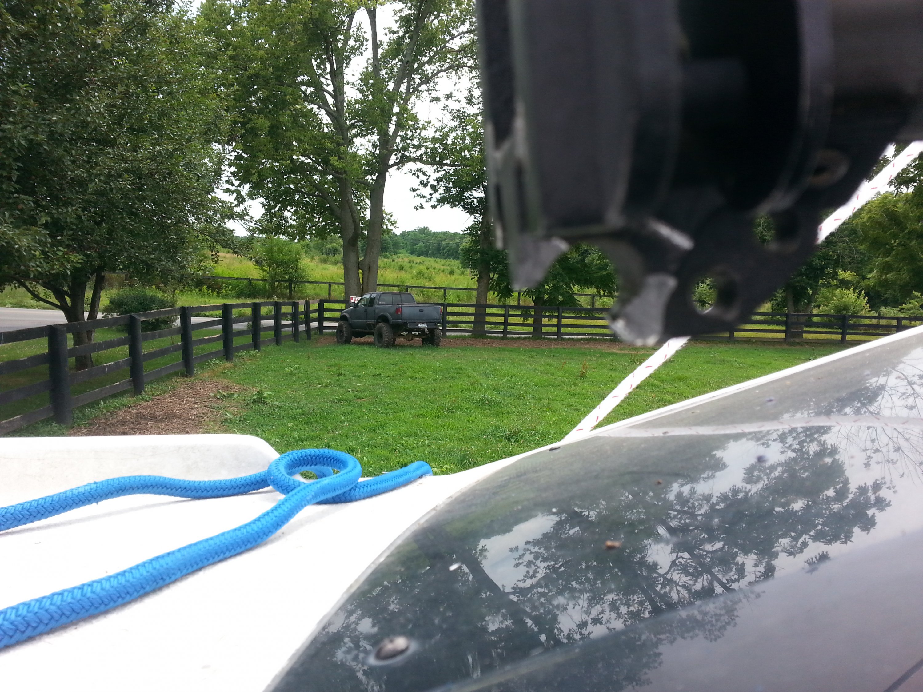

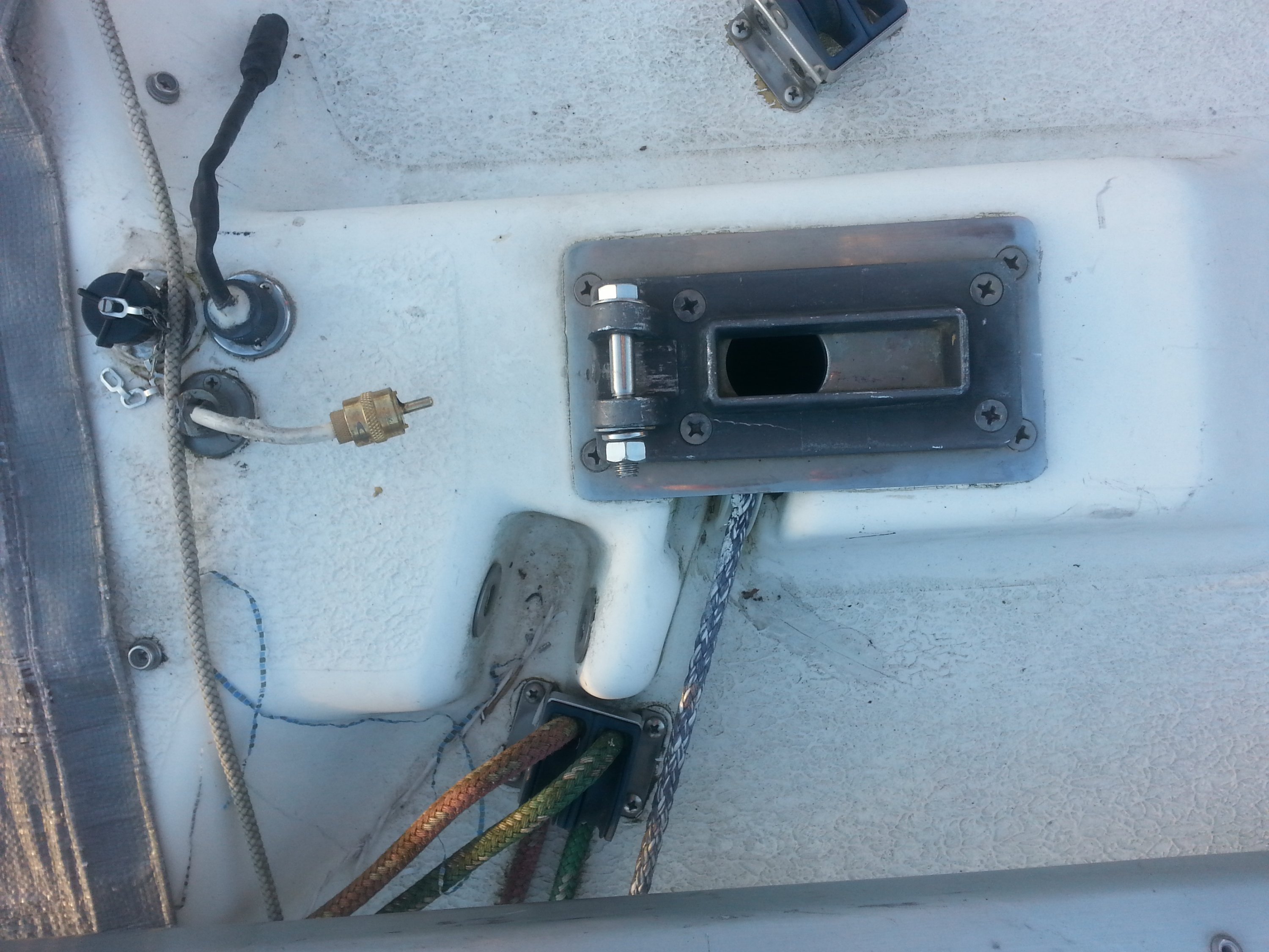

Dang, I broke the hinge (flange) off at the bottom-mast plate through which you place the pin that attaches the mast to the plate on the deck (you might call this plate on the deck a tabernacle, but it is just really a plate with two flanges sticking up that have holes to match the hole in the mast-base plate). Photos below. I've look in owners manuals, and search the internet for help without success. Questions: (1) what is the technical term for the mast-base plate, (2) where can I get a replacement mast-base plate, (3) the old plate is secured to the base of the mast with 2 screws in the front (which I have NOT been able to turn with even the largest screw driver to take them out), and on the back side by 4 rivets through a flange on the mast-base plate that is used to attach the vang to the base of the mast. I assume I can drill the four rivets out on the backside, but how do I get the screws out of the front portion of the plate without damaging the mast (i.e. widening the holes in the mast) so that new screws with new mast bottom plate will be secure in the mast, and (4) any suggestions as to how to go about this entire procedure. Hard to express how depressing this is as I had just set up my rigging for A-spin with help from this forum and hoping to get the boat back in the water after two years on the hard.

Try PB Blaster brand penetrant spray on the screws, let it soak like overnight, tap the screws to get some vibration, repeat as needed. Just might loosen them.

We stock the old Z-Spar mast foot/base/pin for the trailerables, and I hate to say it, but the one in the photo isn't a Z-Spar part. I would try SparCraft or http://www.rigrite.com to see if they can help. They probably won't know what you need based on your boat model, so check your mast (near the base) for manufacturer name and model number. That will help.

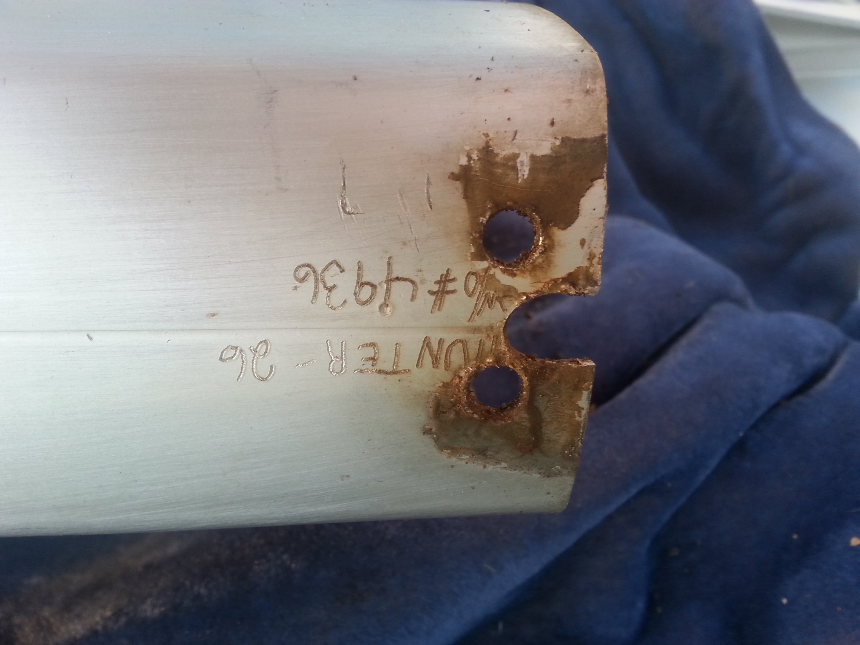

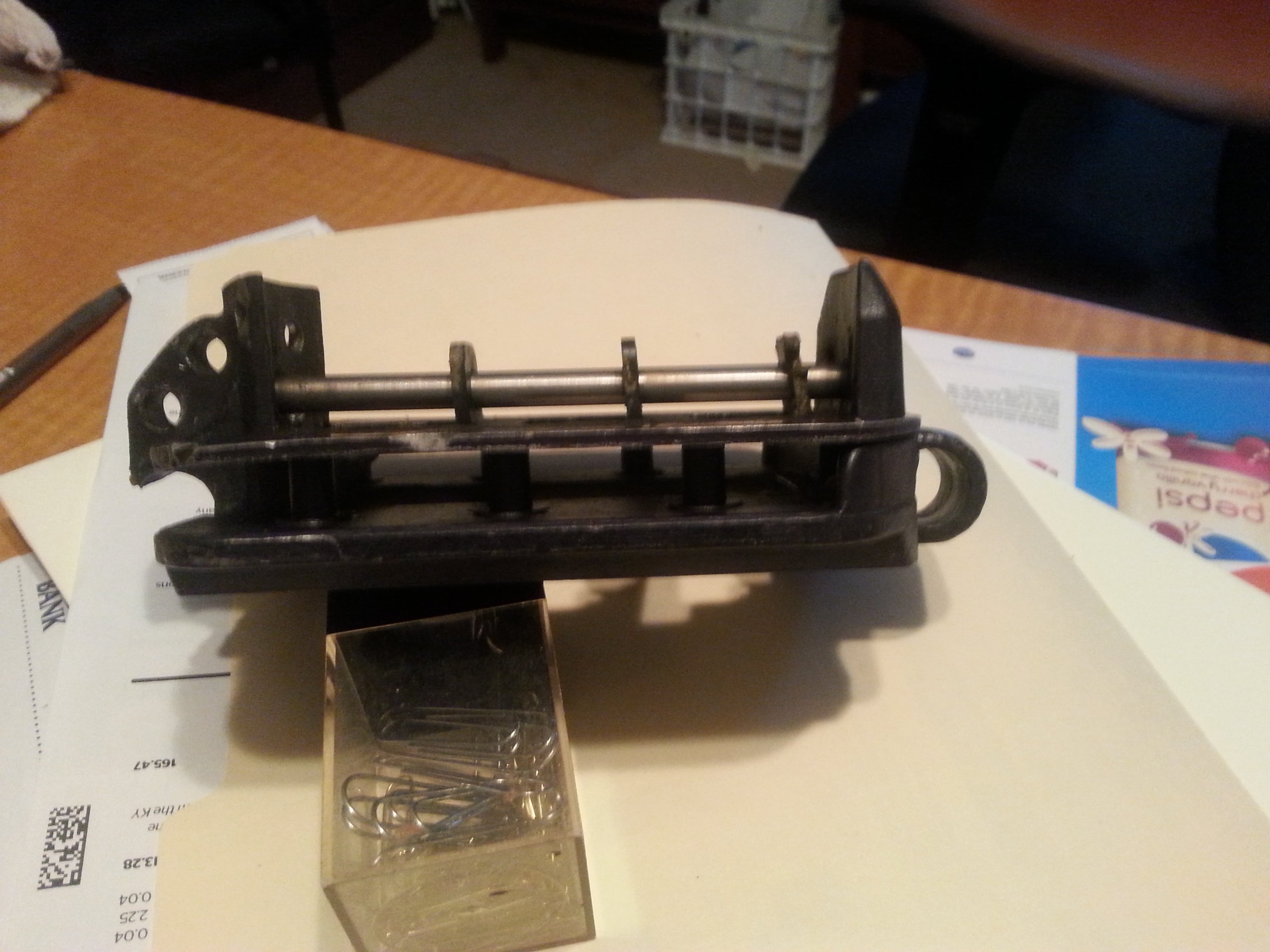

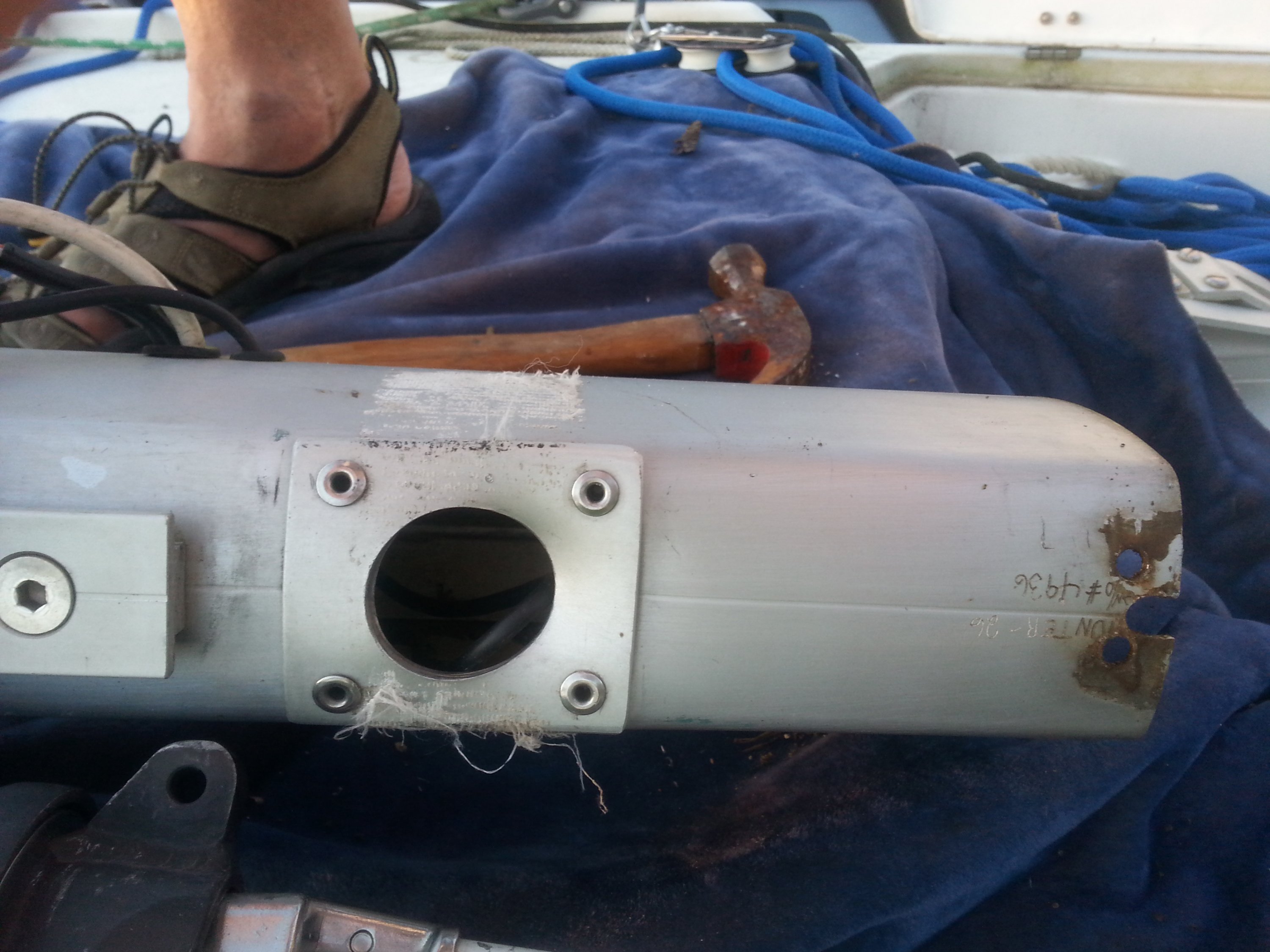

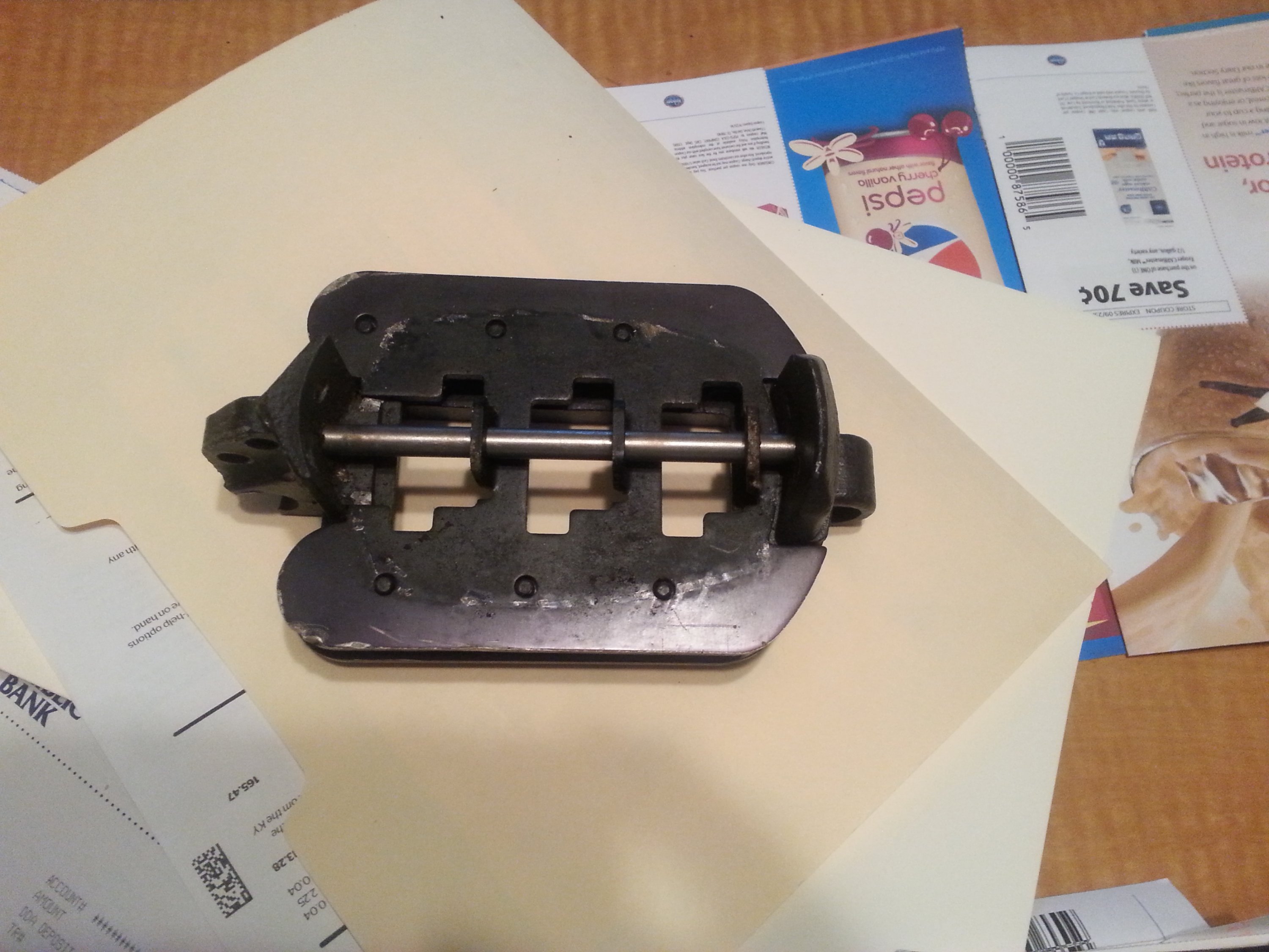

UPDATE: Thanks for all the advise. In the 95-degree day I was able to get the mast foot off the mast using PB Blaster and heavy screwdriver with vice grip on handle to unscrew the two bolts in the front, drilled out the two rivets on the back side where the broken flange is located, and removed the center pin within the mast foot (it just slides out). Here are some pictures of the mast foot, the mast with some ID number inscribed on it, and the mast-step plate on the deck of the boat. It is obviously not a Z-spar setup. Will contact Rig Rite and let the forum know what happens.

It's been a long 5 weeks. The correct Mast Foot components are Spar Craft (1) FM1-2CP and (2) FM1-2B. See pictures in post 1 above. Can be found at this URL: http://www.rigrite.com/Spars/Sparcraft_Spars/FM_Masts/FM-0067_mast.html
by scrolling down through all the available parts for the correct spar (mast). The key is to (1) know who made your spar and (2) the specific spar design (a spar manufacturer may make several different designs). RigRite got back to me within 24 hrs. of emailing them pictures and another 24 hrs. to give me a quote after I got their correct email address rigrite@gmx.com
