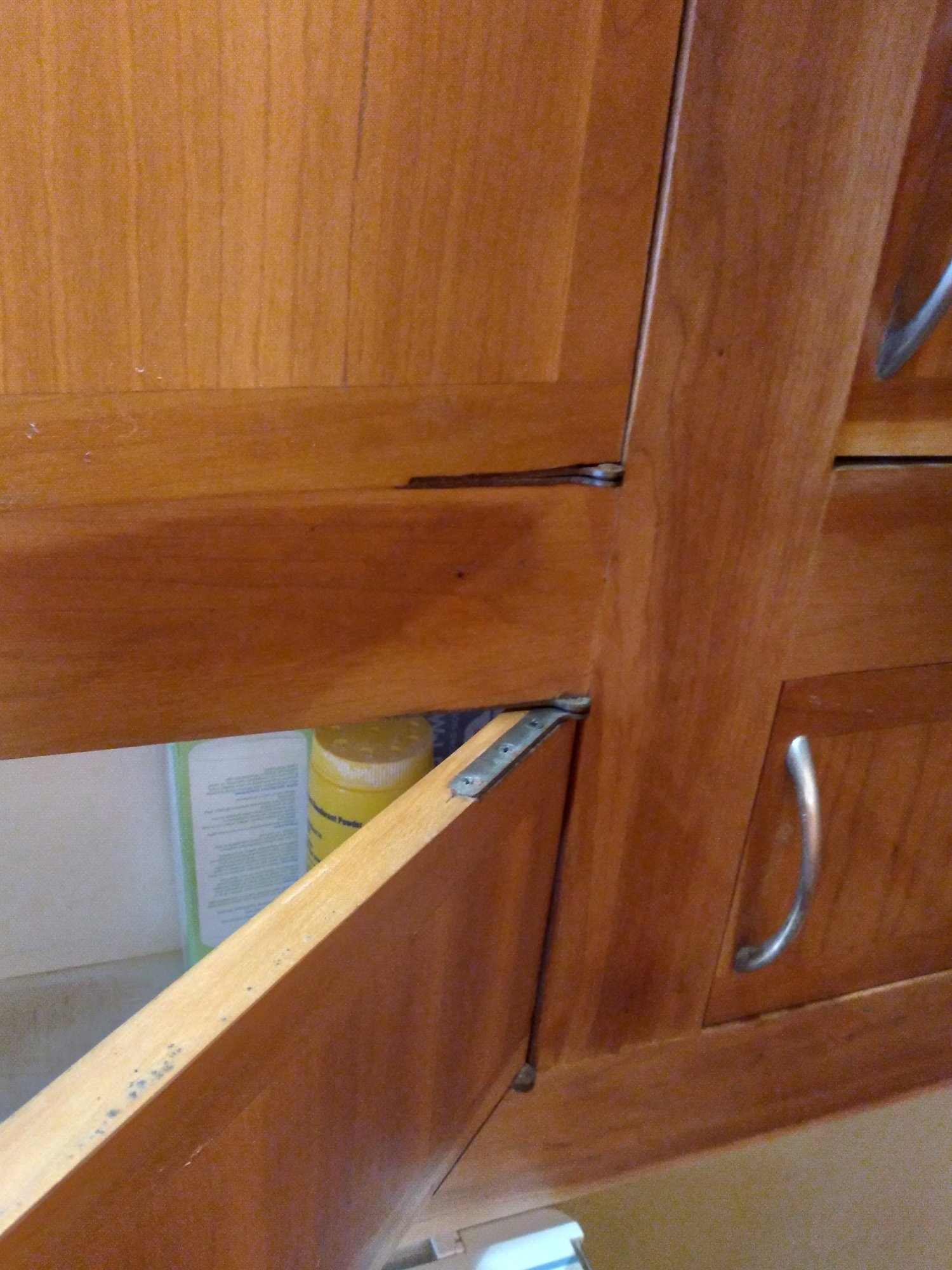

Since this is primarily a boat forum and I started this thread to document boat repairs, how about we do some of that? I have had the odd day or three to knock about on the boat and have done some work - though there might be a fine line between work and piddling around :biggrin:.
I started mounting some of the cabinet doors - mainly to reduce the clutter in the main cabin. After multiple samples of many different types and styles of hinges, where I discovered that most hinges are designed for kitchen cabinets and are not really compatible with boat-style cabinets, I settled on a plan: Clean up the big pile of hinges I already have because they are the best option! My old existing hinges are plain flat stainless hinges and do present a challenge in a hidden-hinge type mounting but I came up with this:
I measured for the hinge location and cut out this section.
The hinges will fit between the door and frame with just the pivot portion of the hinge protruding. I then glued the leftover piece from the frame to the corresponding door:
And voila! Mostly hidden hinges:
I will only be doing this treatment to the visible cabinet doors - some of the locker doors will just get a simple hinge install since they won't be seen. Next, I finished the back corner of the galley and top to the fridge:

Beautiful job Mark.
On our family live aboard, the cabinets used knife hinges. I used them on my bathroom medicine cabinets.
You can get sets that sit more inset behind the facing wood too, only the pin visible.
