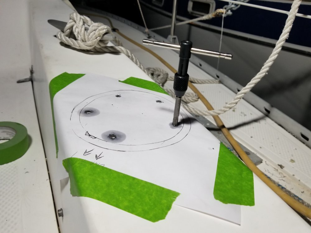

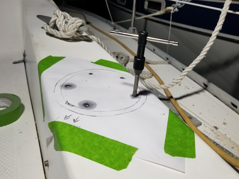

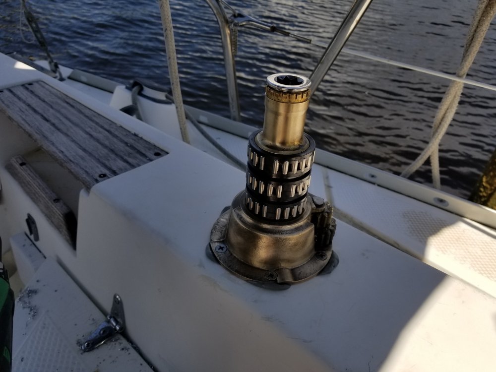

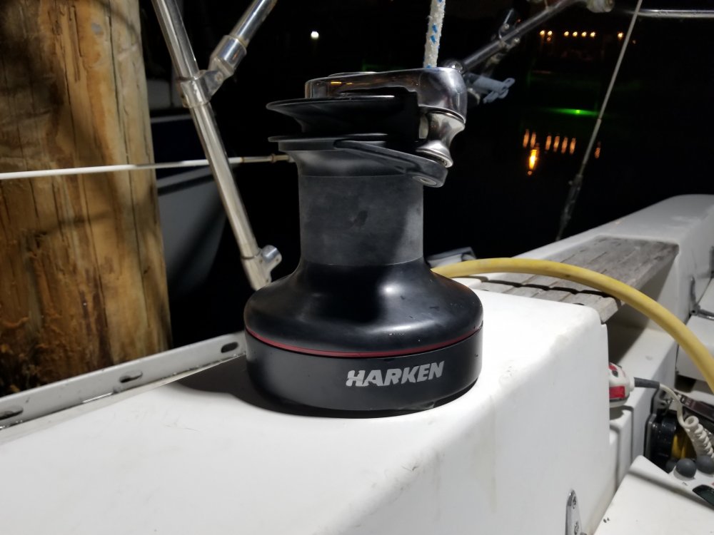

Exactly. After I had the old holes filled, cured, and sanded down I drew a template of the winch base and made a couple of photocopies of it. That allowed my to orient the winch mounting for best fit avoiding the old holes, and getting the winch alignment correct. Thank you for the Anderson Instructions. I took their advise, and placed the gears that contact the winch drum directly behind the loaded face. You can see in my template drawing, how I indicated which way the gear faced. Then once the templates were placed I slowly drilled the new holes so as not to penetrate the inner liner but to be long enough for the screws. I then hand tapped them at 1/4-20 As you can see in the picture below. The Hunter provided metal plate in the deck was actually pretty thick.
Once all the holes were tapped, I filled them with anti-oxidant to prevent seizing, and cleaned up all of the mess (fiberglass, aluminum shavings, and cutting oil) where the winches were going. I then made doughnuts of Bed-It Butyl tape around each of the new mounting holes, and placed the winch bases and torqued tight. I waited a little bit for them to settle , and the re-torqued. They are tight and sealed

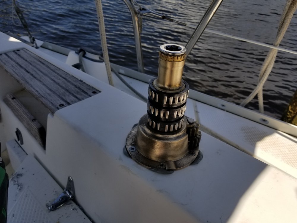

I then greased the final outer bearings, and drum gear, and placed the drums making sure to align the self tailing arms to strip the line back into the cockpit.

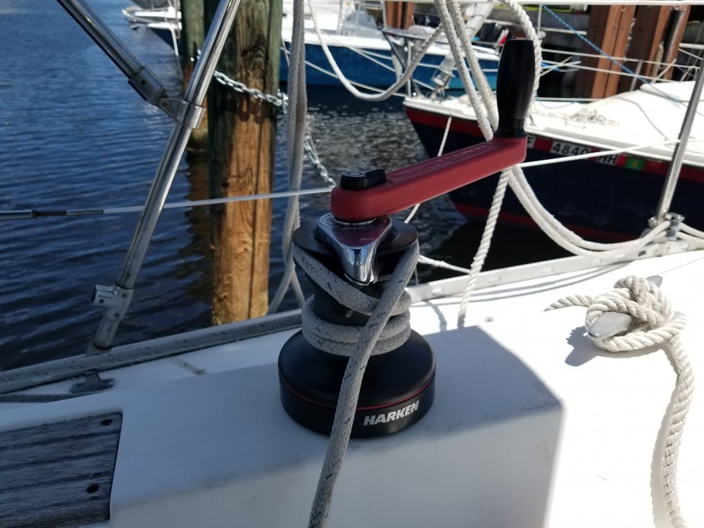

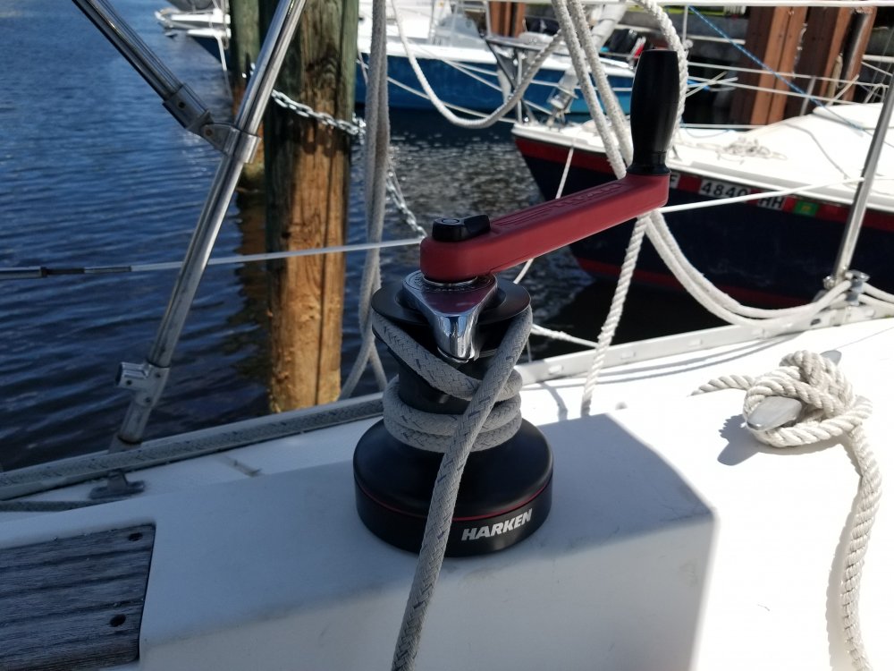

I am more than happy with how they turned out. They are not new, but they are a crap-ton better than what I had, and can't wait to sail with them at Wednesday nights beercan races.
Thanks everyone for all of the advise.:biggrin::biggrin::biggrin:
ps, The old bronze Barlow 28s sold on Friday and are shipping out today, so some of the cost of the new winches has been offset.

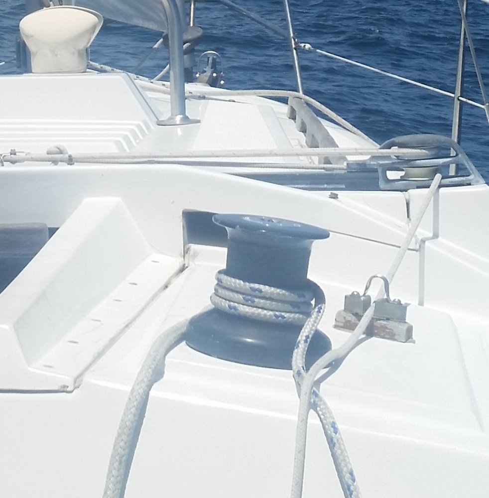

I did not mount the Lewmar 16ST winches on the cabin top yet. After taking them to the boat to check fitment, they are smaller than the Barlow 20s that I currently have there, and I am not sure how well they will work for raising the sails. Anyone have any experience with these?

Believe the Lewmar 16ST is a single speed winch. I would want a two speed winch for my halyards. A Lewmar 40 would be my minimum, and have upgraded 44ST’s mounted on the cabin. You won’t regret having a bigger winch.

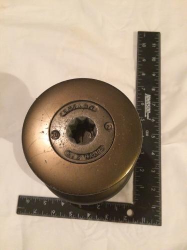

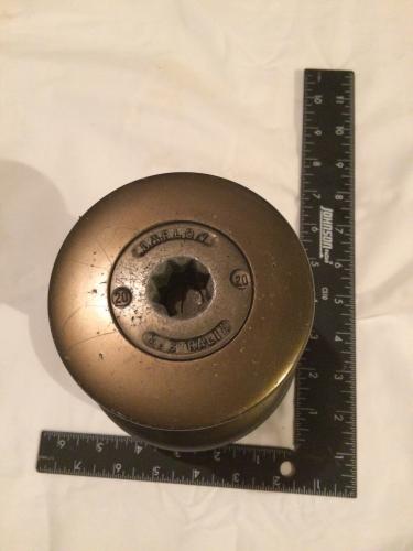

Current winches are Barlow 20s also single speed.
Barlow #20 Aluminum Winch
Height - 4 5/8"
Base - 5 1/4"
6 Bolt Pattern

16STs work well for raising my main up my 45' mast on my C30 Tall Rig. Actually, I raise it by hand to about the last 5', then finish with winch. You having a Hunter 31, might be similar.
Jib is a bit tougher but that's only once a year.

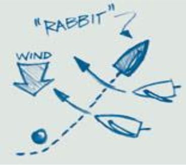

LOL, race hadn't started yet. Since moving our dock location, we actually managed to get out a little early. We had just put up the sails, and were waiting for the other boats to make it out to the Atlantic. We use a rabbit start at the local sea buoy so that we have fewer marks to set for these races.
Rabbit Start
Forget about a race committee boat, flags, sound signals, and all that stuff. Just use the “rabbit” system. One boat is designated the rabbit. It sails up to the start mark from the left side (looking to windward) and, after passing below the start mark, steers onto a close-hauled course (i.e., pointing as close to the wind as possible while still sailing) on port tack. The rest of the competitors have to approach from the right, on starboard tack, and sail between the start mark and the stern of the rabbit. That’s it. The rabbit has a slight advantage so, in a series of races, give the last-place finisher in the previous race the rabbit’s job for the next race, as it will give them the best possible start.
