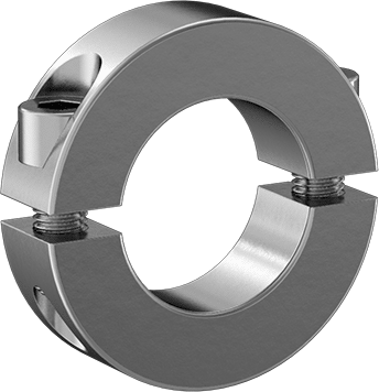

I believe that I was the target of the stop collar suggestion. These are used as a backup to the stainless steel set screws that hold the rotor in position along the shaft when using a PSS Shaft seal. My boat has one, but it is not visible in the picture because of the raw water intake hose.
Also, there is no need for any new through hull when installing a PSS. The black hose in my picture is the vent hose. This hose allows air which will become trapped in the shaft log when the boat is hauled, out of the PSS seal when the boat is splashed. Water lubricates the graphite bearing that should be pressed against the bearing. The end of the hose is left open and it simply goes above the waterline of the boat. Higher is better. I ran mine into the lazerette and ended it just below the lid. I have never seen a drop of water come out from it.
