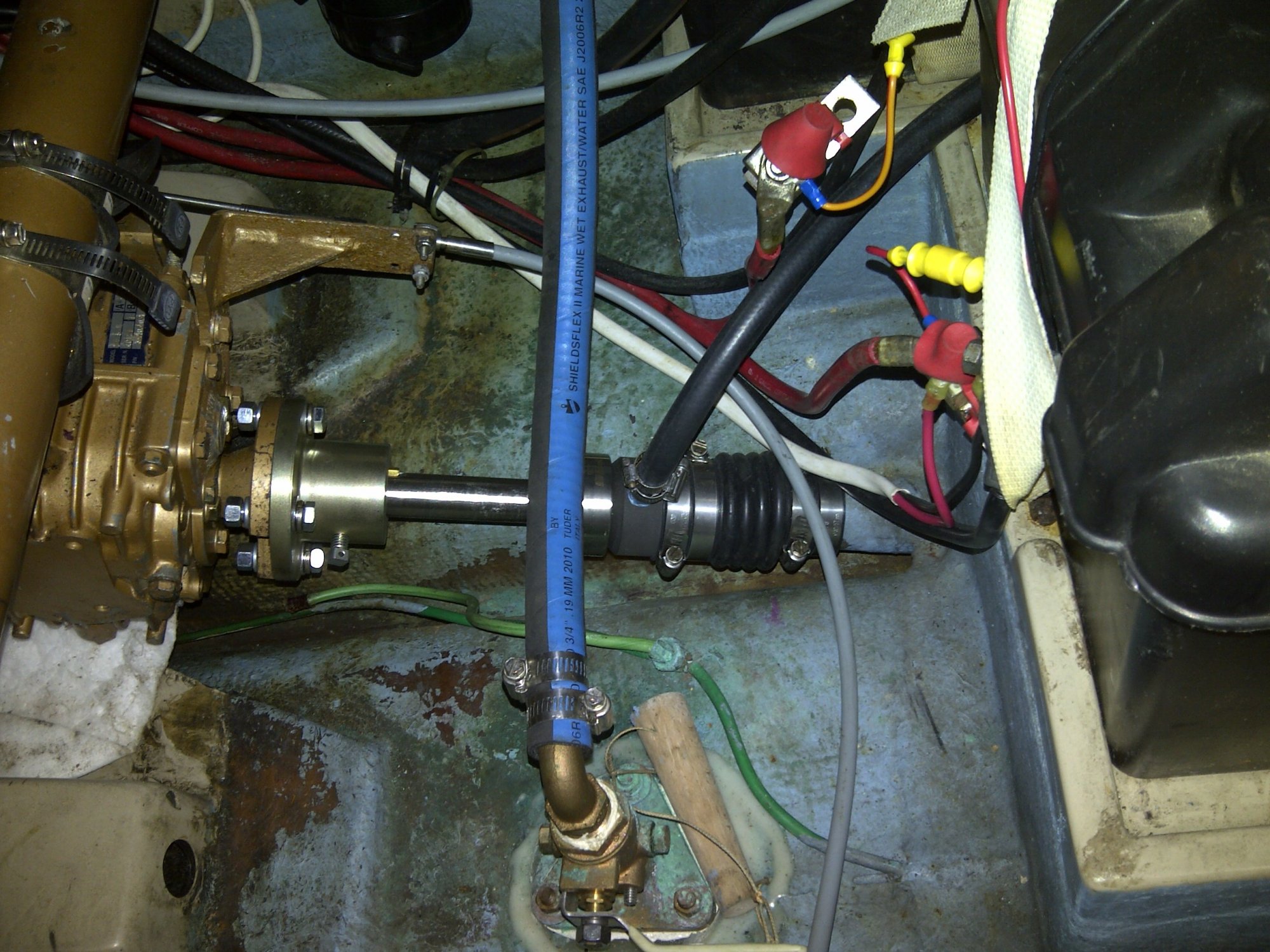

Here is a pic of what the shaft, coupling and PSS shaft seal looked like after I installed them;

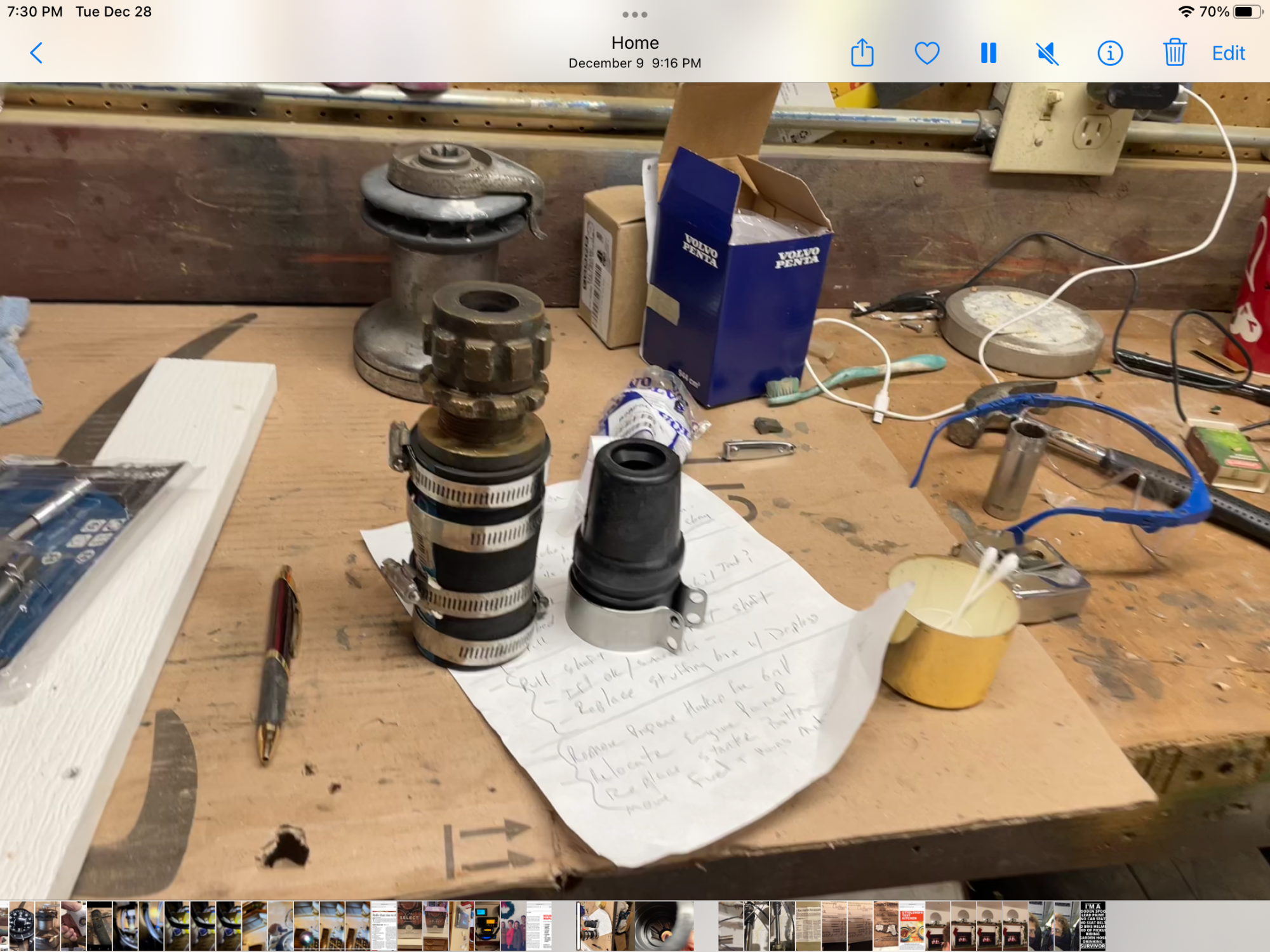

This winter, I pulled the coupling back off, removed the stuffing box, inspected the shaft for wear, and then bought and installed a Volvo Penta dripless shaft seal. Simple, clean design. I hope it works well.
Big difference in the size of the old stuffing box, and the new Volvo…

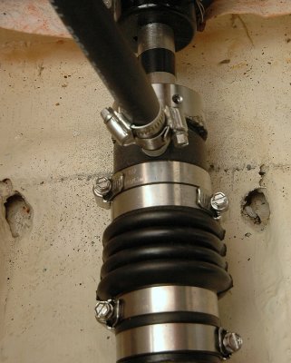

Looks good once installed…

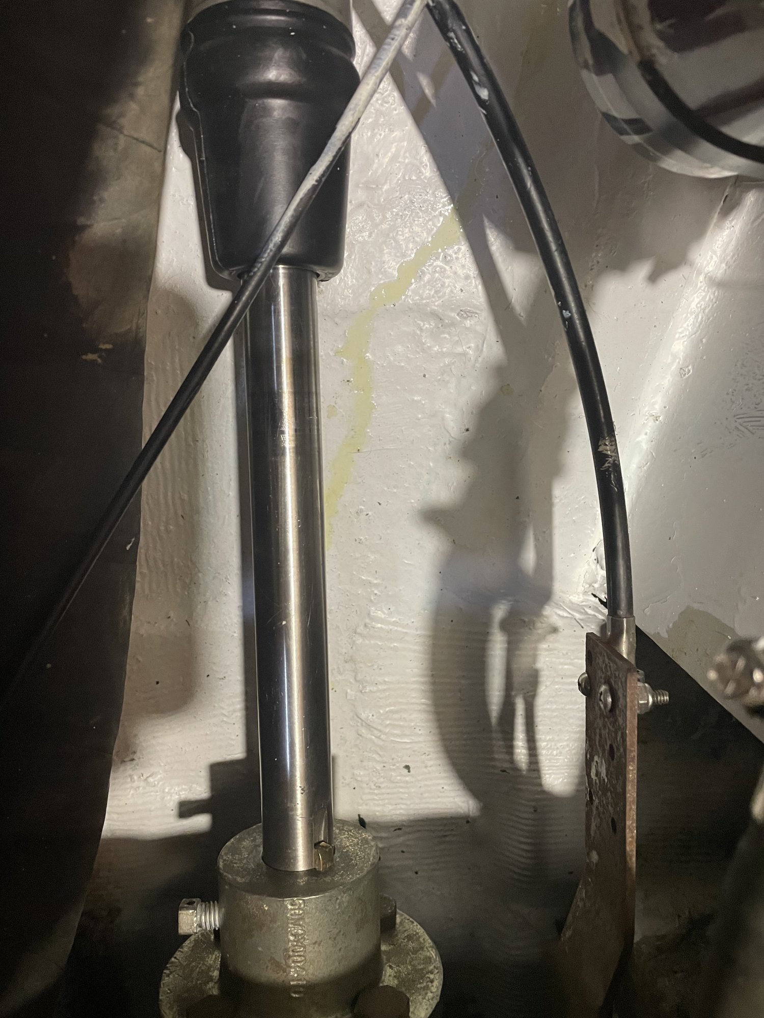

I was able to push my coupling back on…with a little help from a hammer. I tried to put some lanacote on the shaft before pushing them back together…hope it makes removal in the future easier. If not, I will try a split couplin.
