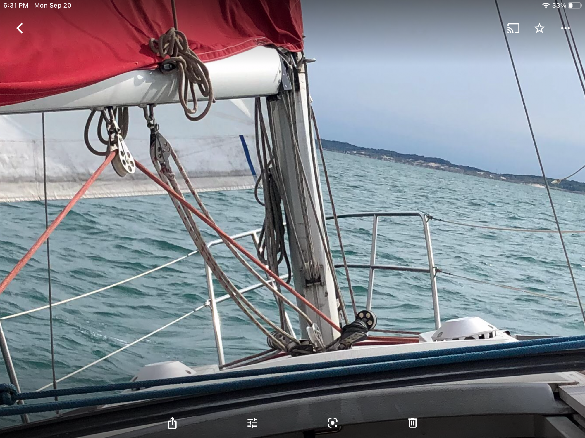

It looks like the blocks don’t swivel with the boom so maybe the line tends to jam if the boom is off to one side, as may be the case while reefing?
They jam when reefing, not when shaking out the reef. The boom position affects the opposite side of the block when shaking out the reed, which has not been a problem.

Are they adding purchase? Might be better to first ascertain why they are there.
They’re there to lead the lines from the tack properly into the boom sheaves. The lines can only enter the boom from below, and so must be run through a block below the boom.

I have those same blocks on my mast, and I think that they are required (or something similar) to reroute the lines as they come down from the tack cringle If you are sing single line reefing. You can’t run them into the boom from above…so they run down to the block, reverse direction and go up into the boom neck.
A couple of blocks at the bottom of the mast way work better if you have room, but I don’t know why the current blocks wouldn’t work.

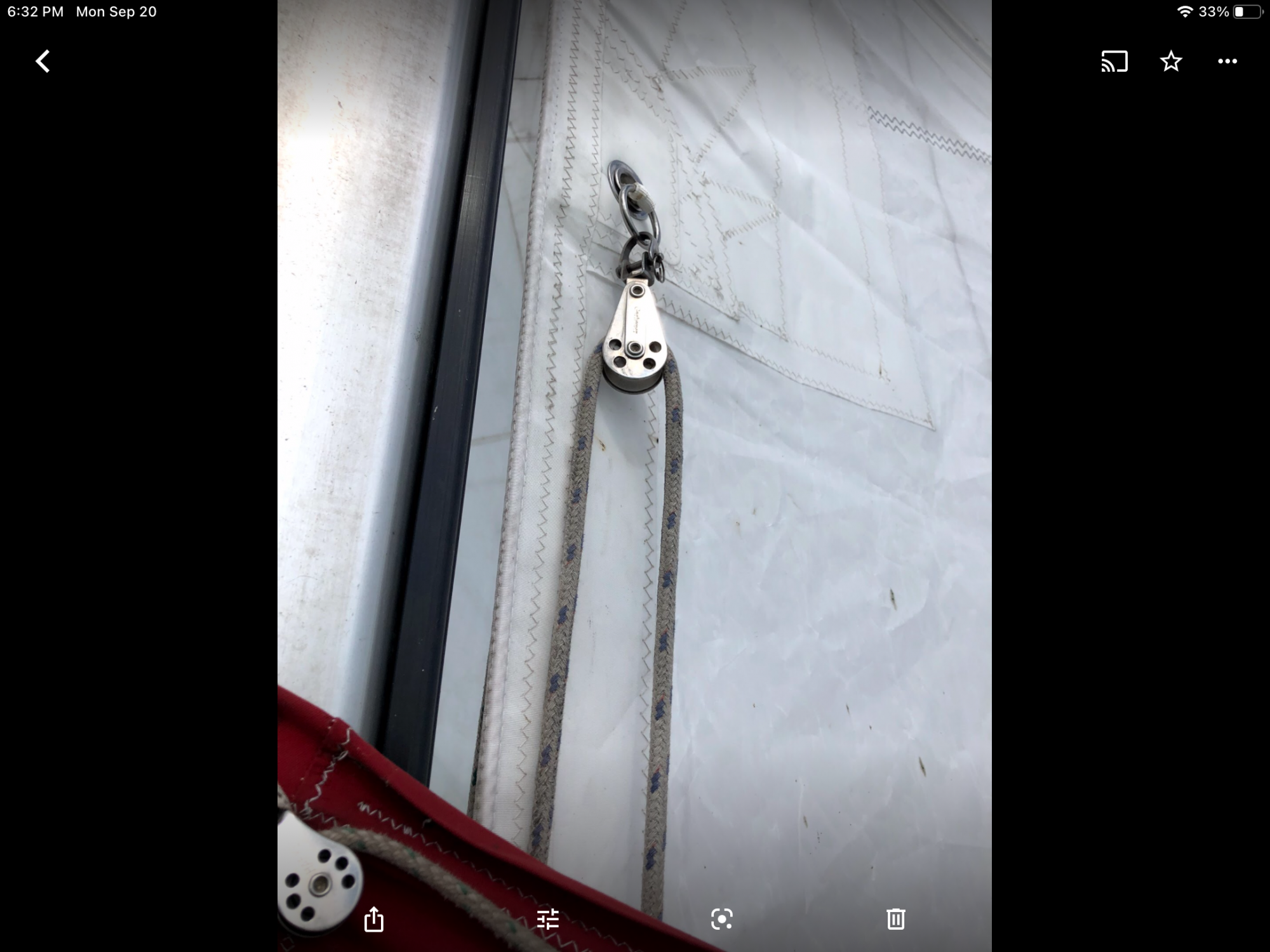

I don’t have a great pic, but this may give you an idea.
On my tack cringe, I put a small block..
I don’t have any blocks in my boom…maybe that is the difference. And why I find using a reef hook at the mast, and a single line running to the back of the sail.

I believe your problem stems from the lines not leading in at the proper angle. You want a fair lead into the block so the line stays on the sheive at all times.
The lines are properly sized (rigging specs call for 3/8”). I will wash these. I would also like to install a fairlead as @capt aj says. The outer edges of the sheaves in the offending block are 1 1/4” apart, which indicates to me that should be the width of the fairlead. I am having trouble finding a fairlead that would work though. It needs to attach to the mast (clearly). I can drill and tap it, or could mount on the track (if such a fairlead exists). Does anyone have any suggestions?

One other comment: You might explore options to replace that very restrictive double block on the mast that seems to be the source of your problem. I'd like to see it in operation before conjuring up a solution. But I'm sure there is a sensible one... after all.. these systems are really pretty basic... keeping it simple should always be the goal. Good luck.

By all means, think outside the box and maybe replace that clunky assembly with fixed sheaths. You don't have to keep or replace in-kind the builder's bad choices. You can make improvements that increase your sailing proficiency! Those fixed blocks mounted so close to the mast look like a bad idea to me. See how easily they pinch the lines? At the very least, you could remove the assembly and fix some sort of spacer (washers or nuts between the mast and the flanges) to provide more room for the lines, but I would favor an option to install blocks that can swivel sufficiently to improve the fairlead angle. Without seeing your entire assembly, we can't possibly know what components are necessary, not necessary, or easily modified. There are countless reefing configurations, so no solution can be universal.

I was just thinking more spacers behind the block might be the simplest solution, but a better block system might be a better choice.
Does anyone have any suggestions for a better double block, possibly with integrated fairleads, that I could install?
Also, I have tried to remove the screw mounts on this fairlead, and they seem potentially seized to the mast. Any recommendations on freeing those up? PB Blaster and an impact driver?
