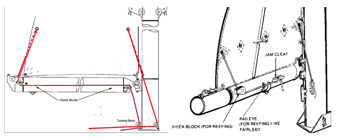

Ouch!! If you reefing line looks like the leftmost diagram below and you can remove the end cap then fish a wire tape with a messenger line attached to it under the end block and over the block nearest to the mast then out, then attach new reef line to the messenger line and pull it through. An alternative is to abandon the internal reefing line and install a cheek block on the boom, then to a cleat on the boom like the rightmost diagram or through a turning block to a cleat on the mast. In case you are having trouble doing that then suggest a rigger retrieve the line.

The diagram on the left that @sail sfbay showed is good, but is a double-line reef, so there are two lines at the base of the mast to pull. If you took the line coming from the the clew through the boom up to the reefing cringle at the mast and back down again, it would make this single-line reefing.
Thanks for posting this diagram on the left! I never liked the way my single-line reefing was rigged. I am going to change to 2-line reefing except the luff line is going to be secured only at the mast, on a cleat that I have looking exactly like the diagram on the right!

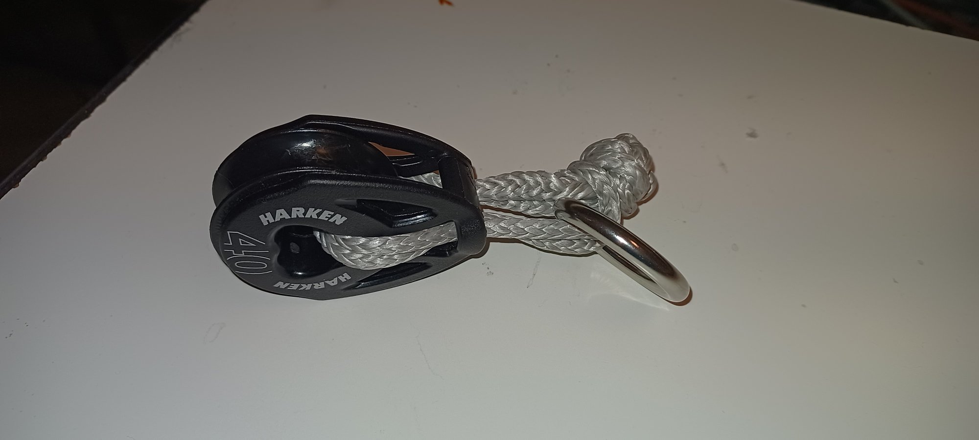

Here is the block I use. It is a 40mm carbo block with a soft shackle to a welded SS ring. Works great. When I first set up my SLR I could not get the clew to come down due to the high friction. adding bearing blocks on both cringles made all of the difference. I also drop my halyard to a premeasured point where the reef tack cringle is about 6" above the boom. This keeps the lead to the tack block fair and free running.
What a great use for a soft shackle. I tied the blocks on following the Harkin instructions. I wasnt tying soft shackles back then but since then I’ve made several so I’ll switch to them over the winter.
