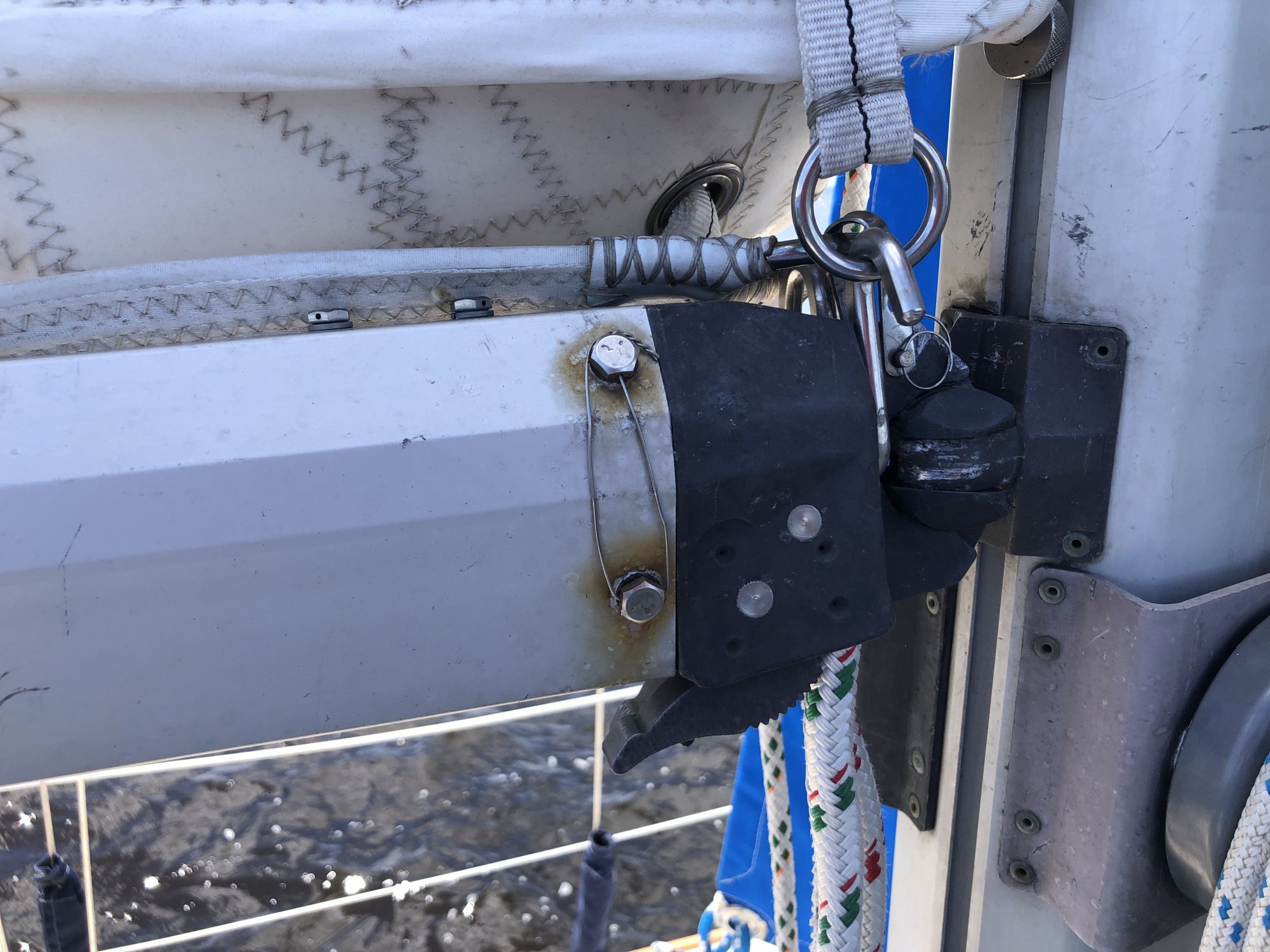

On my O’Day 28 while I was reefing the end of the reef line came loose from the boom and I inadvertently pulled the line threw the reef clew grommet point and into the boom and half-way through the boom. Now I am faced the challenge of rethreading the reef line aft through the boom. Since you cannot push a rope I’m finding this very difficult.
It seems like I will need to disassemble the boom just aft of the connection point to the mast - see photo. By taking out 4 bolts. Then I need some stiff and long (about 12 feet) to push thru the boom and attach the reef line to this long stiff guide-wire until it exits at the aft end of the boom.
Does this make sense or is there a better way to do it?

The gooseneck attachment was originally fastened to the boom with rivets from the factory - a PO has replaced them with bolts and I assume tapped the boom (I did the same to ease future removal - I used pan-head bolts so they don't stick out so much and don't have hard edges). It will make it easier to fish the line through if you remove one of the boom-end fittings but you may be able to do it with them in place. It will be easier if you can remove the boom as well - then you can rotate it so the lines that are in the boom are at the bottom giving you a clear path to fish the new line through. You want to make sure all lines have a straight run and are not wrapped around each other. Placing the boom at an angle (or even vertical if you can) will ease fishing the line through. I had to fish a line through on mine and it was much easier than I expected (not the norm when working on a boat :)).

FWIW, your split ring on the tack fitting is opening up, you want to replace that. I tape these up so they wont open.

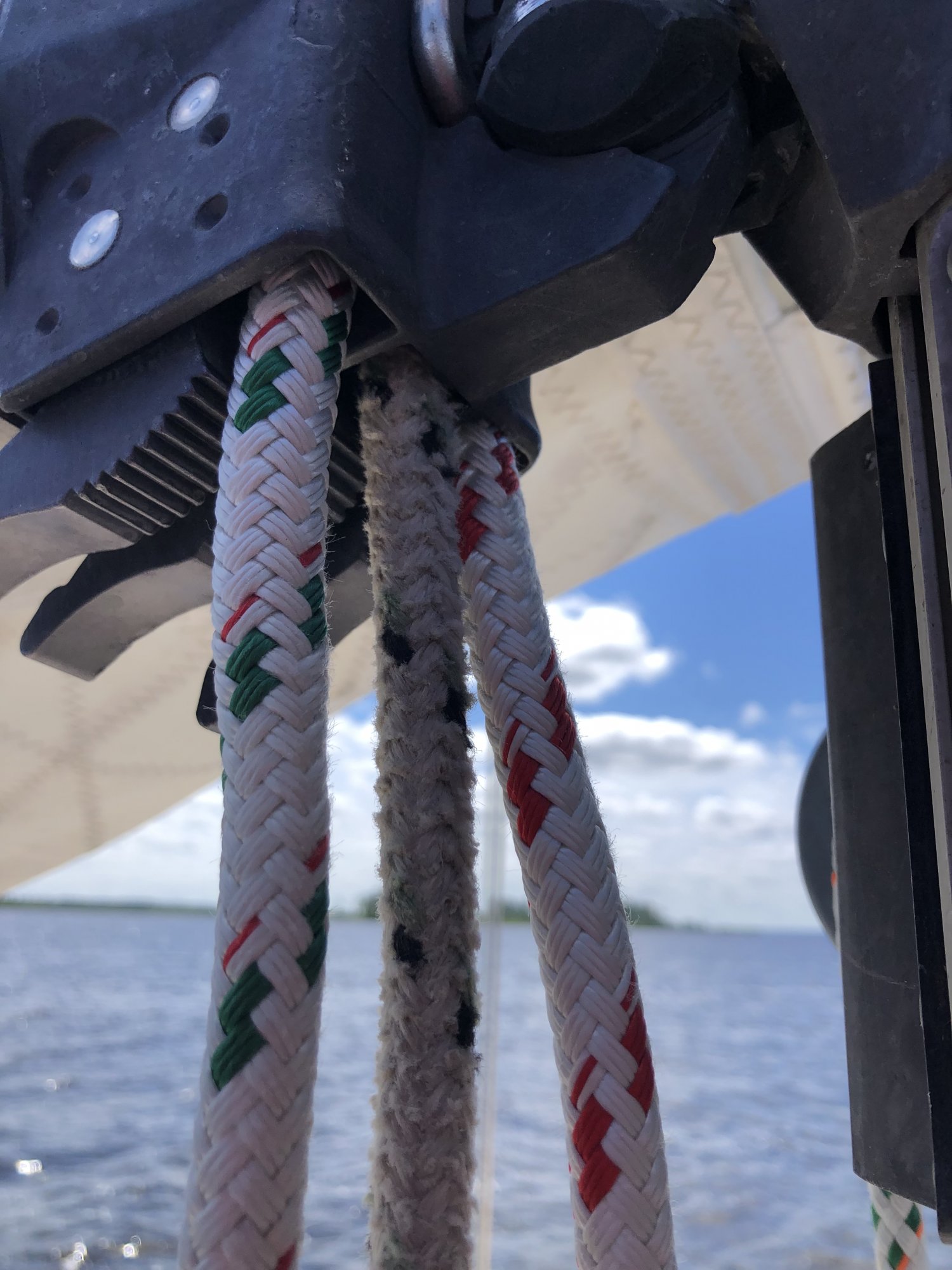

in looking at this photo, I assume you have 2 reef lines and maybe an outhaul (at least I show my O’Day 322 is set up)…
Could you tape the “lost” reef line at this end of the boom to the other reef line, and then pull on the reef line at the other end of the boom? I guess depends on if you have blocks in the boom or not (my O’Day 322 does not) or if there are other things in there to get caught on…

Thought of attaching the 1st reef line to the second and pulling it through as you suggest. Problem is my boom seems to have 2 distinct channels/tracks on - one for each of 2 reef lines and one for the outhaul as you correctly noted. So if I feed the reef line thru the one channel I cannot move it to the other.
